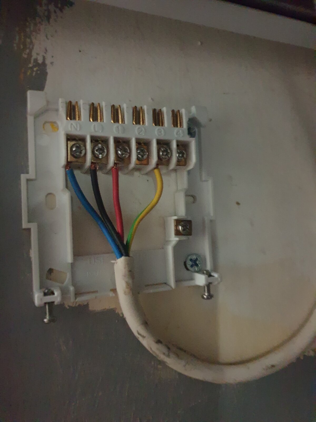

Hello everyone, first time poster.
So I'm in the process of smartifying my house and have picked up one of these cheap Chinese Tuya Thermostats to replace my existing thermostat, I just want a professional opinion before I possibly deny my household of hot water and heating.
So this is my existing set up

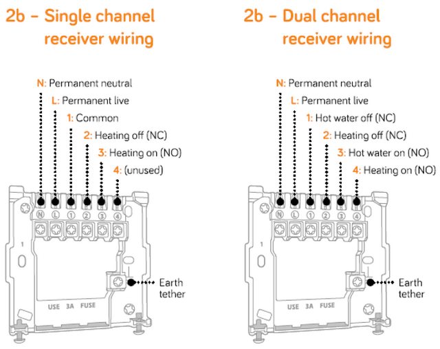

And the wiring diagram

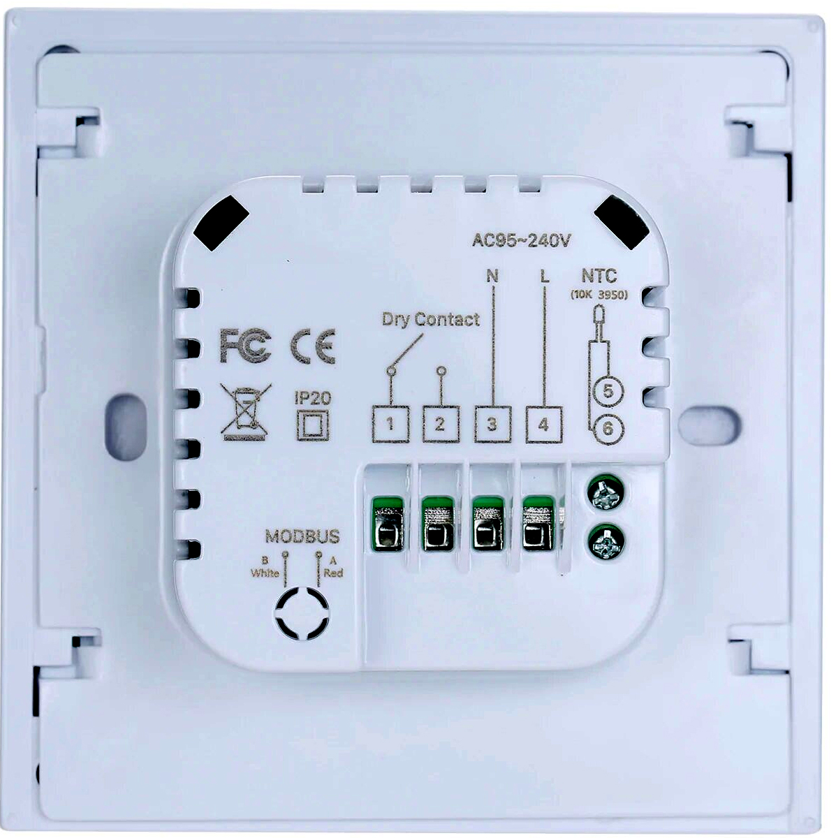

And this is my new thermostat
L and N self explanatory but the green/yellow which I assumed would be earth has confused me, thanks in advance for any help and advice
Beware- your new controller may not be suitable for your setup.
At the moment you have L and N powering the thermostat and volt-free contacts connecting 1 and 3 when heat is required. Lines 1 and 3 might not be 240 volt, some boilers use an extra low voltage for that function.
Your new toy uses the L supply to the stat for signalling as well as power. More info needed- pics of the terminations at the boiler or wiring centre would be useful, as would make/model of boiler, are there motorised valves, that sort of stuff
Agreed. Needs clarification, and cabling needs sorting out. The existing wiring uses the earth conductor as a live (heating on). This is very naughty.

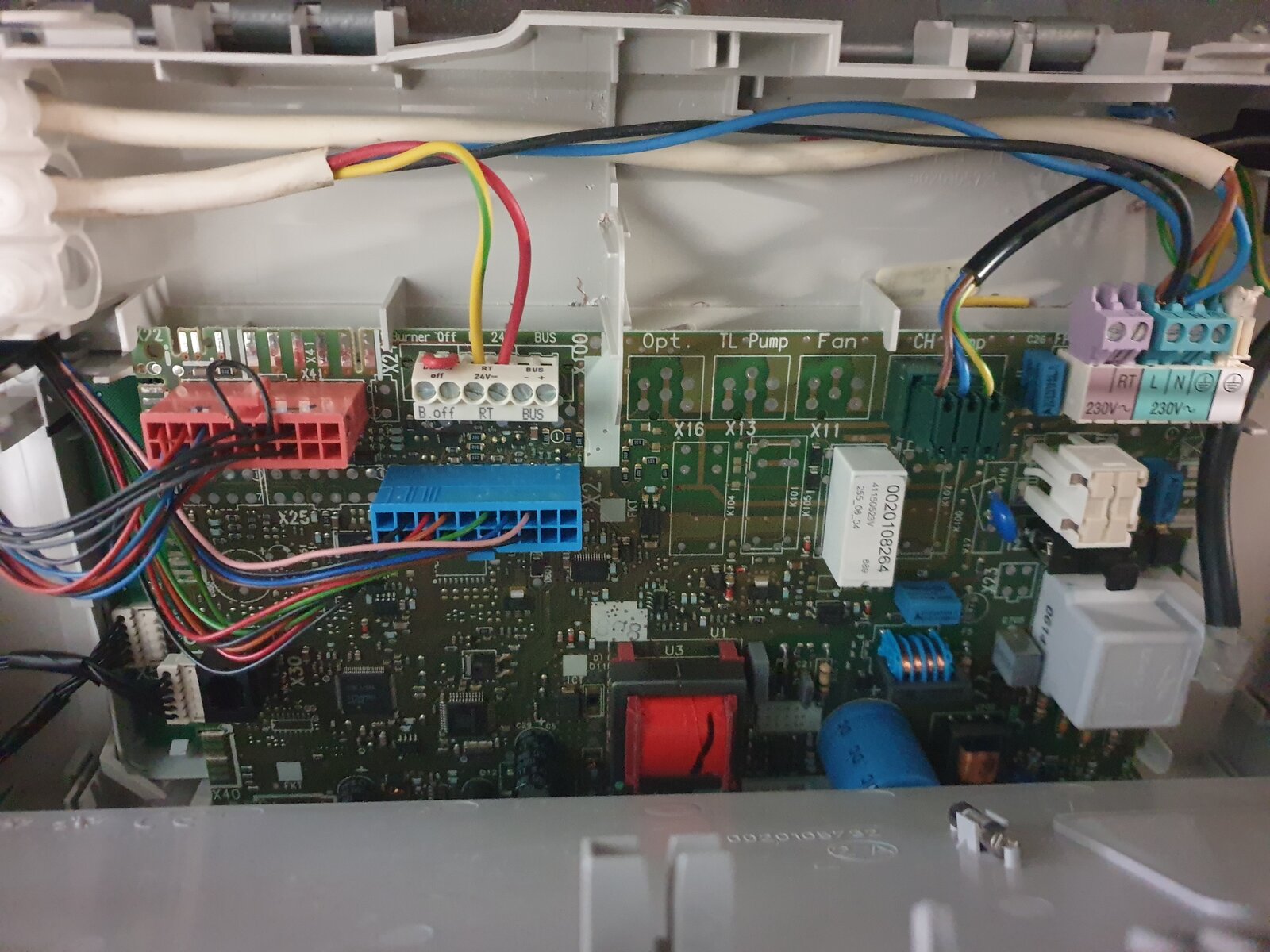

Thanks guys, so heres the PCB of my Vaillant ecotec pro 28
Refreshed page and pictures came up, were not there when first looked. I note using 24 volt control but has option for bus control, seems already using Hive so not to use the bus and to loose ability to link TRV would be a down grade so why bother?

So, to decipher for @Mr_C
You cannot use the Tuya stat because that will send 230volts back to the boiler. The boiler uses 24volts to call for heat. He needs to get a thermostat with volt free contacts.
Is that correct @ericmark ?
Yes need thermostat with volt free contacts. This one looks nearly the same MODBUS.jpg however does have volt free contacts. Think it was a Moes? But he shows using Hive, which is better than the Moes, as it will connect to TRV heads, so why down grade?

Apologies I have so many questions, so with that being said do you reckon my new tuya would still be unsuitable as it has 2 outputs on the side that claim to be volt free outputs
1 and 2 or the right appear to be the only set of voltage free contacts, rated at a maximum of 3amps. It doesn't give much of a clue as to whether that 3amps limit is a resistive maximum or inductive load, nor any limit on the voltage switching ability. Those details might be on the spec. sheet.
