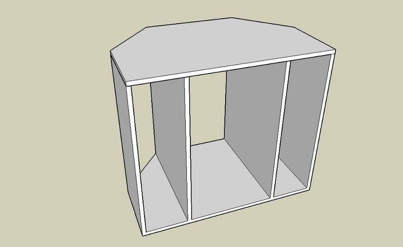

Thanks for the replies guys, they were really helpful. i'm going to get to work on it as soon as possible. First, I'll explain just what it is that I am building. It is a rather large (W=42ins/106.5cm, H=40ins/101.5cm, D= 24ins/61cm). It is designed to hold a widescreen television, and has drawers, a small cupboard, and compartments for holding DVD'd and Videos, as well as slots to accomodate a DVD player and a VCR. At the back it will have a door which will allow you to gain access to the back of the television, DVD player and VCR. I would like to use something like pine, but I am working on a low budget.
Granted it's a large TV stand, however TV corner units are all much of a muchness, basically they're like this:
To take the extra weight of your large TV unit I'd suggest putting solid 18mm backs into the side openings and bracing the centre opening with three or four 70 to 100 mm wide cross braces beneath the TV itself and with at least the one cross brace at the bottom/rear. The feet will need to be located beneath the uprights to stop it all from sagging over time, so that means you'll probably need 8 feet rather than usual four. Other than that it is still a relatively simple piece to make and 18mm MDF is well up to the task providing you can glue and screw it together to form box sections. I used to make kids furniture out of 18mm MDF and if a piece of furniture couldn't stand my 85kg on top of it then it simply wasn't strong enough, IMHO. I never broke a single piece, although all were designed more-or less as a series of boxes with one side open.
