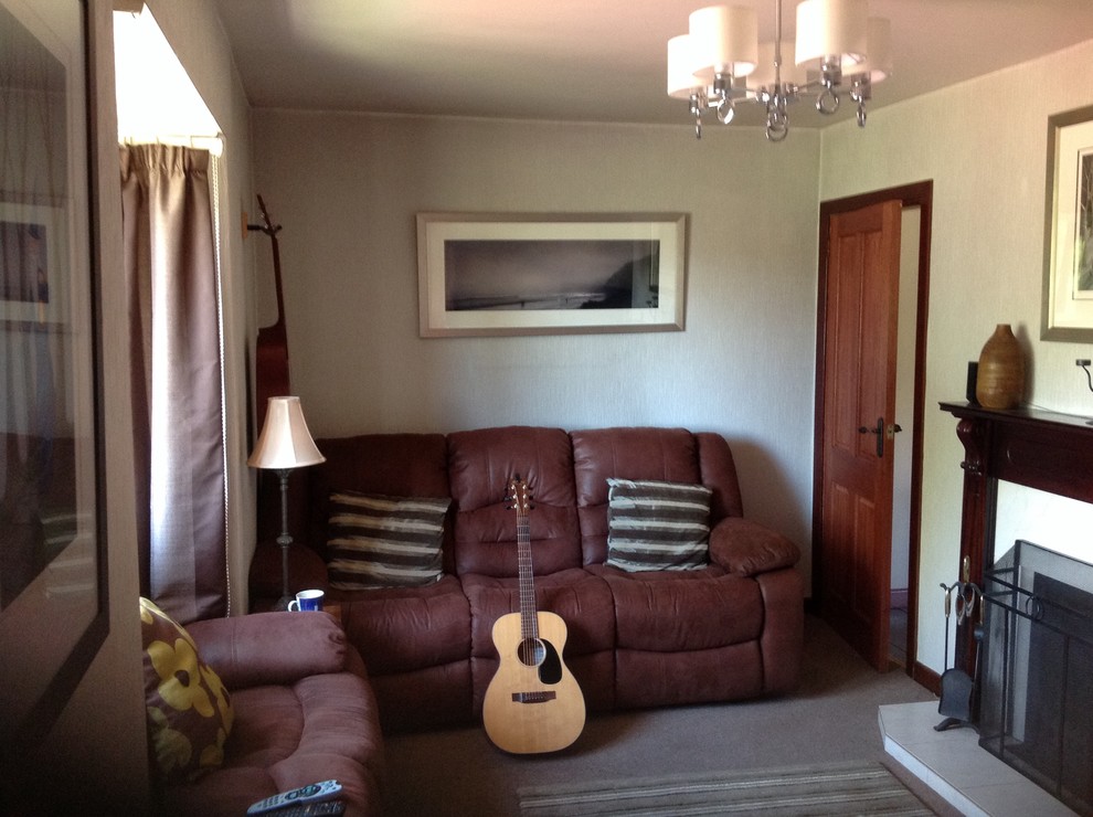

Hi,
I have a simular layout as you can see from the pics. Personally I dont like a tv mounted on a wall for a couple of reasons... 1) its too high for comfort. A tv should be at eye level when seated. 2) Access to the rear. If like me you like video games etc its important to have access to the back of the telly. 3) Cable city. Theres nothing worse than seeing cables which could be a problem mounting it above the fire place. 4) Hassle. Its much easier to replace down the line if its just sitting on a tv stand.
Some tvs have a swivel base, I know my panasonic turns on its base so keep an eye out for that. I dont have floorboards so I cant really have my speakers where id like them without doing a lot of work (putting cables behind skirting boards) so I have them a various distances in front of me which is fine. Good quality speakers make up for the lack of direction.
Hope this helps in some way.
