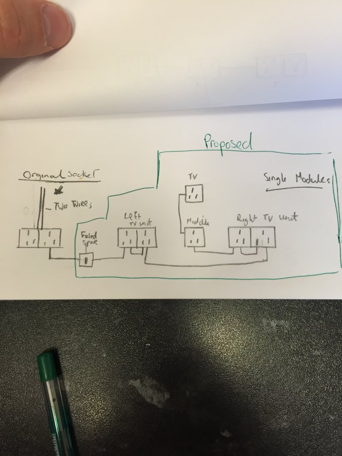

see image
I have an original plug socket which has two wires coming in,
I need an extra 5 power sockets in my tv unit diagram
Is the image correct adding new a 13amp fused spur then connecting one to another or do they all have to be run from the fused spur socket, or is the diagram completely incorrect
Many thanks

Its OK. Provided the original socket is part of a ring final (and not a spur with a spur from it already). If so, what you propse is OK as all of the additional sockets will be protected by the 13A fuse in the FCU.
So, first job is to confirm that the original socket (with two cables) does is actually form part of a ring final.
