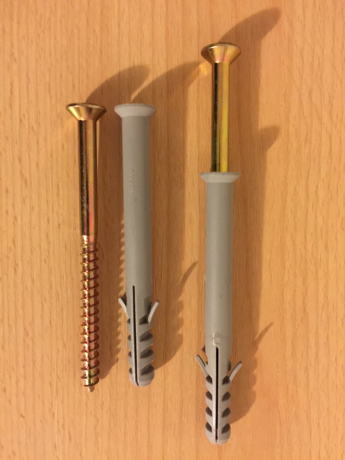

Hi all,
I wanted to mount my TV as well. This is a dot and dab plasterboard wall with grey breeze or thermal block behind it.
Will this fixing be perfect for the job or i need something else?.
Yeah, they'll be fine, as long as it isn't a cantilever bracket.
If, where you drill, it's hollow because there isn't an adhesive dot right there, then screw the screw in by hand rather than using a drill. Don't overtighten it, or the board will start to pull into the gap and possibly crack.
I drilled a pilot hole (with a wood drill bit) through the plasterboard thinking that the drill will stop once it hits the block behind so I can use proper masonry drill for the block behind.
The wood drill bit just continued drilling all the way through (plasterboard & wall behind) without any major resistance! I was not expecting that!. Is it possible to have such soft wall behind a dot & dab wall?
The wall on the opposite side of the house in the kitchen (which is a party wall) was not like that because i do remember putting the cooker hood up a couple of years ago and that almost wore my drill bit out.
Yes, thermalite blocks are very soft to drill into.
Your other wall must be this type of block, they have a much more textured surface...
...and try to make the drill bit wander off-line
Thanks.
Does that mean that i cant hang a tv on the thermalite or need different fixings?
It'll be fine still. Just tighten the screws by hand, so that you don't overtighten them.
