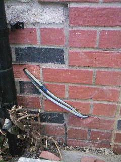

We had an extension built in October '08 and the leckie we hired to install sockets originally said he would take a new feed direct from the fuse box via a cable run outside. In the end he extended the ring main from an existing socket. No problem, but yesterday I cut down a big chunk of Ivy outside and revealed his wiring.
This is unprotected twin and earth run diagonally across the outside wall (along with an aerial cable). Now I thought that at least he ought to have added a loop or bend to protect against drips, and sealed the holes, even if the wires werent armoured or in some conduit.
Sorry I cant work out how to include an image so Ive created an album: //www.diynot.com/network/LanMan/albums
Is this legal?
His comment was 'its on a diagonal so whats the problem?'

Flat twin and earth is not suitable for use directly outside so it does not meet the requirement P1 of part P hence it is illegal.

It's a bodge, it's wrong and I'd ask him to return and sort it out.

Even for the aerial cable that's wrong - there should be (as you mentioned yourself) a drip loop at the bottom, otherwise water can run down the cable, and in to your house...
If you know which scheme it was with (e.g. NICEIC, napit etc) you could probably call them up, describe what was done and why you've only just found it, and how it was used as an assessment piece - they'd probably be quite interested in coming out and checking again...

As said before, I'd let NAPIT or whoever know. They would raise a few eyebrows & hotfoot it over to your joint to have an eyeball.
Get him to find an internal route and get rid of the external mess.
Depending on how he responds will guide you on how to react to his ethic and attitude.
In real terms, there's little chance of it "degrading" in sunlight. I'd be more concerned about rodent damage at that level, and the mutual detrimental effects of running 230v and an aerial together.
