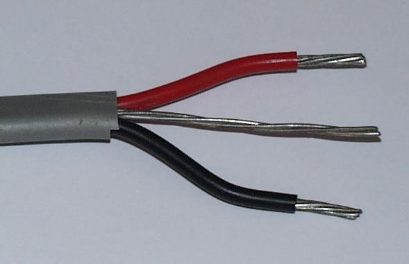

I found a connected cable that has a multi strand STEEL earth wire.
Never seen this before, how long ago was this cable used?.
It was steel, as I had to disconnect it, to use it as a draw wire to pull a signal cable through.
put simply it is old enough to be worth a rewire!!
think it dates back to early 70's but can't be sure for certain but definately pre 80's
Last time i came across stranded earth wire the conductors were trs twin ,as far as i can remember this hasn't been used since the 60s(early)
It wasn't steel then.
If you've still got some, scrape at the cpc with a blade and you'll see copper.

I have seen twin and earth cable where the earth wire was steel. Some time before 1962 my uncle had used it as a catenary cable anchoring the steel wires to the fixings on the walls. And coated it with bitumen to prevent rusting.
Now whether it was steel for strength or because of shortages of copper meant steel was used as a substitute I have no idea.
