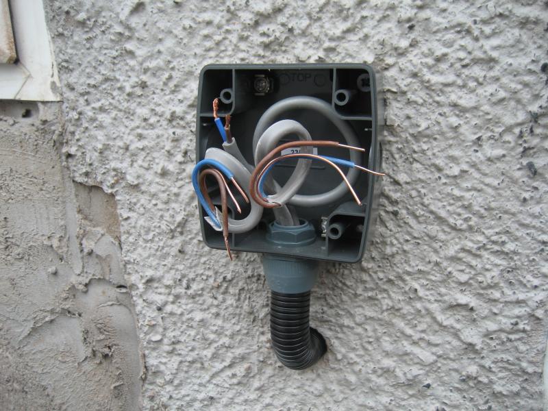

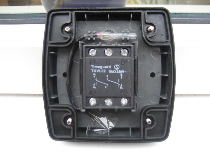

Hello group, i'm looking for advice on installing a twin gang 2 way switch, basically I am replacing a 1 gang switch which used to work an outside bulkhead, I have added another bulkhead in a different area of the garden and ran the wire back to the switch backbox. I have mains feed to the switch in the form of a twin and earth sheathed cable, I also have twin and earth running to both lights.. I purchased an weathersafe outdoor twin gang 2 way switch, and need to wire it up. The switch denotes the following on the back: -
A1 C B1
A2 L B2
All these are individual terminals. Also on the rear of the switch it shows a link between L & A1, and a link between C & B2. I'm aware that all the earths bundle together, as do the neutrals, but where do the lives go?
Regards
Otto
ah, that's better with the picture..
live feed goes into L and C ( with a link. )
one lights live goes to A2, one to B2 ( swap to A1 and B1 if the switch operates upside down.. )
Thanks for the prompt response coljack, i'll give it a try now.
