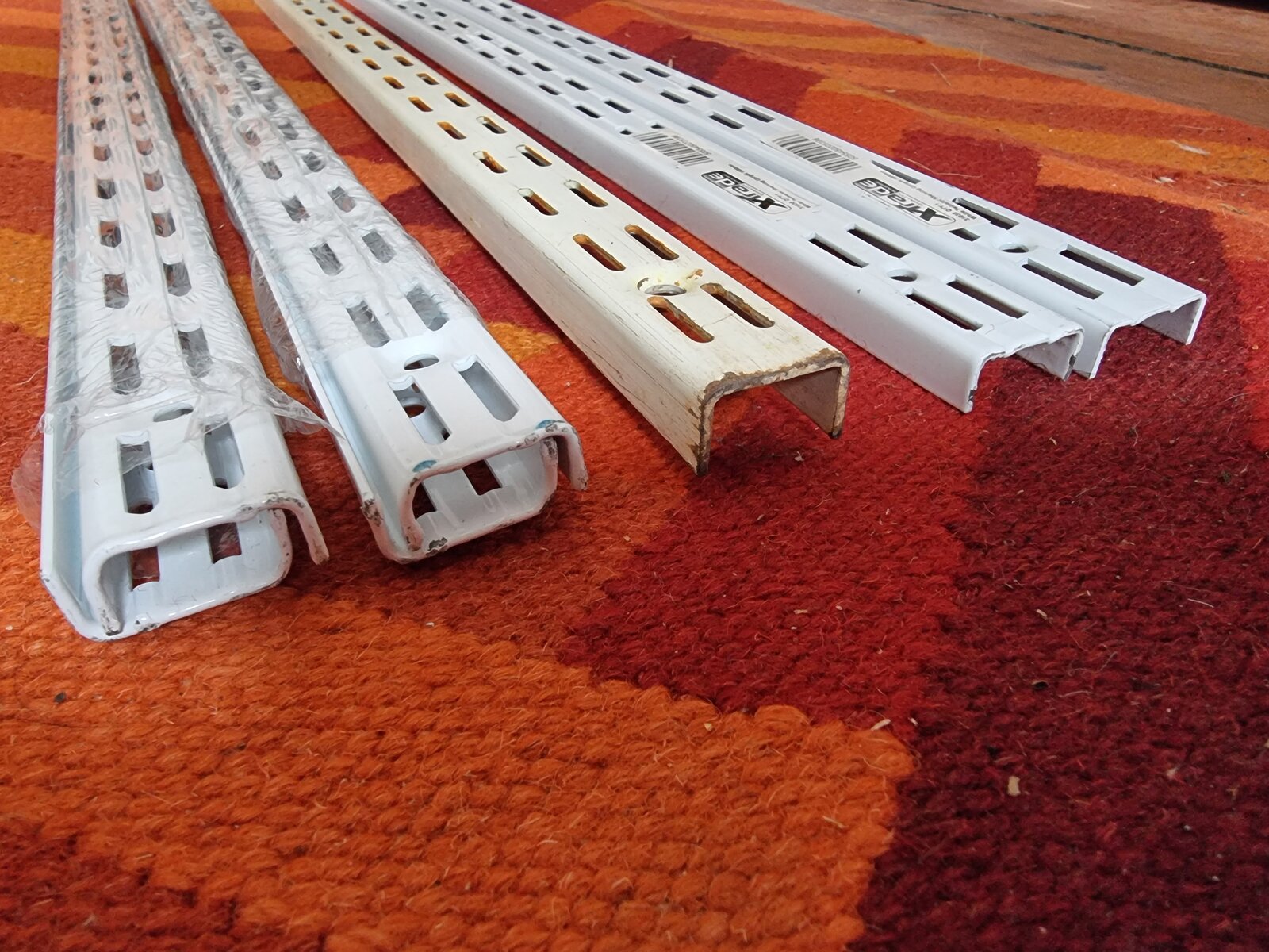

I'm wanting to put up a fair amount of shelving and was shocked to see that the quality of twin slot uprights readily available from Toolstation/Screwfix has decreased, certainly so that some old Spur brackets will no longer insert when the upright is fixed to the wall.
The uprights' profiles are now made from thinner metal and the profile has reduced to about 12mm thick from about 16mm. I'm not sure how much this affects the load bearing capacity, not least if I have to grind down old brackets to fit. Annoyingly none of the product specifications ever mention the profile thickness so it is left to discover after purchase.
Toolstation stock 'XTrade' - with grooves at the front running along the length and about 12mm thick. Also Rothley (no idea of thickness) but that's delivery only, in upright & bracket packs and £9 collection fee if it's no good.
Screwfix do 'RB UK' (also with grooves at the front running along the length and 12mm thick - though I'm sure it was thicker in the past and without the long grooves and small notches by each slot). Also a cheaper version 'RB UK Antibacterial' (for medical installations?) so I can't imagine that being any better.

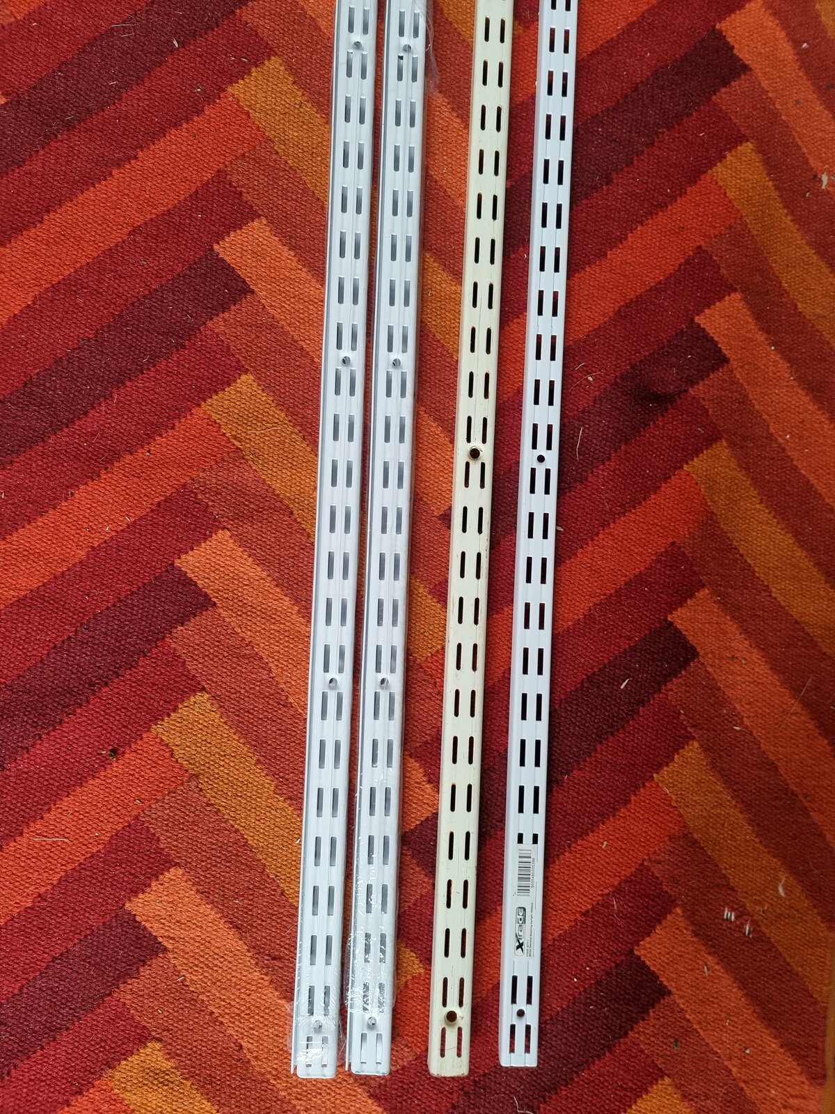

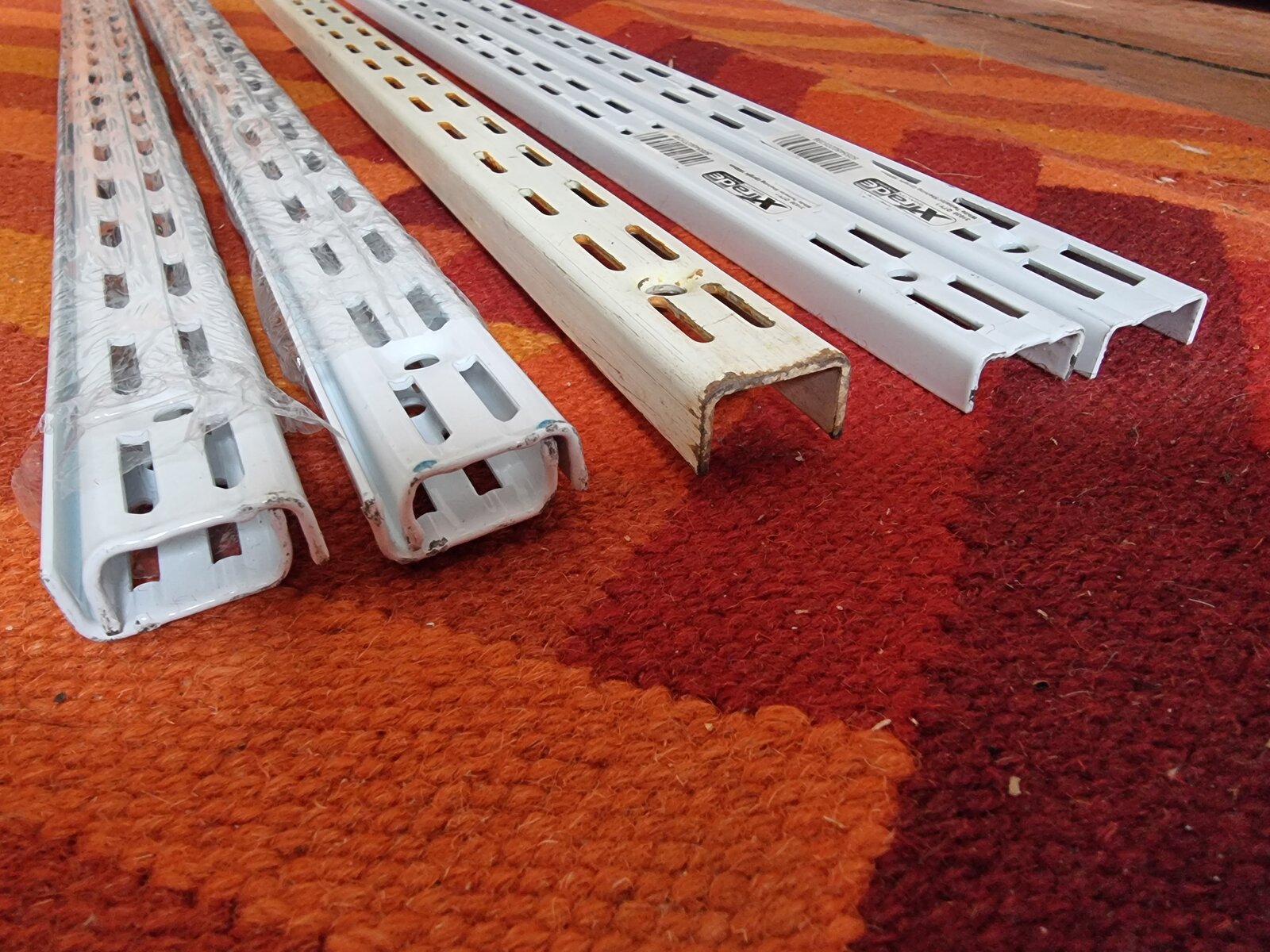

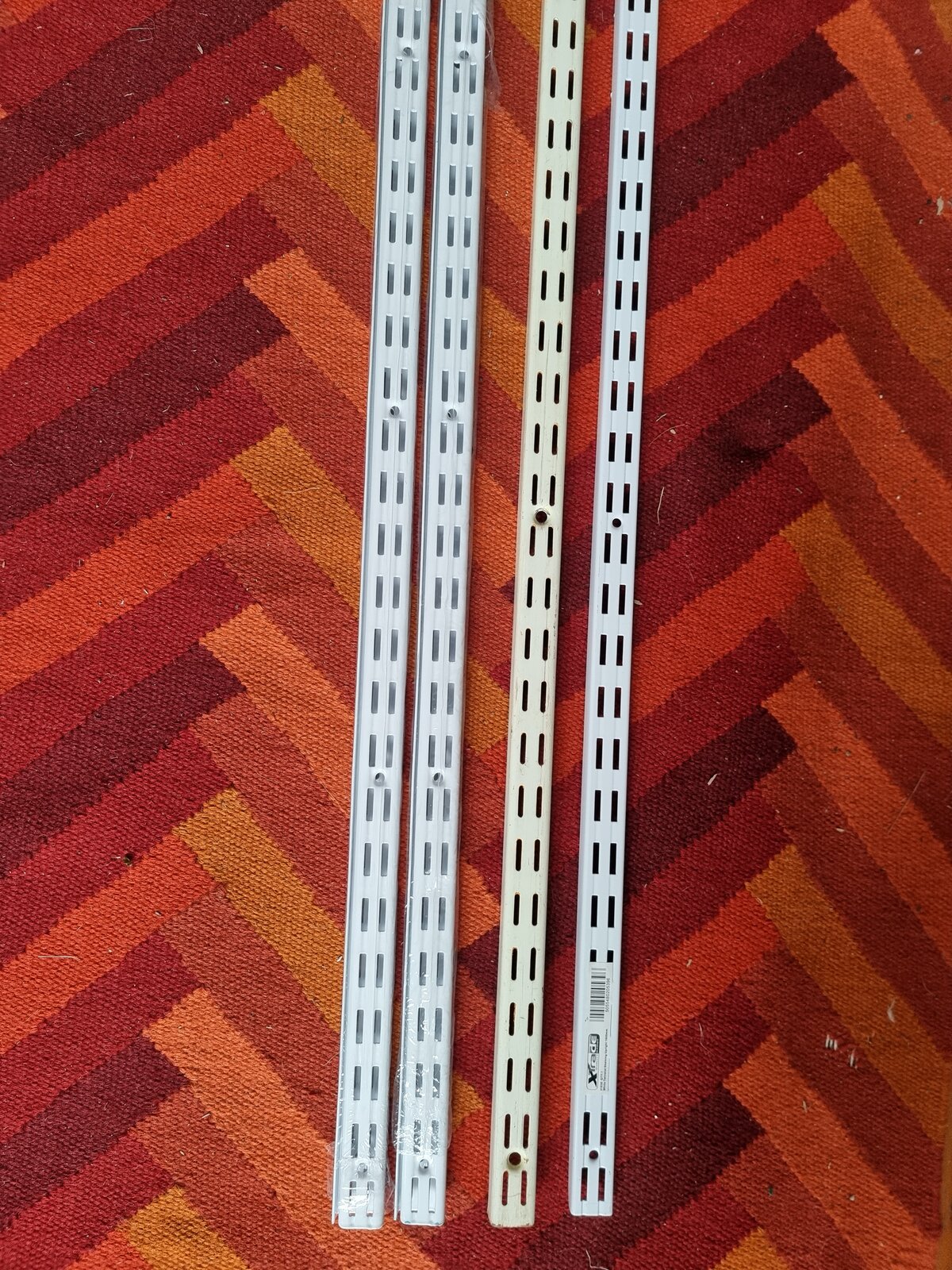

Tx for the advice. I found the XTrade uprights had the same number of holes as the old Spur
(off-white) ones but the RB UK ones (two left most uprights) had more.

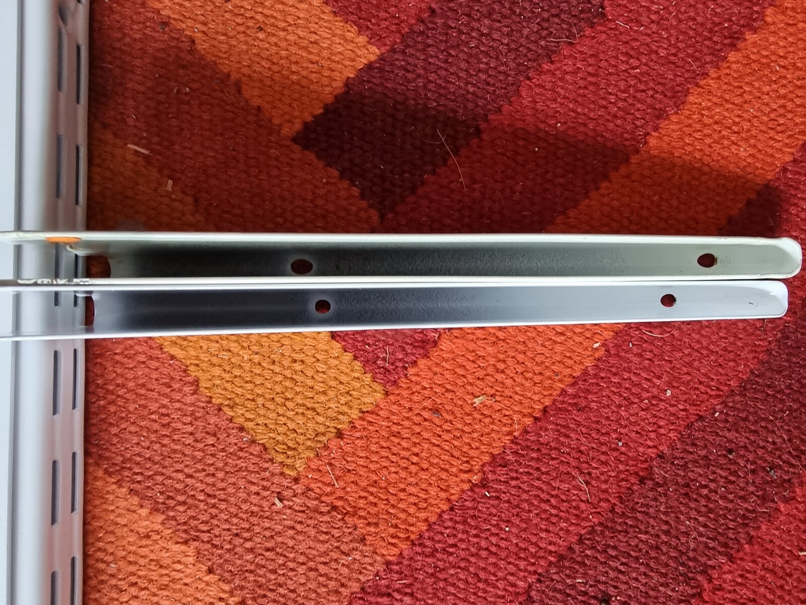

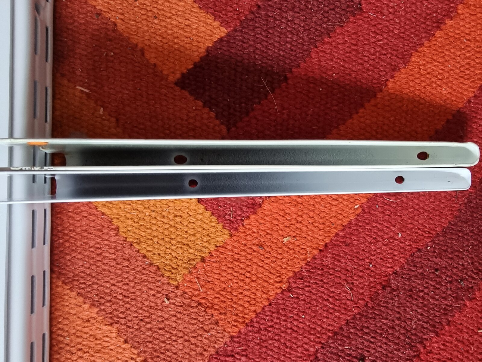

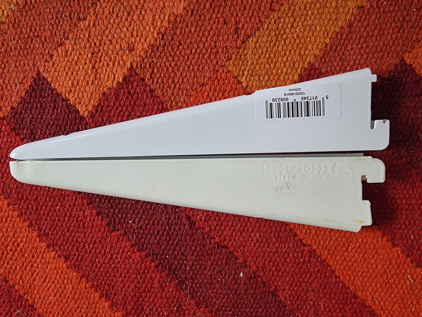

Also compared are the Spur and RB UK brackets.

I found that a gentle filing off the mounting points on the brackets would make them smoothly interchangeable.
I stick them on a grinder wheel for a few seconds, though you can just tap them so the rear buries itself in the plaster of the wall , it’s only a couple of millimetres.
