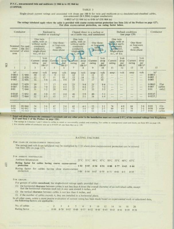

Here's the relevant table from the 14th edition of the Regs. which shows the cable ratings:
Approximate conversions on the sizes:
1/.044 = 0.97 sq. mm
3/.029 = 1.3
3/.036 = 1.9
7/.029 = 2.9
7/.036 = 4.5
7/.044 = 6.5
7/.052 = 9.4
7/.064 = 14.5
19/.044 = 19.4
19/.052 = 25.8
19/.064 = 38.7
