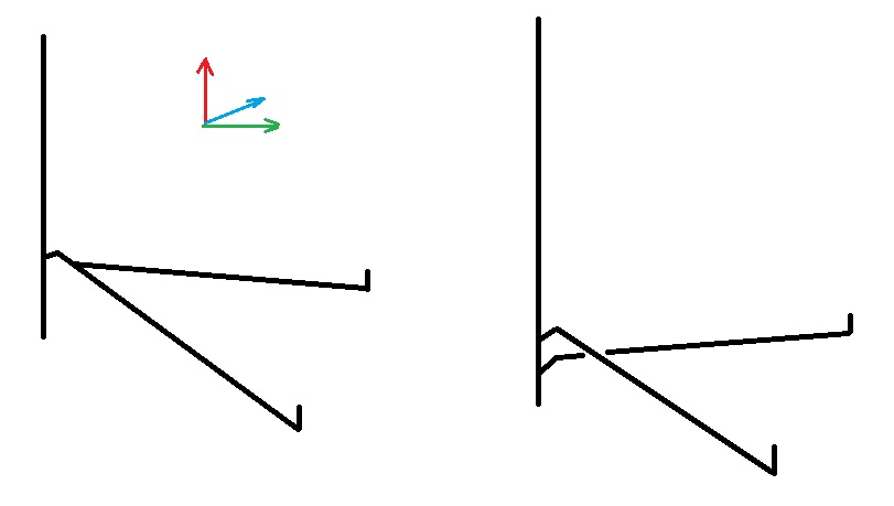

I am adding a new ground floor toilet and moving an existing one. Is it better practise to tee up both of the soil pipes before it enters the vent stack, or provide separate connections?
Either method would be ok, just keep in mind the requirements of Part H of the Building Regs on ventilation etc.
Yes, I spent some time poring over Part H. I couldn't find anything definitively saying whether to do it one way or the other.
