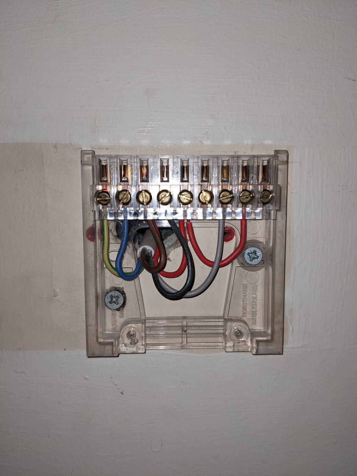

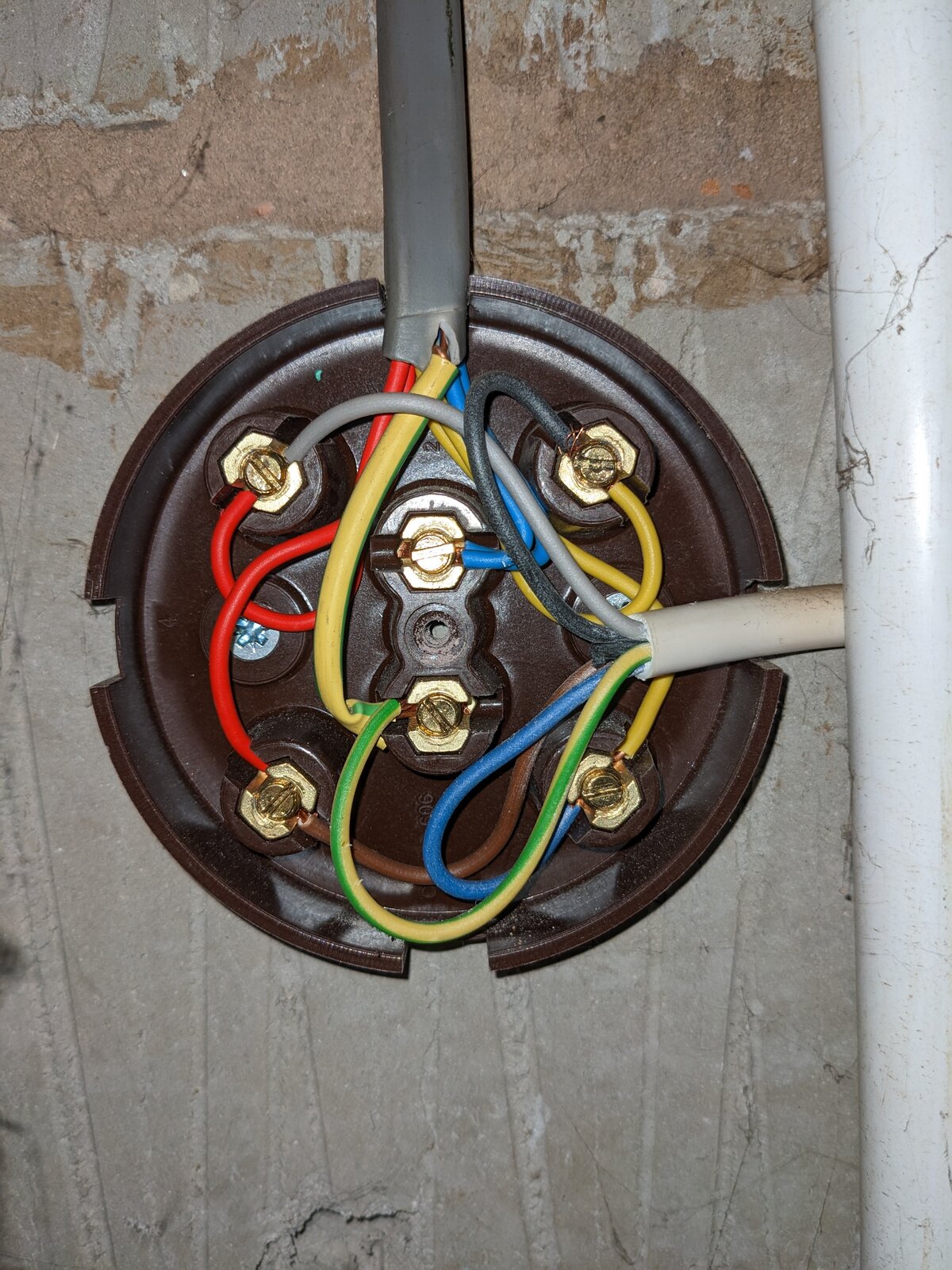

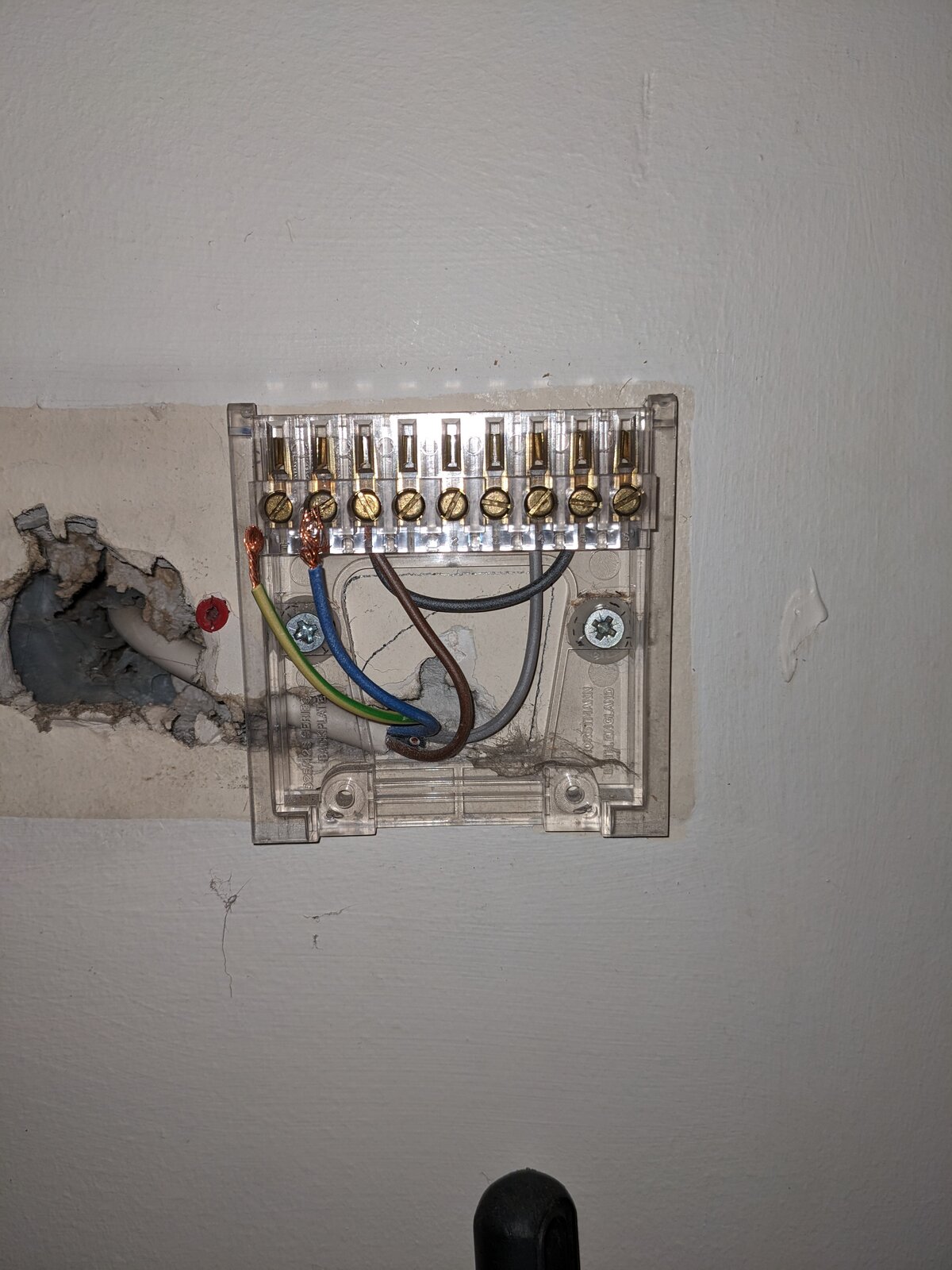

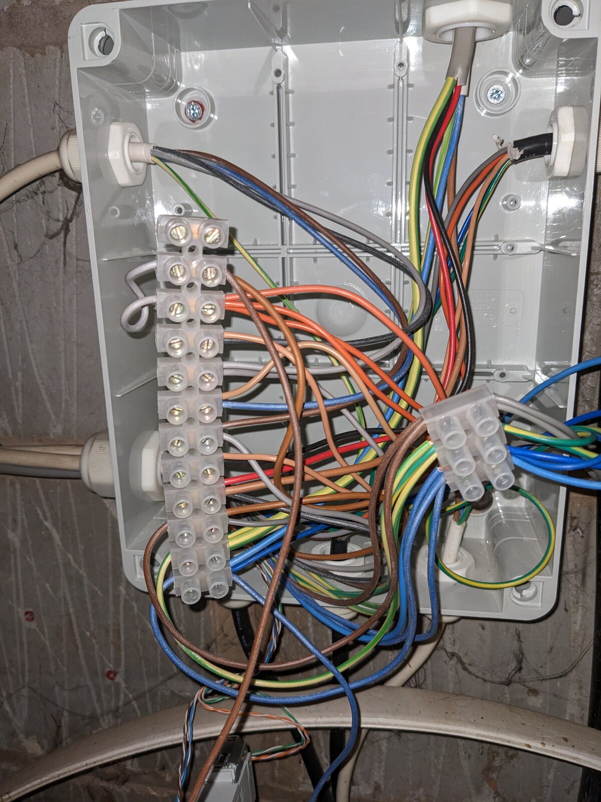

Hi Everyone, I'm new here and dealing with a very bespoke system so please be gentle.
Basically there are two zones in the house. Upstairs (with hot water) and downstairs.
Originally the zones were controlled by two Horstmann H17 XL with separate thermostats in each zone.
So far I have done the following:
Installed one single channel hive on the downstairs zone (just heating).
Installed one dual channel hive on the upstairs zone with hot water.
At the moment I have just bridged the old thermostats as the connections in the wiring box are just too complicated for me to bridge in the box and I needed a quick solution as the heating has not been working.
The issue am I am facing is that the boiler simply doesn't turn on, it is a pellet system, however I have managed to get it working but it switches off and says "stopped by external contact". The pumps all work and the system appears to be working, just without the boiler.

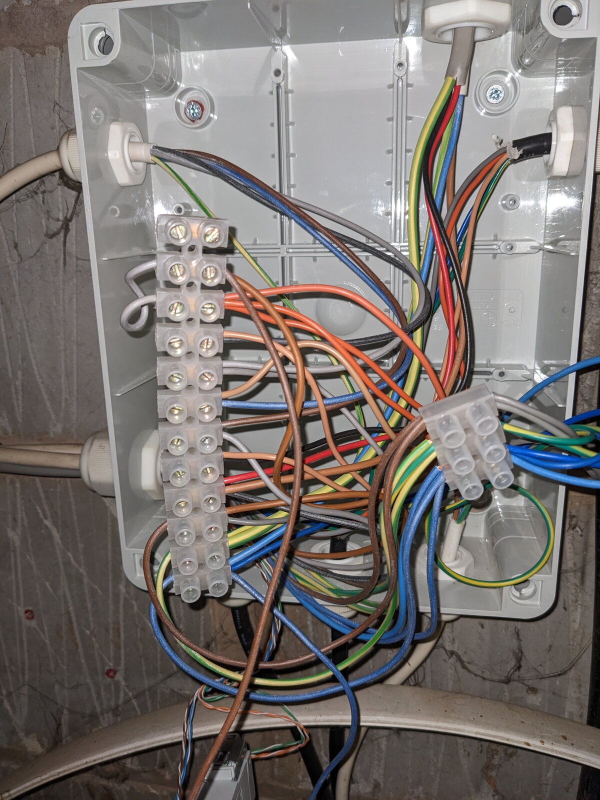

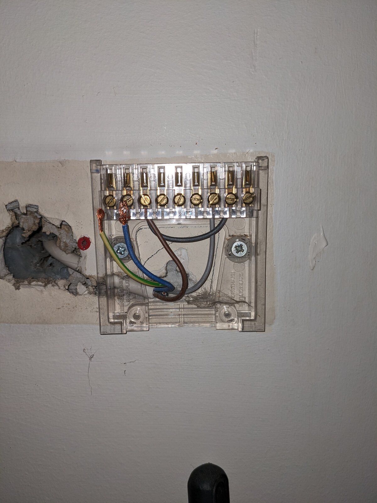

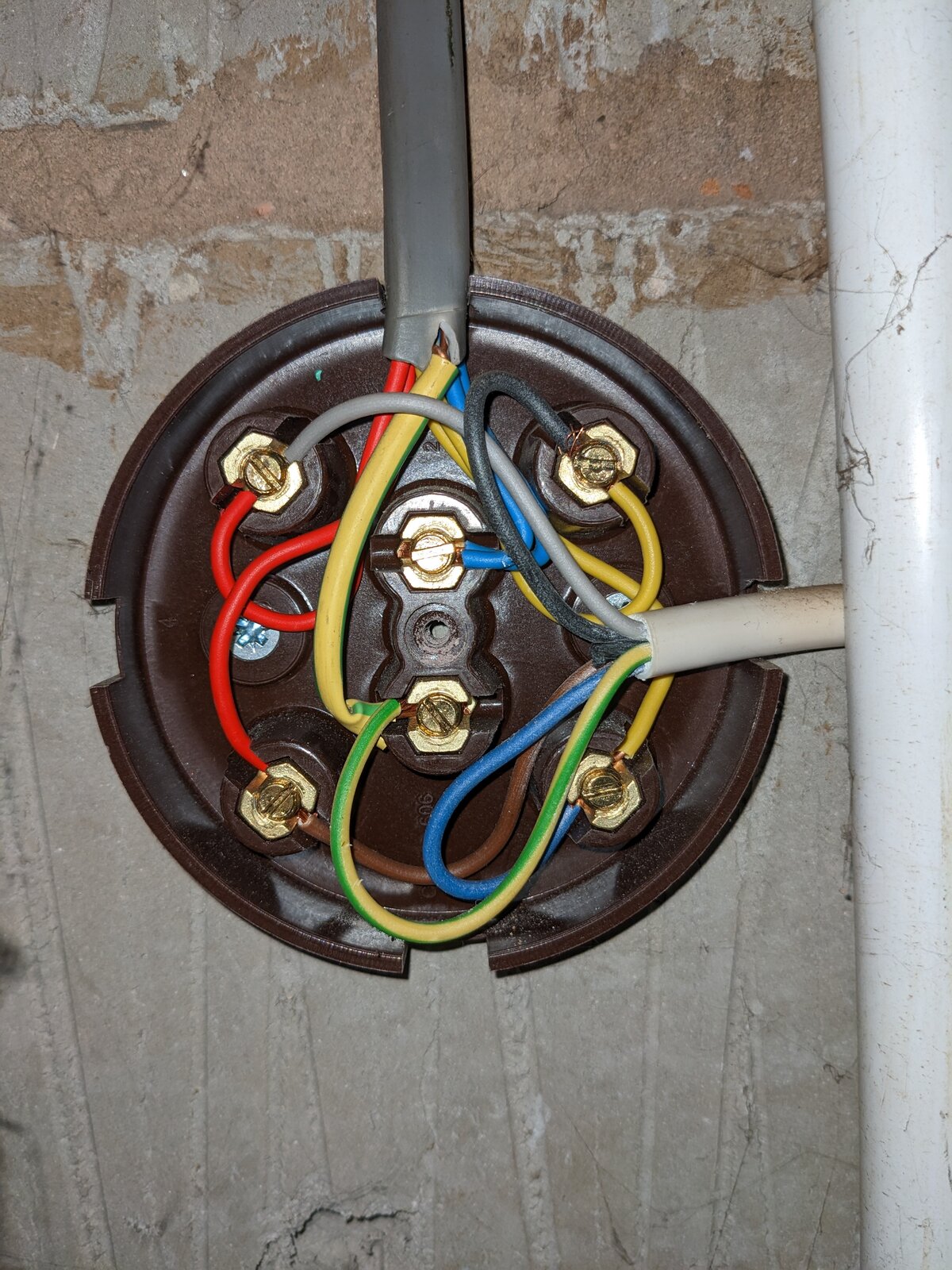

I've attached images of the wiring in the main panel and have followed the normal installation for the Hives.
If someone could look and give me a steer as to where this is all going wrong I would appreciate it.
If I have missed anything just shout and I'll post more images.
Thanks in advance!!

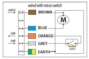

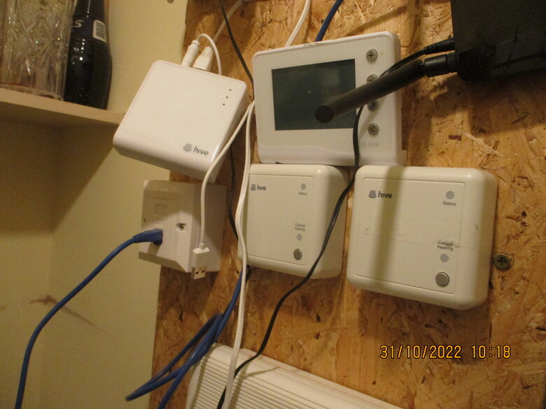

Looking at picture 3 it seems likely you have three motorised valves, so basic system is the three thermostats connect to the three motorised valves, and the valves once open work the boiler.
Diagram shows orange connects to boiler, and brown connects to thermostat, blue neutral, and grey to permanent line. The thing is the motorised valve comes with cable so one can go by colours, note some times instead of brown you get white.
So you should be able to identify the motorised valve cable and test the browns or whites are becoming line when thermostat is switched on.
Thanks ericmark, that's really helpful.
Based on the shocking wiring in the control box, I'm going to buy a new one and rewire the whole thing again into a better panel and label the wires with their output/input and what they control.
Once that's done I should be able to see the configuration better and make amendments to the controls easier.

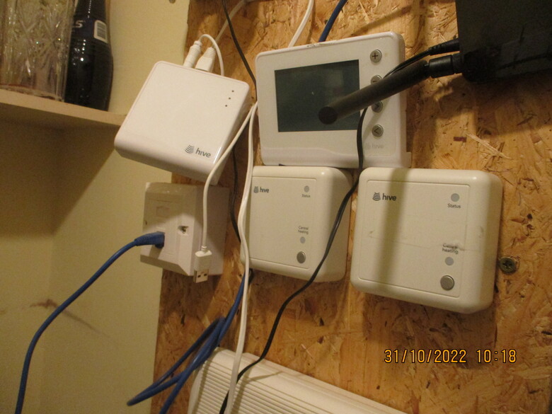

This was a combi with 2 heating zones.
