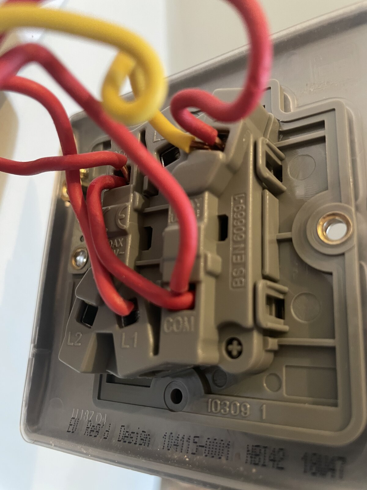

Hi all, newbie here just looking for some advice. Currently have two pairs of wall lights at opposite ends of my kitchen operated by seperate switches which i'd like to come on with just one switch. This is the current wiring so the question of the day is
1. Can I actually do this?
2. What switch would i need?
3. How would I wire it up?
Thanks in advance for any advice

Do you mean that the two switches in the picture are the switches that operate the two sets of lights and you want just one of the switches to operate all the lights?

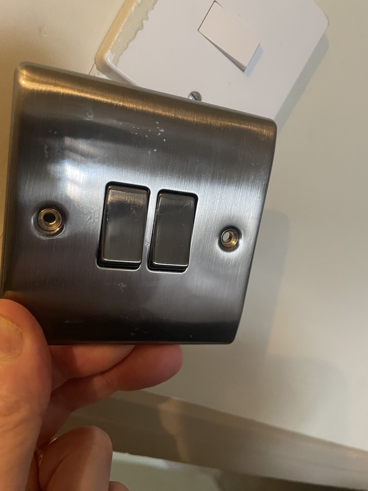

Absolutely, I want a single switch to replace the current double switch that turns both sets of lights on at the same time

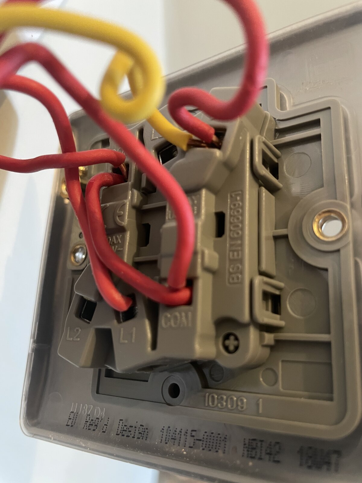

Do you know what the yellow wire is for?
Anyway, move these two wires as shown and discard the link wire.
Too late I guess but that metal switch should have an earth wire connected to the earth terminal
