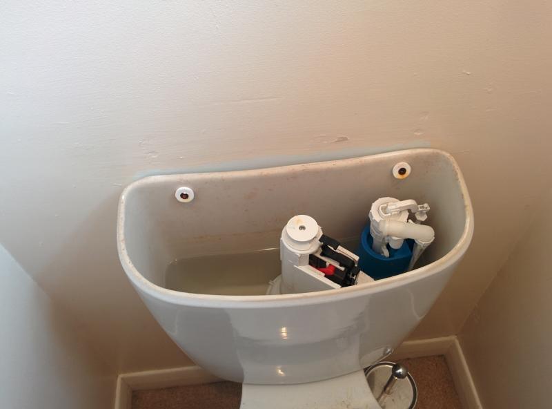

Hi,
I moved house recently and the two toilets I have inherited from the previous owners are, frankly, a bit pants. They can barely flush a piece of toilet paper let alone my son's irregular emissions, and both of them leak water down the back of the pan for a long time after each flush.
To fix the leaking problem I'm sure I could just replace a washer / the flush mechanism, but can I do anything about the poor performance? The water in the cistern doesn't seem to come very far up the inside from what I can tell, but this may be because modern toilets are limited to 6 litres.
I suppose another question would be - which of the Wickes or B&Q range of toilets offers a decent reliable flush. I don't much care what it looks like as long as it removes whatever is deposited within it.
Edit: Forgot to add, the toilet seat doesn't stay up on its own on the downstairs loo!
Thanks in advance.

I would try changing the flush unit to an aftermarket one they usually have an option for a larger flush to suit old toilets, crank it up and fiddly-dee as far as the regs are concerned. After all having to flush twice is hardly helping the planet is it?

Could be a few things, all easy enough to fix/replace. Could be washer on bottom of flush valve not seating correctly or prongs on bottom of push button too long and holding valve open. Most likely though will be that vvank armitage float valve, just replace that with a fluidmaster and alter water level in cistern to just below overflow level for a better flush
