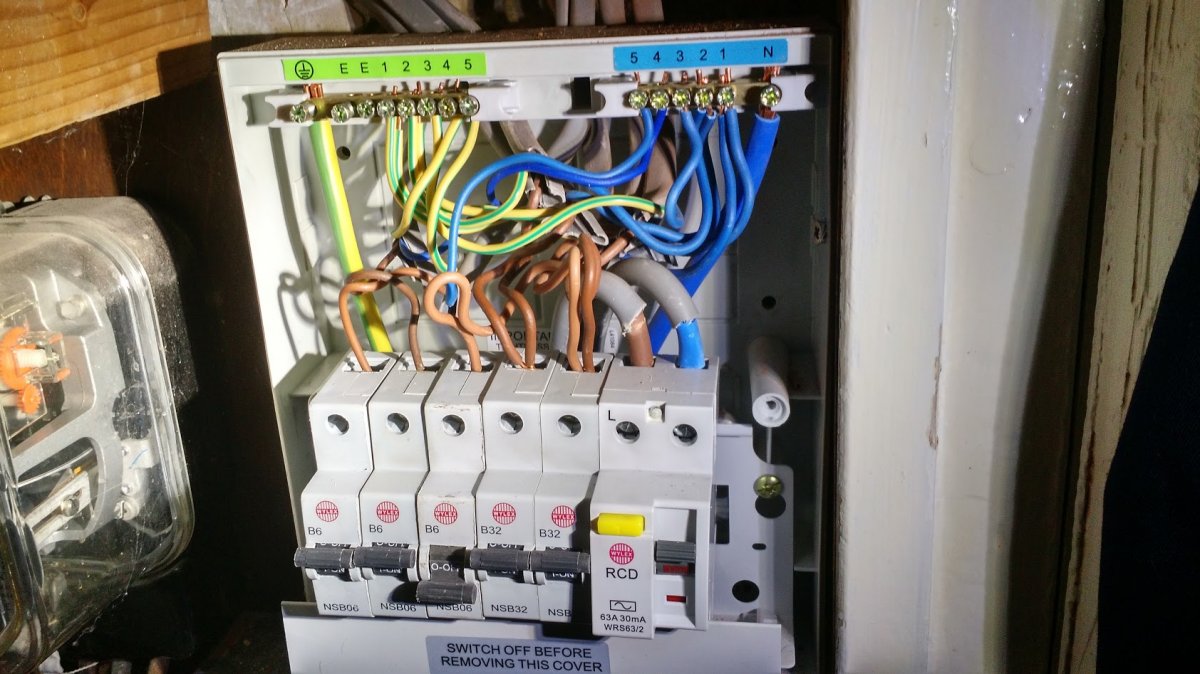

Please look at the picture, it shows the tripped circuit breaker.

Unfortunately we do not have X-ray eyes! Need to see the wiring with the cover off!
Also, which of the 5 MCBs is the one that switches off the sockets?, and which of the grey switches "trips"?
It is the middle one, No. 3 as seen in the image. Ok, I opened the box and all wiring seems ok, nothing loose and all corresponding wires in the right place.
So while there with the RCD uncovered I disconnected the wiring of the upstairs room in question and connected it to the Circuit Breaker of the downstairs sockets (which never failed). It worked perfectely, testing the Vacuum cleaner. No tripping. Hoorraah!
So is it the circuit breaker defective or perhaps more plausible the fact that it is a 6Amp as against 32 Amps as the one that worked? I think 6 Amps is quite low for two double wall sockets, considering connecting a vacuum cleaner or a hairdryer would need at least 10.
So in brief: Original connection to NSB06 tripps, but connecting to NSB32 works.
So if the NSB06 is deemed too low which is the recommended one?

The problem, as you say, is that the MCB is too low for the load.
The size of teh MCB depends on the thickness of the wiring, and the type of circuit, so we need to see the connections to the top of that MCB to judge what size the MCB should be.
The "electrician" may have put in a 6amp MCB for a reason.
PICTURES PLEASE!!
How many wires are on the MCB. If only one it's a radial circuit and it would expect it to be 20 amps. If there are two wires it could be a ring which would normally be 32 amps. But without checking it may not be a ring so to be safe put in a 20 amp.
Do not put in a 20 amp! This could have previously been a lighting circuit that a numpty has converted to a plug socket circuit. Or it could be anything; no way of telling without test gear and knowledge
For an extension, unlikely. If it's 2.5mm² and the OP has not noticed anything else not working whilst it's been off, then it's fairly safe to say the muppet just used the wrong breaker, either because a) he didn't know any better or b) bought a pre-populated board and couldn't be bothered to get the correct MCBs
What on earth is going on with those tails in that picture? What a dogs dinner, more blue on show there than I have on show inside a consumer unit
Unlikely but entirely possible considering kitchen sockets weren't earthed
I still vehemently disagree, the chances of that being what's happened are infinitesimal.
We shall wait and see what size the OP says the cable is, but I'd back it being >2.5mm² all day, every day.

Here is the picture and the MCB in question is the one in the middle, tripped, with one wire going in.
2.5mm² on the suspect circuit.
That is a dogs dinner in there! :eek:
I take back my statement about it being a pre-populated board, that offending 6A was clearly knocking around in the back of his van for a while, just wanted to get rid!!
