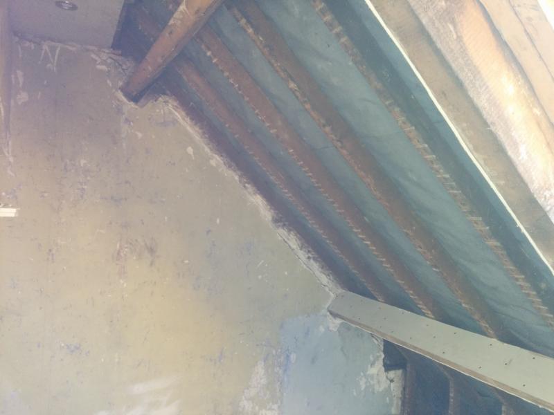

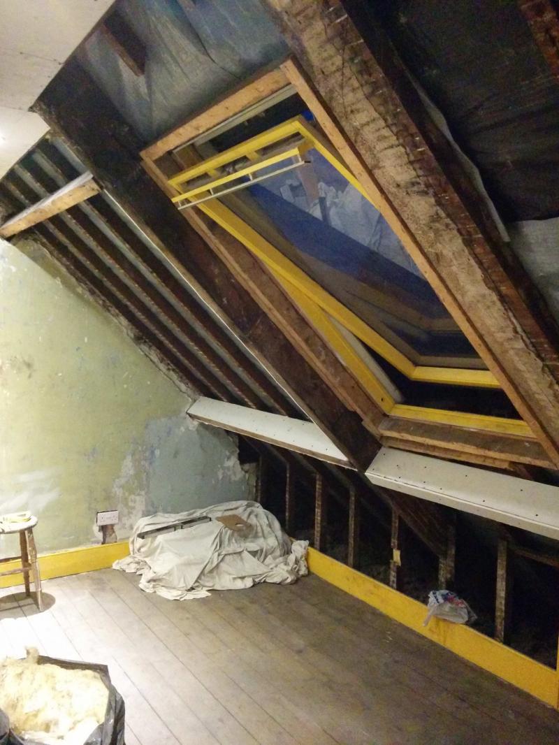

I recently bought a house and the attic space has no insulation. It's been very sunny recently and the rooms have been scorching. In winter it's going to be cold! I've taken down the old lath and plaster and have ended up with this:
The rafters are 60mm deep at 400mm centres. There are Velux skylights in both rooms.

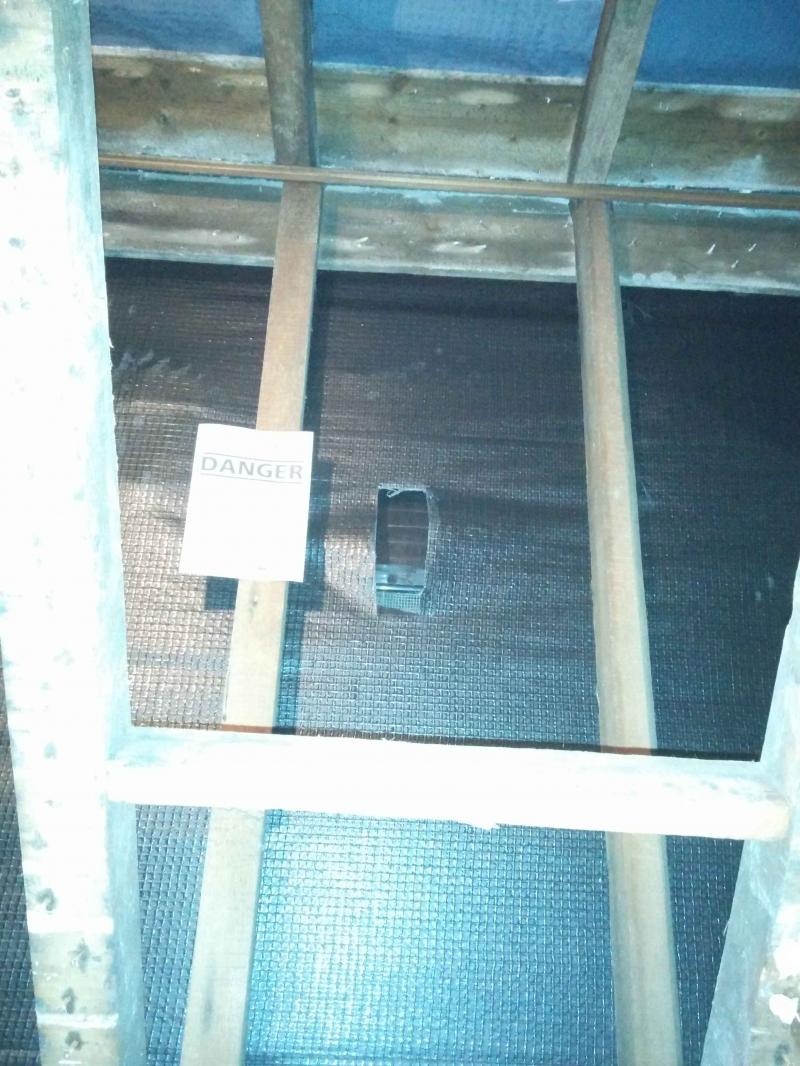

Do you have felt under the tiles or is it a breathable membrane or maybe nothing at all? Are there vents in the eaves and/or ridge. It looks like you have a couple of purlins going on there, what is the longest span of the rafters?
Forget all about the multi-foils they are a waste of money: //www.diynot.com/forums/your-projects/multifoil-insulation.408089/
At first glance you would probably be best fitting something like 35mm Celotex or Kingspan (or any other 'PIR' insulation between the rafters then adding a continuous layer of say 40mm over the rafters, then your plasterboard. It wouldn't meet modern standards but will be a great improvement.

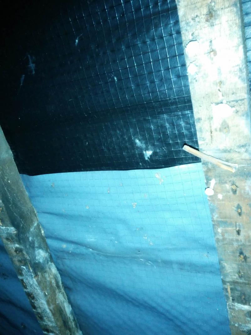

I *think* this is a membrane and not felt but I've never dealt with anything in the roof before so I'm unsure:
There are a few vents in apex of the roof and some on the eaves:
As for the longest unsupported length of rafter, it's about 200cm. The entire length of the rafter is about 370cm but supported by a purlin and a ceiling joist:
You mention that it'd be a good idea to place PIR between the rafters - what about the 50mm air gap? I have seen the 25mm air gap mentioned quite a bit but it's been tricky to work out when that applies.
OK so having vents top and bottom is good. 50mm is ideal but if space is a premium then 25mm will be OK.
Have a look at this fella, it shows the principle that you should be aiming at with how thw insulation can be dealt with in the dwarf walls:
Righto, thanks.
My eaves don't overhang the exterior wall, so I assume putting some ventilation in the cavity provided by the dwarf wall will be OK?
Re: air gap, spoke to Kingspan who said 50mm is required if membrane is not breathable. Any ideas if my membrane is breathable?
