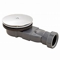

Hi all,
I'm installing a shower tray and waste at the moment. This is the waste:
https://www.my-bette.com/en/product/features-and-installation/bettesolid-30-side-outlet-0-6-l-s#2
I assumed there'd be a trap built in and the installation videos are a little ambiguous. However in the written instructions there's a diagram on page one showing a u bend and what appears to be minimum depths for it.
If I do need one, am I right in thinking I can just put one in anywhere along the pipe run? The shower is over a suspended floor and I have loads of the floorboards up (with the shower waste being around a metre and a half accessible run) so putting one in will not be a problem.
Yes - similar'ish to the wirquin, which is waterless
- if needed though a running or waterless trap could be fitted downstream, only trouble with that though is they really need access to be serviced periodically.
The Bette is seriously overpriced @ £184 tho :eek:

Yeah it was a bit pricey. Matches my overpriced shower tray though :)
Thank you. The instructions are perplexing but having had another look it is definitely a different design to that waterless one. Forgot I could just run it under the tap to find out tbh
Yeah but that's ridiculously overpriced for what it is and frankly no trap/waste is worth it if it's any more than say £50, much better products available, to do what you want to do, especially if space under the tray isn't an issue. When it comes to waste/traps, the larger the seal, up to 50mm, the better.

Thanks yes a fair point, and I have been debating whether choice of tray/waste was the right one as they were quite expensive. That said, I needed a certain size, this was the only one I could find, and I wanted a steel one to eliminate risk of cracking and wasn’t keen on any other material other than stone resin or steel.
I bought the waste as the cover is colour matched to the tray finish.
Fair enough - if it's bespoke then I can see why - if cost wasn't an issue in the grand scheme of things.
