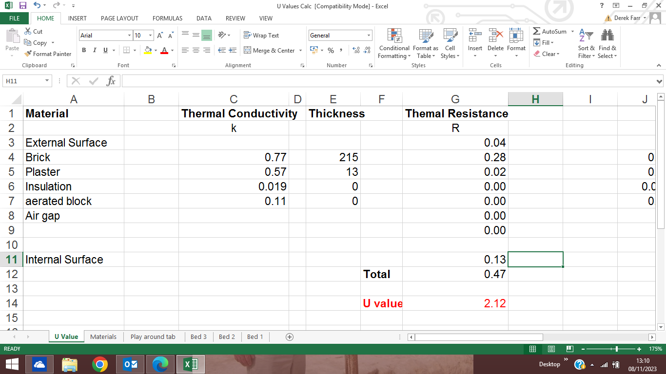

I've been using various online calculators for calculating u values for wall insulation, however they seem to vary considerably and make massive assumptions.
I need to decide how thick insulated plasterboard i install into some bedrooms - my property is a victorian semi detached, 2x brick skin without a cavity. The ceilings are higher than usual - 2.7m and there are large (sometimes bay) windows of at least 1.5m square, there is enough insulation in the loft above.
Is 62mm celotex/kingspan sufficient? I will be fixing it via batons, as there is no render externally and i dont want to remove all the plaster as its in good nic.

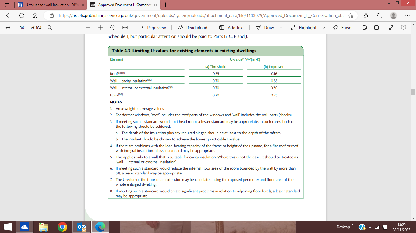

Generally minimum requirement is based on building regs but people can improve on this if they so wish.
Current BR U value for new builds I believe is 0.18 at the moment.
In your case your achieved U value is 0.3

Thanks, do you mean the u value i've achieved without any wall insulation, or that would be the achieved value if i were to put 62mm PIR board on?
If the latter, would 0.3 be considered decent?

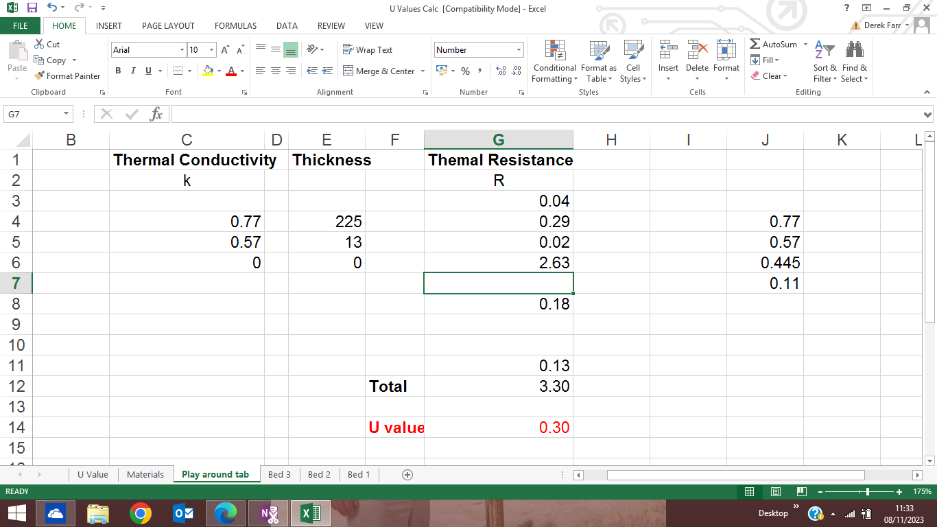

0.3 achieved with insulation. Without it your U value is 2.12 so you would make the wall about 7 times more effective in retaining the heat

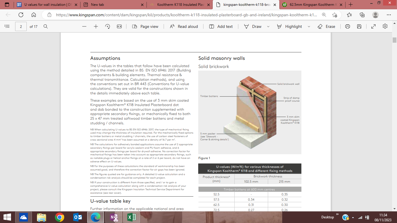

Building regs state that if a thermal element (e.g. a wall) is upgraded it should not have a U value of greater than 0.7 and suggests an improved value of at least 0.3 so your proposal can be considered to be within normal parameters.
