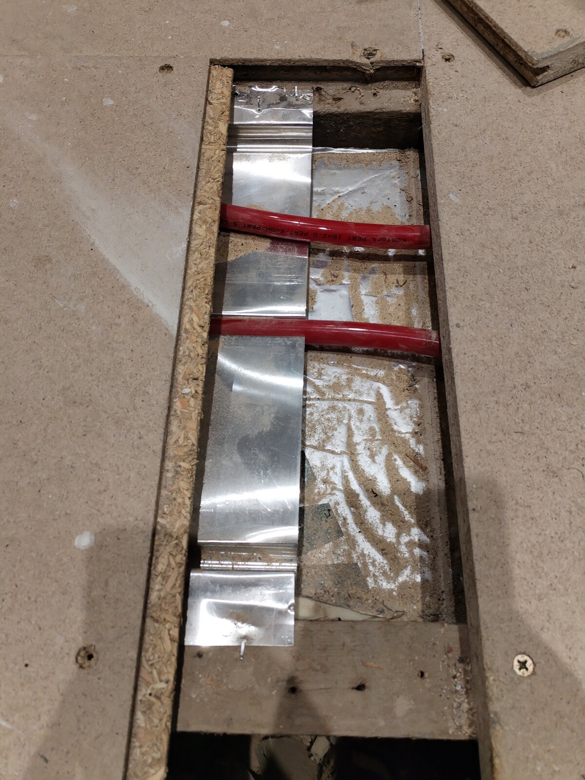

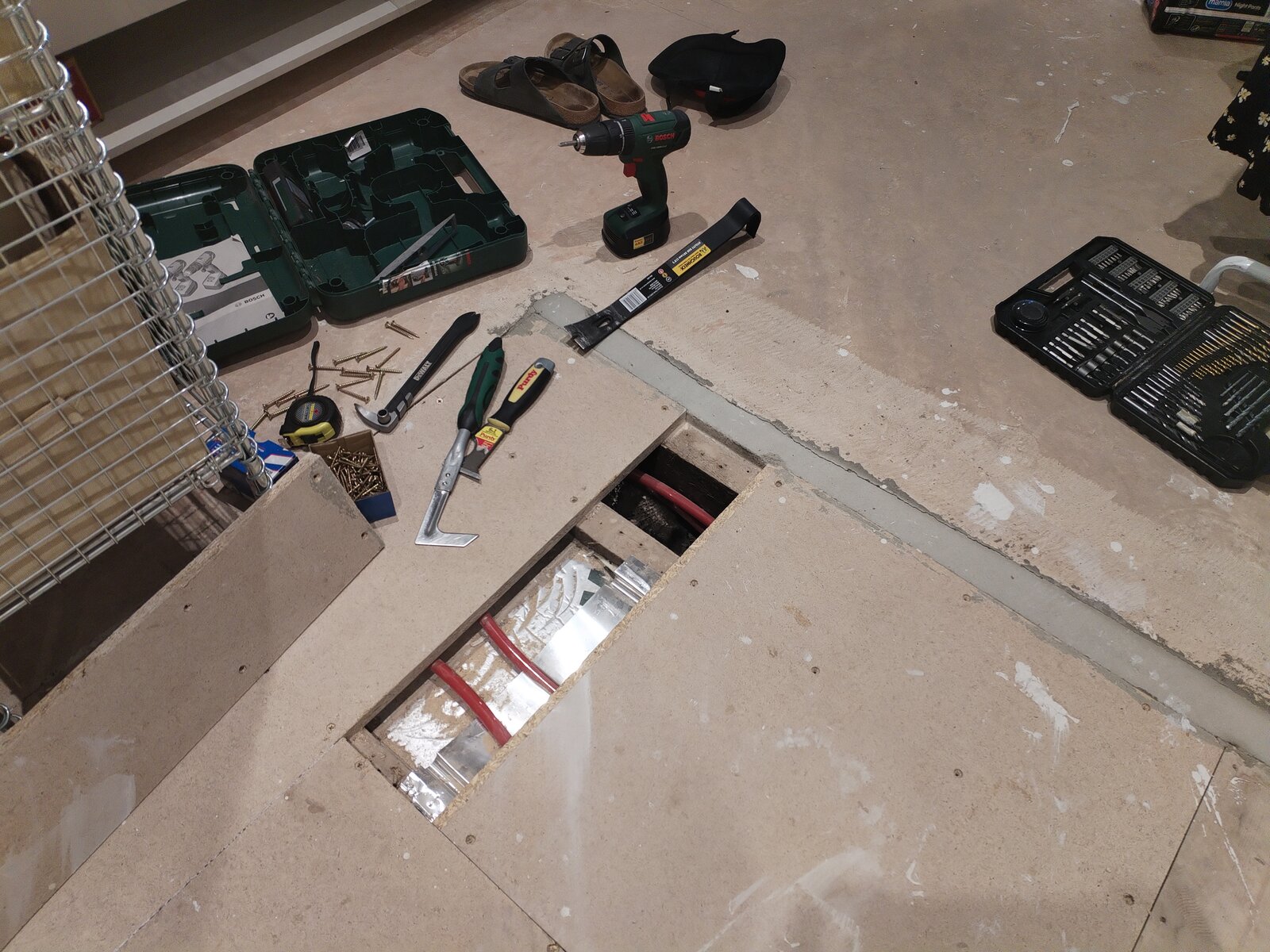

1. We've noticed that the retrofitted rooms don't get particularly warm. Is this always going to be an issue with 22mm chipboard? Apparently the heat pump engineer specified to the builder to use a more thermally efficient thinner gauge board. I've only taken up a small piece of flooring to investigate as I don't want to damage the flooring unless I have to. Photo attached of the pipes under the floor - this section is close to where the floorboards meet the concrete. I hope this is why one of the pipes isn't sitting inside the spreader plate.

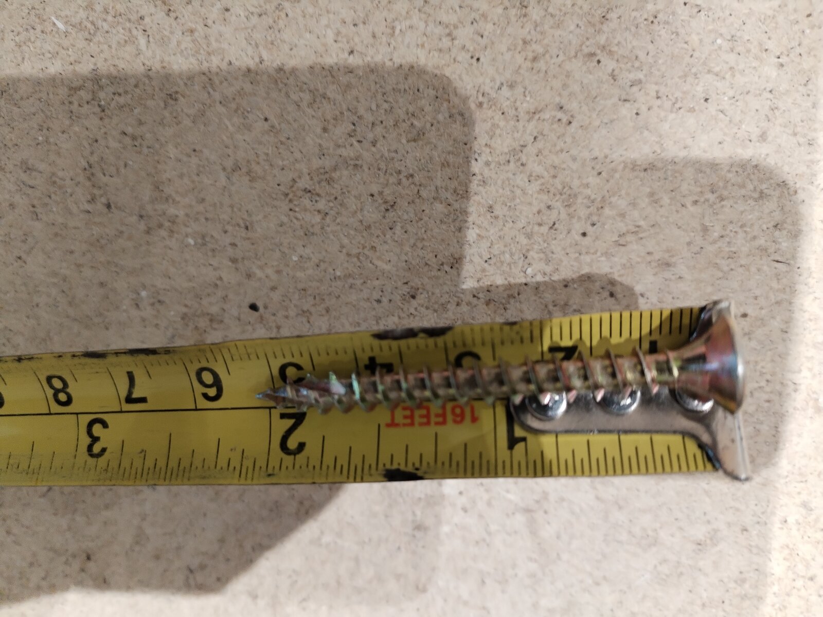

2. The chipboard flooring creaks quite badly. The builder has claimed this is due to expansion/contraction caused by the UFH. I suspect we are being fobbed off. I realise there might be a number of causes of this. On the face of it the boarding looks to have been laid well and glued where the tongue and groove sections meet. I wondered if it might be as simple as the wrong type of screws being used to screw the boards down? I've read various other threads which suggest using Spax or ScrewTite flooring screws to prevent squeaking.

That's because alu spreader plates suck, I'm afraid! Worse, the plate you've pictured doesn't have the pipe clipped into it, you seem to have gaps in your plates and your pipe density is low. Adding a floor covering is going to make things worse too
You may have success turning the flow temp up but I have doubts..
Do you have any screed anywhere that needs to run at a lower temp? Does that manifold have something like a TMV?

If those screws pictured are what holds the floor, I wouldn't initially suspect them to be the source of the creaking because they're fully threaded. Creaks occur when flooring moves up and down smooth fixings (eg non-ring nails) fractionally.. but by all means see if fitting alternative screws helps. It could be that your existing screws aren't clamping the flooring tightly enough against the joist and it's the joist rubbing on the chipboard that makes the noise. It's more permanent, if you're brave, but glueing and screwing the board to the joist really reduces the chance of that occurring

It sounds like we need to focus on the pipe issue first and worry about the squeaking later. We're going to have to take the floorboards up to see exactly what we're dealing with.
Who fitted the UFH? If it was the builder then there's the first mistake. Who fitting the P5 on top of it? Was that the builder again?
The UFH should not have been retrofitted under chipboard, the wood, especially P5 is an insulator and unless the UFH was specc'd high enough it would never heat up correctly. It should really have been a cementitious board like a NoMorePly TG4 or other structural cement board

Primarily to give the system every chance of working properly, get rid of the chipboard flooring and replace with a material that is going to conduct heat properly. Structural cement board would be the best choice IMO. The alternative would have been an overlay board but it's a bit far down the line to consider that now.
No doubt the builders have used chipboard because that's been the easiest, quickest and cheapest option for them, I'd certainly be taking them to task if they haven't used what they were supposed to.
