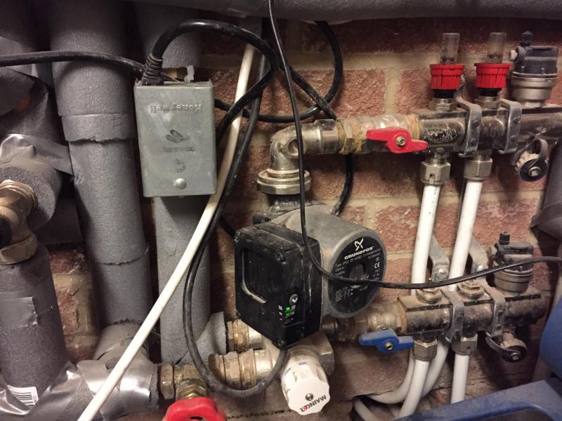

We have a Worcester boiler with UFH downstairs and CH upstairs. The CH and DHW run off a Delta Dore Tybox 827 WRF programmable thermostat (all working fine) whilst the UFH off a Tybox 337 programmable thermostat. Both wired into a standard wiring centre.
The 337 keeps "blowing" and failing to turn off the UFH when it hits the target temp - so we come down in the morning and it's up to 24 or 25 degrees! Delta Dore replaced the first two, convinced their products were not at fault(apparently they NEVER fail). Tested in France and each time the capacitor had gone.
Electrician at a loss. Eventually replaced Tybox with simple generic dial thermostat hard-wired in to "test" it. That blew in one evening. Now everyone at a loss as presumably NOT the controller / thermostat.
Everything else fine - no other electrical issues in house, fuses never trip, DHW and CH both working fine off their Delta Dore Tybox, boiler etc fine. Just the UFH keeps killing every controller!

I appreciate it's a CH system but sounds like there's a spike coming from something therefore the electrical forum may be better placed to advise.
Surprising your spark couldn't trace the problem though, I would be tempted to put a meter on the circuit and recreate the problem to see if there's a power spike being produced that's frying the thermostat?
There's a good chance the pumps causing the problems.
The original UPS2 had a tendancy to blow up time clocks etc
The issues came to light at least 18 months ago.
You could try checking with Grundfoss to see if you have the earlier problematic pump.
