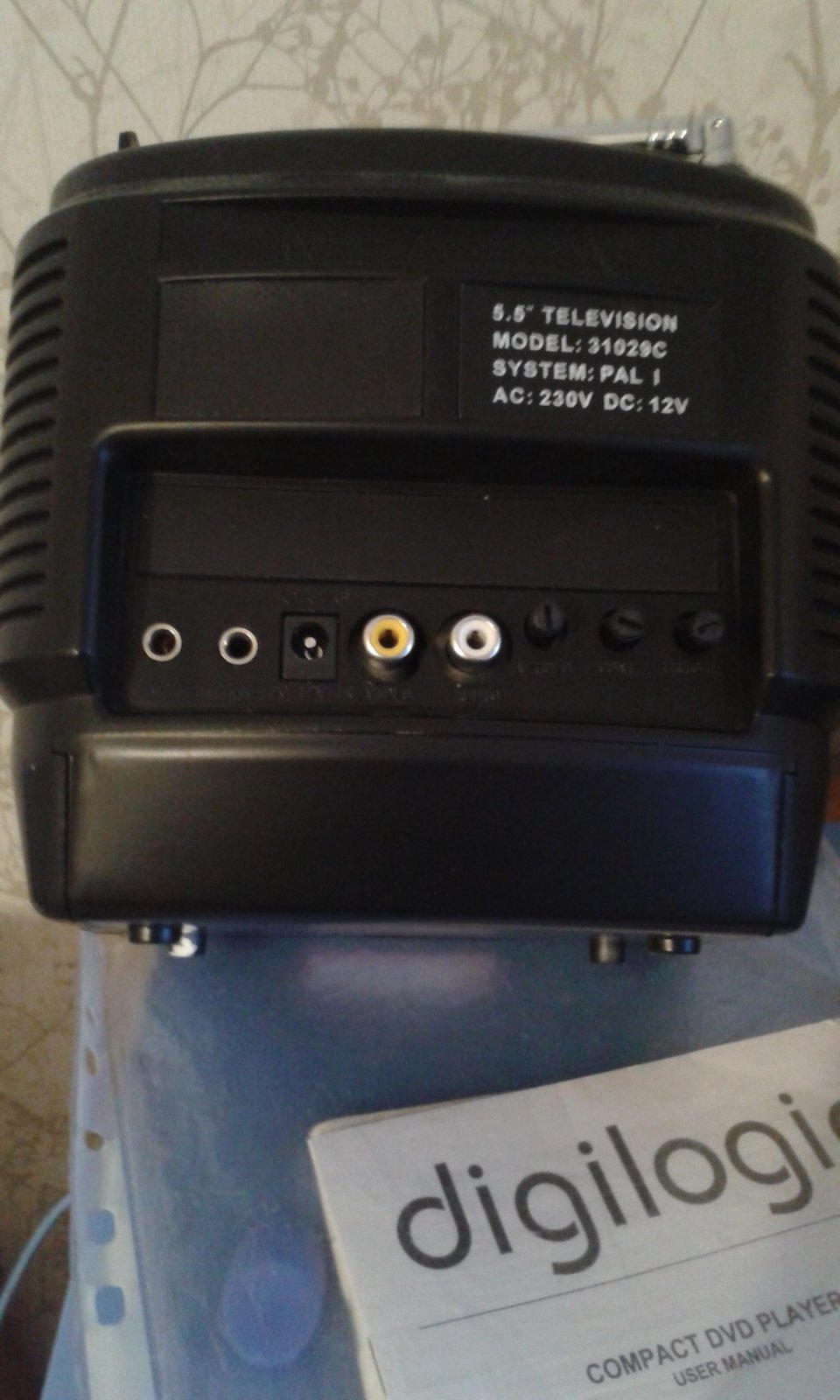

Have new but old 5" screen TV. I need a digital to uhf convertor. I'm quite happy to build a circuit if need be. I'm aware I can buy a digital TV so this if for interest and maybe reignite my electronic days.
Thanks Ray

Thanks to both Sorry for delay. Does this photo help.
Yes, it does. Thanks.
You could use a Freeview tuner box and connect a SCART to phono cable between that and the TV. Yellow is video, white (on the TV) is mono audio. The sound output from the Freeview box will be stereo. You'll need something to convert stereo to mono.
People who aren't familiar with electronics will just use a 1:2 splitter in reverse, like this: If you want a real laugh just read the description. According to the seller's site this "mixes down" stereo to mono, but more than that it creates "simulated stereo" on a mono speaker TV! Ha-ha, that's some neat trick, eh? ;)
Really, what's required is a proper device or circuit to combine stereo to create mono. I have used the Monacor SMC-1 in previous installs. However, if you're handy with a soldering iron and have the time then I guess something like this?
