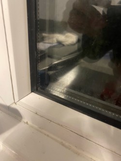

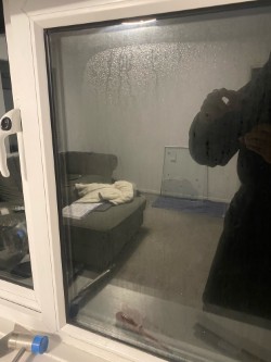

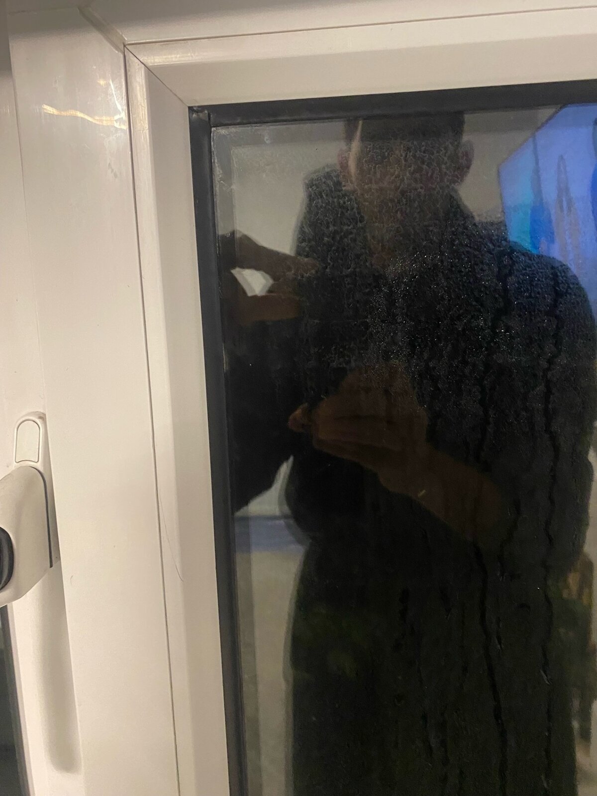

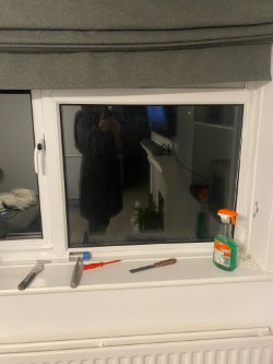

Need assistance on how to remove internal PVC window bead as it won't come off.
I had ordered a replacement double glazing glass and am now trying to replace the glass. First step is to remove the beads. I have tried a number of times and can't seem to pry the internal bead off. I've tried all sides.
I have tried lubricating inbetween the beads when I am able to create a small 1/2 mm gap between the bead and frame but not joy. I've scoured the internet and can't seem to get an answer. It almost feels like something is preventing the beads popping out. No idea what to do next.
Any help would be appreciated!

They don't look particularly hard beads to get out but it's difficult to explain how you pop them out, it's very doubtful but it could be the outer gasket that needs removing, a pic would be help but being internally glazed I'm pretty sure it'll be firtree gasket or a co extruded type which stays in. Because the corners are mitred start in the middle of the longest beads, hammer your scraper right in and lever them out
Just to add to Cranks reply , you may need a second ' scraper ' to act as a wedge when ypu get the first gap appearing. I've had some really tight beads lately for some reason.
