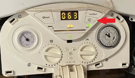

The towel radiator in my bathroom get very hot so I thought I'd turn down the heating flow temperature at the boiler.
My boiler is an Ariston Combi CLAS HE 30. Here is a pic of my boiler controls...
As you can see it has 2 separate dials for heating and water. When I turn down the water dial on the right, the digital display updates with the set temperature. In this pic, the dial is set so the water temp is 50 degrees. However the heating dial on the left doesn't update the screen. As you can see in the pic, the current heating setting is set to zero which according to the manual, should switch the heating off, but the heating is still on.
It's worth stating that I do have a Drayton Wiser system that controls my heating but even with that, surely I should still be able to control my flow temperature here?
Does this indicate a faulty part that needs to be replaced or is it due to my Wiser system?
It looks like you have the Auto function selected? I think this overrides the heating thermostat. The button here switches it on and off.
I would tend to leave it set to Auto though as it automatically drops the boiler temperature when less heat is required.
Yes it was exactly this! I figured this out last night. Thanks for confirming too. I agree I've left it back on auto, at least I understand it better.
