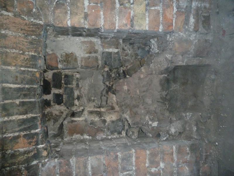

Hi,
In my house there was a fireplace that had previously been bricked up. However, it was done with no vent in the room, and the chimney pot was left exposed. (In actual fact the chimney pot was missing completely) As a result there was a build up of soot and this was then staining the plaster, leaving a horrible patch on the wall.
I previously had the chimney capped, with suitable ventilation.
I've removed all of the bricks that were blocking the fireplace. Here are some photos
Fire Place

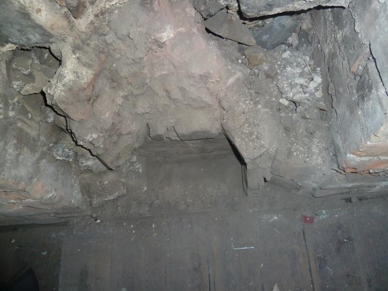

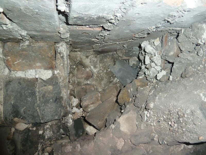

Column of Bricks on the left, which has no support from below
Middle of the fire place, which looks like rubble
You can see that within the fireplace there are two columns of bricks, one either side of the fire place, and then a pile of rubble in the middle. All of this stuff seems very loose, and actually one of the columns of bricks is `floating' in mid-air in that is has not support. from bricks below.
I'm now wondering what I should do with this stuff. My inclination is to remove all of this also. Is it okay to do so? I suppose my main concern is that there is some sort of structural property of the two columns of bricks within the fireplace?
Thanks in advance
it is hard to say by the photos, the main issue is what ever you remove, what is left will need to be structurally supported, this generally by a horizontal lintel.
You do have an arched formed, that will offer some support to the load above but confirmation that this support is bonded suitably to the remainder of structure is very important, I would get someone in to inspect it. Only a few weeks back, I was working with a colleague how had been on a job where a lad that was doing exactly what you intend to, sadly he won't be doing it again!

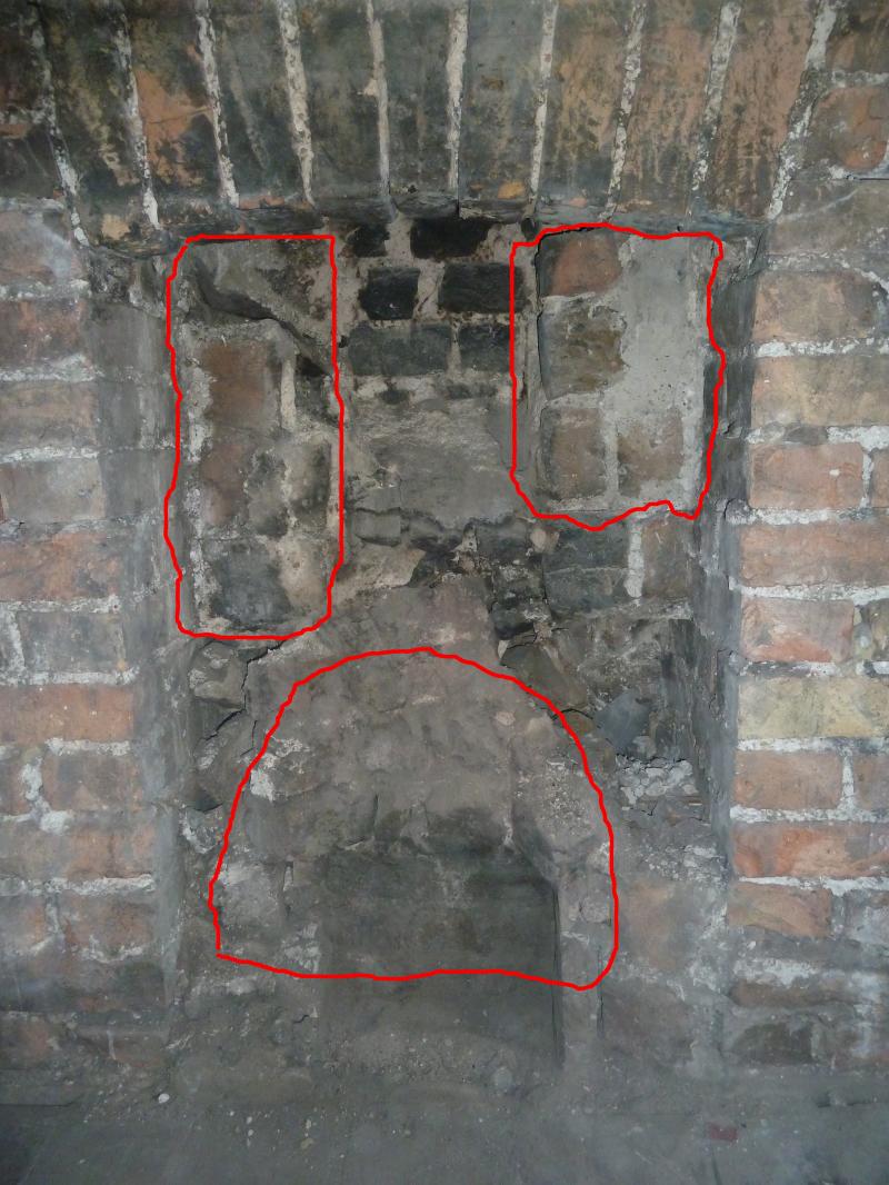

Thinking about it, I think the stuff inside the fireplace is a sort of old fashioned fire back for the fireplace. It is an old house, so I suppose fire backs used to be built from brick. Is that correct? Is it okay to remove a fire back?
OK, so I've edit the first photo so as to highlight the areas I'm talking about.
The two columns of bricks are highlighted at the top, while the pile of bricks/rubble are at the bottom of the photo.
I've had a closer look and these two columns of bricks don't go any higher up than can be seen in the photo. Also, they are only connected to the chimney stack through mortar, i.e. the bricks aren't interleaved with those from the chimney stack.
OK, great. I thought it would be, but I thought it best to double check.
