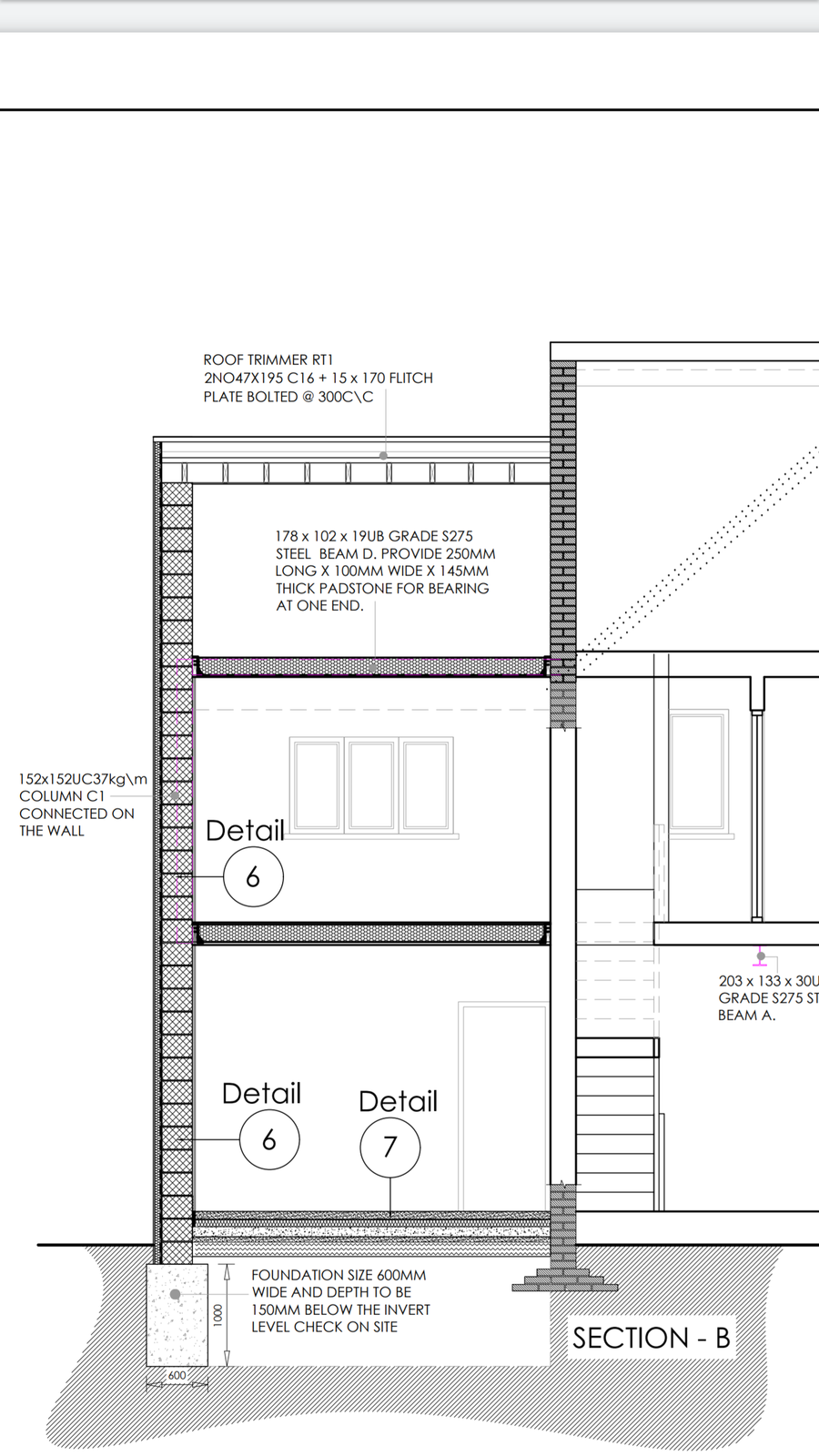

Here is a drawing of the side extension showing the steel column and beam. SE propose plates at the bottom which is then bolted to blocks. The blocks are fitted inside flanges of column. The beam is bolted to the edge of column (not on top) and the other end of the beam is to be fitted into the existing wall of house sitting on a padstone.
The design seems to weaken the house rather than strengthening it. It is also worrying that the ceiling joists run parallel to the beam. Builder and architect assumed it would be perpendicular until we checked the plans.

Find a proper engineer - or one that is not just making work for himself
(The ceiling joists usually do run parallel to the flank wall and in line with the roof rafters (assuming its a normal gable-type roof?) - nothing wrong with that as long as the usual metal straps are added connecting the ceiling to the existing and new walls).
But good luck to the builder trying to fix that windpost!
1. why such a heavy section of column? - wind posts are usually much smaller.
2. How is he going to cut the blocks to fit into the web of the beam?
3. Has the SE heard of cold bridging? - you will get condensation on the room-face of the beam, which will show as a dark vertical line.
4. Bolting the base of the beam will mean the bolts are too near the face of the block; there will be shear force and a bending moment at the base of the column, which the block may not be able to resist.
It would be interesting to see the connection details/figures for the base of the column.
With all due respect to the SE, frankly, IMO this is a poor design, unnecessarily complex, expensive to install, and as much use as a chocolate teapot.

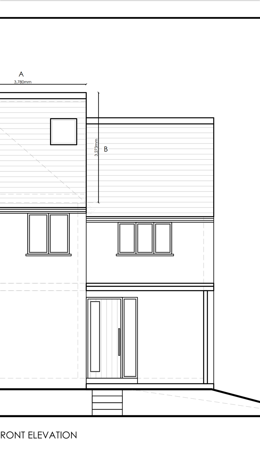

Here is a view of the front elevation. Tony, so the ceiling joists are correct?
