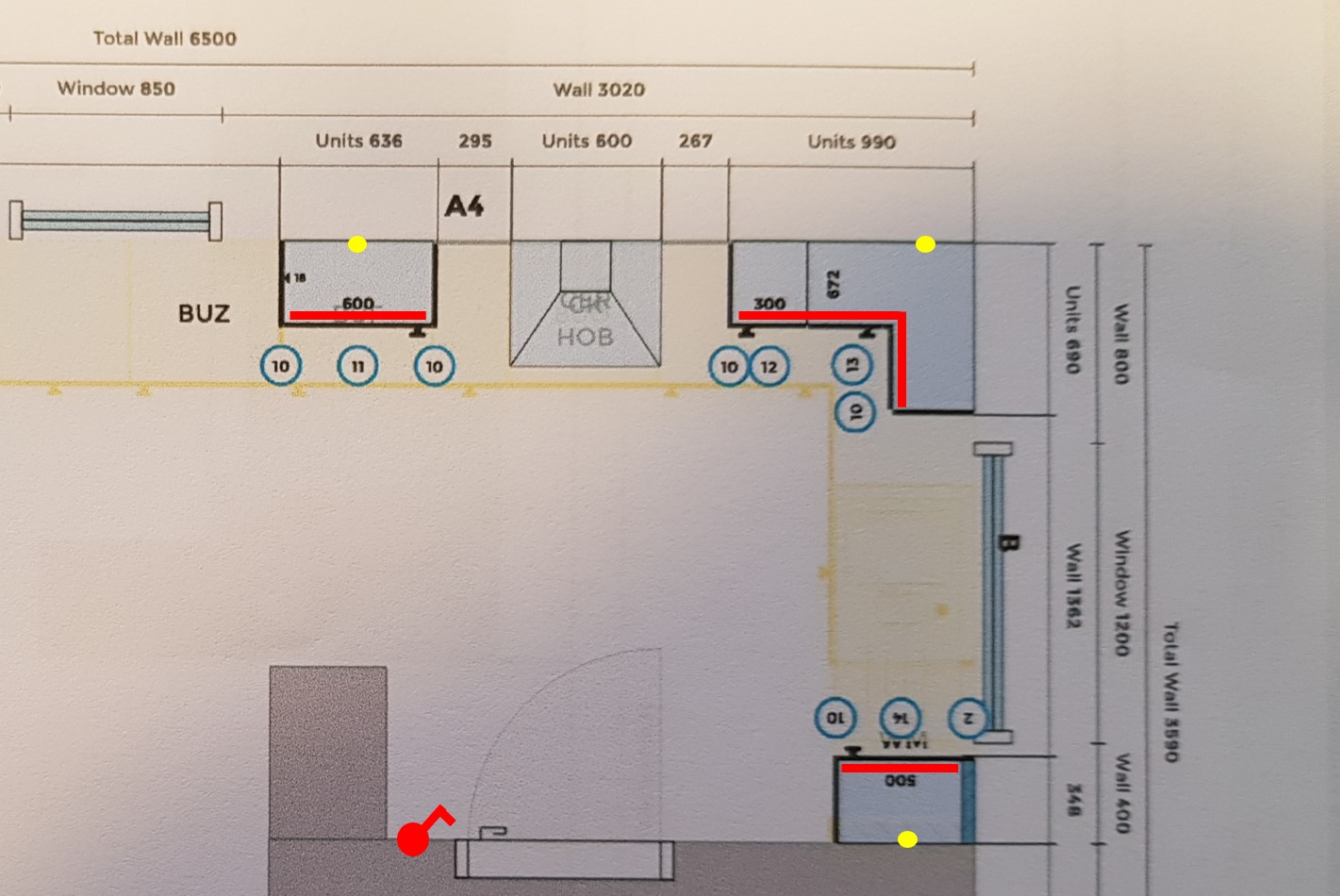

The attached picture shows the wall cabinet layout in my daughters kitchen which I'm re-fitting at the moment.
There is a switch on the wall by the back door which energises cables coming out of the wall just above the units in 3 locations, marked with a yellow circle.
I want to add under cabinet lights at the 3 locations marked by the red lines and the question is are there any recommendations for options as there seems to be so many choices? I think LED strips are the simplest, but not sure about having to have 3 separate drivers as the cabinets aren't together? 12v, 24v or 230v? etc.
Any opinions welcome.
