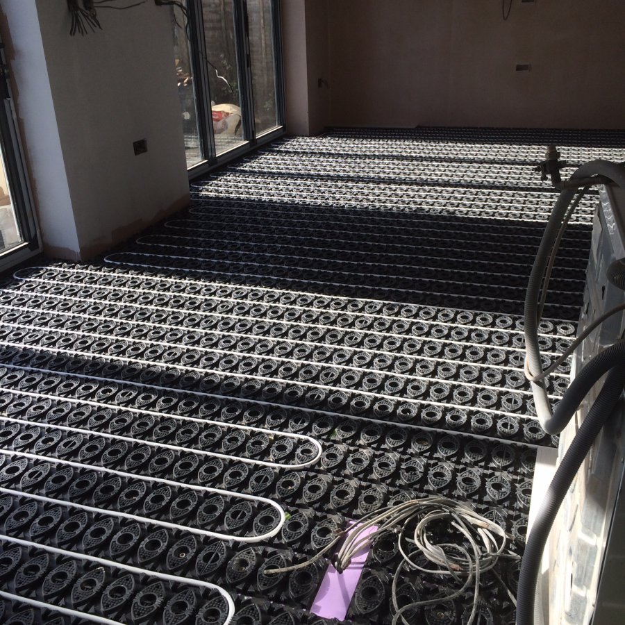

Probably a block and beam floor, they then put Celotex down, clip the ufh to that and pour screed on that.
Pipes should be at designed centres and pressure tested before screeding.
Designing and laying ufh isn't rocket science, but we use a company to design it from drawings just for the reassurance.
You tend to leave the spaces where units are going but it doesn't matter how close to the edge you go as long as you have the edging insulation. Some even concentrate the pipes near double doors etc.
I'm not sure what Tony is blathering on about as I do some of my best work for builders....
The key thing is that I am a dedicated Heating engineer brought in rather than a permanent employee trying to keep costs down.
I liase with the builder's chap to make sure things are as expected.
