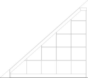

Which might look a bit like this:
Note the fillet in the bottom left corner of the stairs and the flat at the top right (if it's on castors and runs to a point you'll end up damaging the under-drawings on the stairs eventually). I can imagine the doors to be laid-on with no visible framing and no handles (touch-latch opening?). Uprights are 8mm acrylic, shelves 6mm, main carcass 18mm MDF. I think that the proportions of an almost square door are correct in this case. If the plinth is set back and a dark contrasting colour it could look a bit like the unit is "floating"

scrits got it spot on there :LOL: :LOL:
wished i knew how to do diagrams on computer
as scrit says you need to elongate the width of your square [rectangle]to keep the symetry right
as long as you divide the internal triangle [inside the frame from where the points would actualy be]
by an equal amount in this case 5 equal segments along the base and up the side
otherwise your triangles will look poo as they will vary in size

That took about 20 minutes including the conversion to BMP....... It's a tool, just like a chisel or a saw bench. ;)
