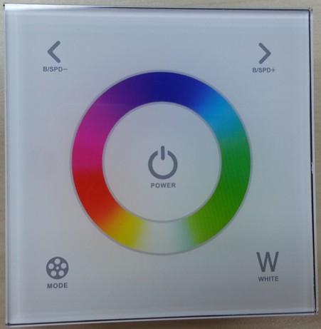

Have you decided on a colour, and brightness? Dimmable RGBW can be handy if you like to vary the mood of the lighting, e.g. if it isn't going to always be only purely functional.
How easy would it be to change the wiring going to the switch(es)? You can get RGBW controllers like this, which fit a standard back-box, but they don't go in the mains wiring to the LED supply.
upload_2018-2-28_11-1-13-jpeg.137408
