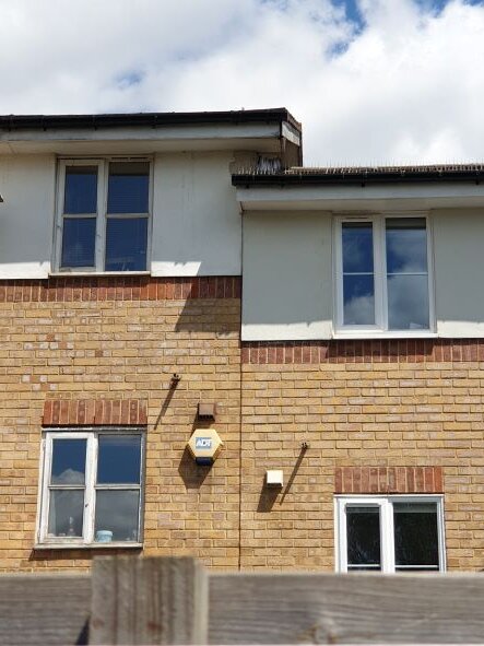

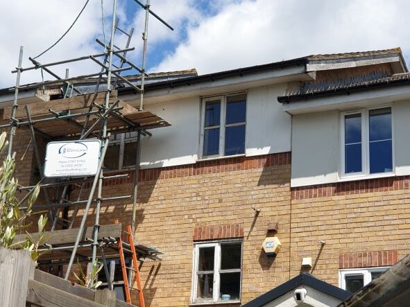

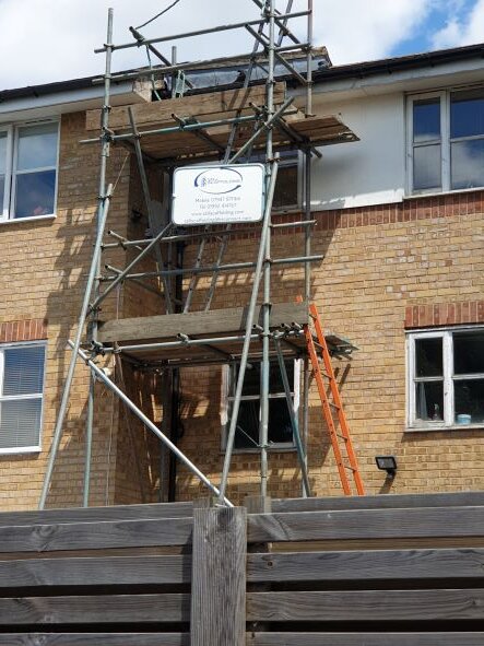

Tx Woody ! 4 photos (A-D) (shows bargeboards w/o the ply - taken off to see state of timber underneath). On left of Photo A is my roof. Scaffold is outside NDN's. Had a roller-coaster morning with a roofer today, who said: ..... barge board is rotten and best replace with UPVC. This wd mean remove all leading. Nothing to be done to the overcloak. £2-2,500 approx. Dry verge not needed. If I want a dry verge & want battens extended, he'd only be lifting 2 tiles (so not a metre, maybe 35cm) and would extend battens from there. He was very sceptical about the need for an undercloak overhang. Not able to give an estimate of cost as it depends on condition of roof once he's got the tiles up. And not interested in the job unless I replace BB with PVC, which in his professional view, is the best route.
BUT the BB timber is NOT rotten, though it may give that impression (as the paint on it IS flaking).
Back to your email: I said my undercloak overhang is minimal; Photo C of NDN house shows his overhang is also minimal. Photo B shows NDN's bargeboards (same as mine & unpainted=neglected over last 20 years, but no evidence of leaking/water patches affecting his house).
But mine has leading (an added benefit) nearly to the bottom of the verge and today's roofer said the leading was in vgc. The mortar on the 'wet verge' of mine also looks in vgc to my untrained eye, i.e. solid & no cracks).

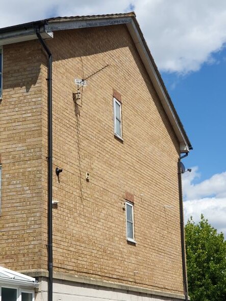

Photo D shows end gable of the 4 houses, in case anyone can recommend a particular dry verge system that suits style, etc.
Following Coopa's post, I moved the satellite cable, so am hopeful it wont be a conduit for rain in future. As he said, this is a small job in the scheme of things, but does seem to have its complications and I'm extremely grateful for your's (& others') help in ironing them out. Very grateful for any views on what type of continuous dry verge to instal.
