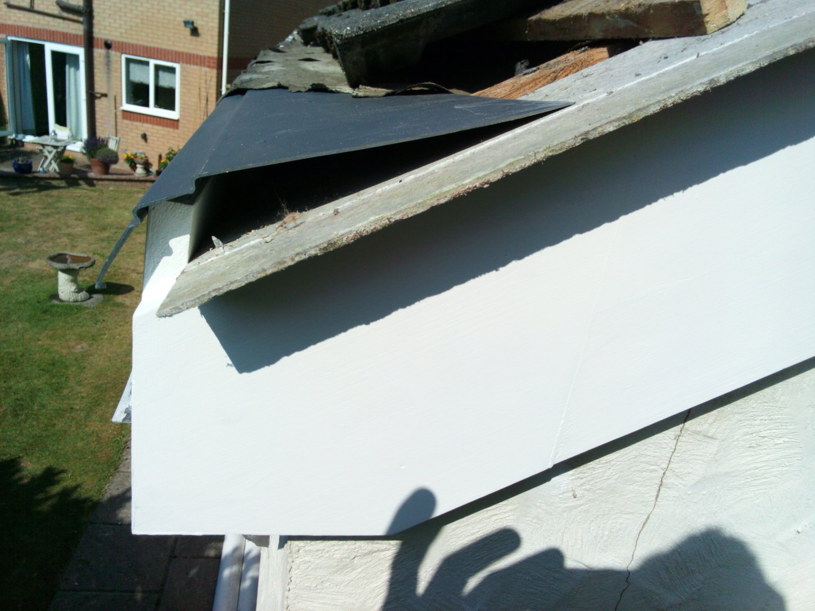

Hi,
Am in the processs of re-roofing my garage, all 4 corners had rotted away due to no tilting filet being installed and water collecting in these areas.
I have cut out the rot and re-spliced new wood, I am going to fit underfelt support trays as pictured but have some questions:
1. Do i fit the underfelt support trays as pictured below with the cement board undercloaking underneath ?
This is how the original installation was (minus the underfelt suport tray) the felt was sagging were the tilting filet should have been and the verge was mortared in with the mortar touching the fascia board.
I don't think this is correct.
2. Do i fit the underfelt support tray as pictured below with the cement board undercloaking on top ?
I release i will have to make an angled wood wedge to fill the gap between support tray and verge board, this would provide a fixing point for the short piece of undercloaking too.
Also new felt under or over cement undercloaking ?
Regards
Piatti

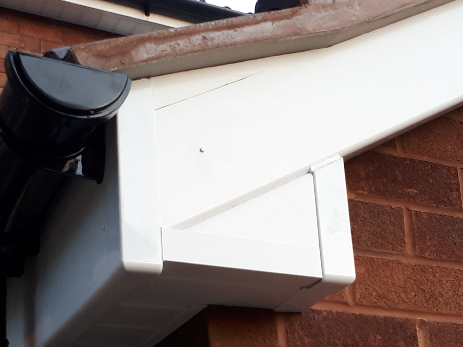

in the second picture I’d first recut that undercloak a bit neater, put your cheese in (wedge) and then see how the eaves tray looks. I’m sure the lads put the trays on top of the undercloak, albeit only a few mm onto it, not all the way towards the end.
Perhaps someone else can confirm.
We always cut and fix a dedicated wedge shaped piece of timber to the top of the rafter, to cradle the cloak at the eaves. It is chamfered from the bottom edge of the first tile batten down to the back top edge of the fascia and provides a seat for the cloak and a fillet for the plastic fascia to fix to.
There is never a neat way of doing a soffit box using plastic. All methods look a wee bit clunky.
