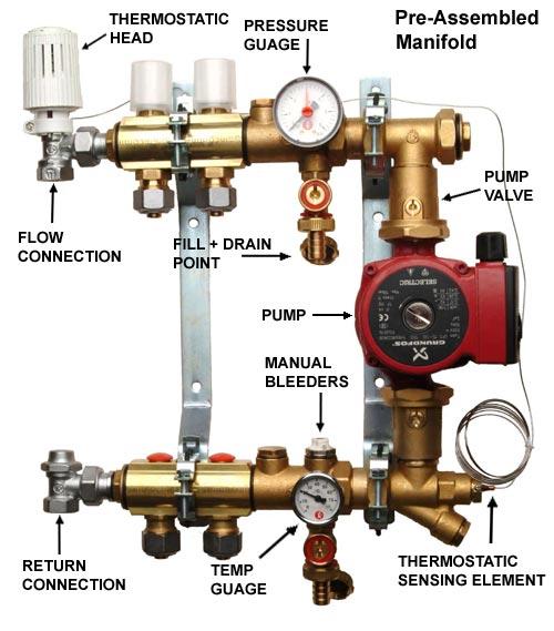

Water underfloor heating can't be just connected to an existing radiator, it needs a special control manifold and separate pump to maintain the temperature suitable for UFH.

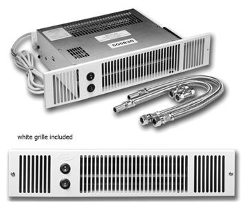

If there isn't room for a radiator in your kitchen, a plinth heater mounted in the base of your kitchen units can be connected to the radiator circuit and contains a small fan to blow the warm air out.
Versions that contain electric heating elements are also available, which are usually cheaper to buy, but more expensive to run.
