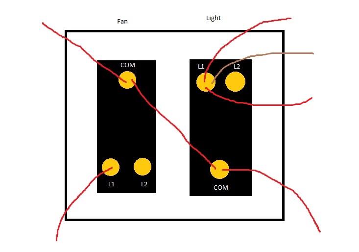

Hi, I could do with some help on what maybe an easy fix.
I have recently moved into a house. I have an issue with the bathroom setup between the lights and electric underfloor heating.
The underfloor heating seems to be wired into a double switch that controls the lights and an extractor fan. The fan operated on it own but when the lights are turned on/off the floor heating also turns on/off with it.
This is rather pointless as the floor is tiled and above an external porch and is therefore freezing most the year, and it takes a good 15 mins for any heat to be felt once switched on. I would like the heating to be powered all the time as I think it was designed to be as you can set your own schedule from the control panel. Every time it is turned off at the moment the schedule is reset.
I have taken the switch off the wall and had a look at the wiring. I have attached a very rough drawing of the rear of the switch. It is not clear to me which wire is coming from where to determine what they are connected to. There are five red wires connected to the switch, another red wire connected between the two COMs and a brown wire coming into one of the Live points.
Is this an easy fix and just a mistake when it was fitted? Should it be connected to the light switch, or is this dangerous?

It looks like you have 3 switch wires coming off the light switch.
The easiest solution would be to identify the feed to the heating and move it to the Common terminal.
But you really need to identify what circuit the heating is on.
Does the lighting go off with the fused switch as well as the heating?

So you think there are too many red wires in the live terminal and one just needs moving to the Com from the light side?
It is no good guessing. It could very well be an independent supply to bathroom with bathroom lights and heating only, it could also supply all other lights in the house.
There is a good reason why it is recommended not only to do a EICR every 10 years but also on change of occupant.
So question one what did the electrical installation condition report (EICR) say?
If you have decided to take a chance without one then at least start at the beginning. Get a bit of paper or note book and switch off all the MCB's or pull all fuses then replace one at a time going around the house finding out where every device is fed from. You may as well do the lot now it will help latter if anything fails you will know where it's fed from.
So next is to report what MCB/FUSE/RCBO/RCD is the lights and heating fed from. Size and type and then people on here will be advising with some back ground not stabbing in the dark.

The brown wire maybe the ufh supply if you remove the FCU you can identify the cable i.e., Brown and Blue ?
The feed to the FCU can be connected to the com terminal that will allow you to control the heating, i assume you have a programer for the heating? The load must be OK for the lighting circuit or the mcb would trip if it was overloaded.
NB you must have rcd protection on the circuit.
