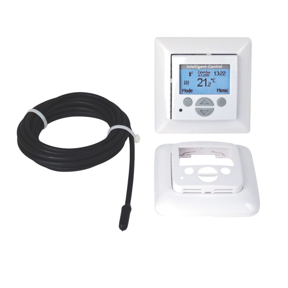

Hi
Does anyone know any details of this satchwell thermostat It needs replacing but not sure with what other than the load is approx 10amps
Many Thanks
Paul
I am sure there are hundreds Klima 825502 Intelligent Control Digital Underfloor Heating Thermostat is one example. Main point is they have two sensors not one.
You will note this one
ae235
comes with the under floor sensor. Rated NTC Sensor 14.2kΩ @ 20°C if your existing sensor is OK you may get away without changing it.

Clearly with underfloor heating one you want room at right temperature and two be able to walk on the floor without burning yourself. When it is laid there should be a pocket which takes the floor sensor. With the one I fitted it jammed and could not be removed.
There are come chemical heating cables which are self regulating but yours looks old so I would not expect to find it is that type.

Thank you both for the reply, I do not even know the model of this Satchwell thermostat only what it looked like when I was last at my daughters so when I saw the picture I borrowed it sorry for causing confusion. Anyway getting back to the problem I have looked at both web sites suggested and as there is a TLC very near to where I live I will get the Sunvic TLM2253. She has only just moved into this flat which has underfloor heating and has 6 of these thermostats,they all look very tired and could all do with replacing its her bedroom stat that's not working so I will change that one first. These thermosats seem to be the only control of the heating not even a time clock.
Thank You for all your help
Paul
I do not even know the model of this Satchwell thermostat only what it looked like when I was last at my daughters ... has 6 of these thermostats,they all look very tired and could all do with replacing its her bedroom stat that's not working so I will change that one first.
Once you get inside (and/or get access to the back) of one of them, I would imagine that it will hopefully tell you what model it is (and maybe some other useful things). Make sure you make a careful note (and/or take photos) of 'what is connected to what' before you disconnect it!
