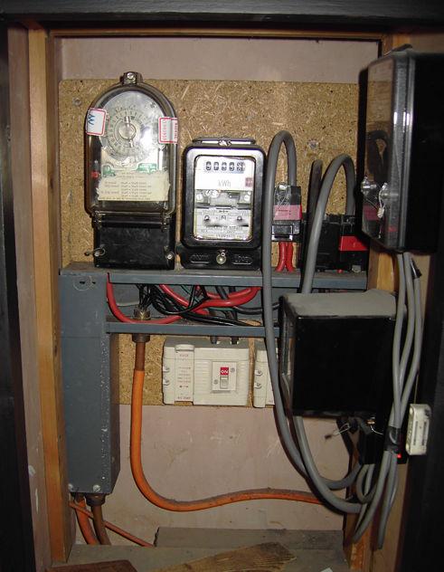

My heating system was installed when the flat was built (c. 1970). It consists of electric elements embedded in the concrete floors. There are four zones - each is controlled by a simple 'Satchwell' bimetal strip thermostat.
The electricity for the heating is metered separately from the rest of the flat. It was controlled by a timeclock in the meter cupboard.
The timeclock died a few years ago (it stopped during an 'off' period). I told my supplier and a man came and moved it onto an 'on' period - so now I have 24hr cheap electric for heating :)

The meter facing us appears to have only one register, most likely peak-rate. But what is that glossy black thing to the RHS of your meter box photo?
Looking at your electricity bill, are you on a single-price tariff, or on something like an economy 7 rate?

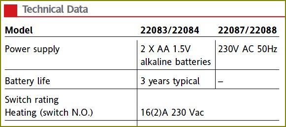

I eventually went with the Drayton Digistat +3 (battery version - model 22083) http://www.draytoncontrols.co.uk/Digistat3ProgrammableRoomThermostats.aspx, mainly because I dropped on a couple of second-hand ones that were a good price (I didn't actually make a decision to go for a battery-powered 'stat, I just saw these and thought that they were a bargain).
They have yet to be fitted. :oops:
They appear to be adequately rated to handle the switching required for any of my heating zones

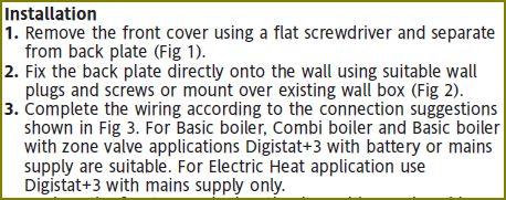

but I was concerned by the last sentence of step 3. in the installation instructions:
So I emailed Drayton with this query: "This thermostat is capable of switching mains voltage at currents up to 16A - why, then, do the installation instructions say that the battery version shouldn't be used for electrical heat applications?" They were very helpful - they explained that because of the relay type used in these thermostats, if the batteries failed while the heating was 'on', the heating would stay on continuously thereafter. Presumably this is because these 'stats use some kind of latching relay. I could see that this might be a fire risk for wooden floors, but as mine are concrete, I thought the risk for me would be very small.
This meter is controlled by the timeclock next to it. It supplies my underfloor heating only - on a restricted hours tariff.
That is the radio teleswitch, I believe. It controls the meter below it (two register) and switches between 'normal' (day) and 'low' (night) rates. This meter supplies everything except the underfloor heating in my flat.
