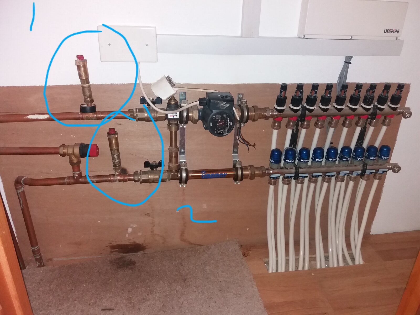

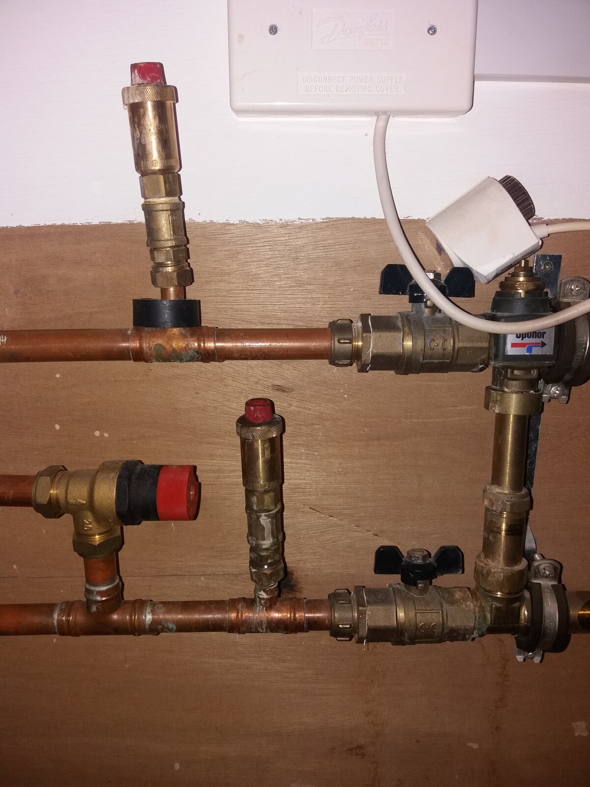

Hi hope someone can help me with some advice before I call someone out. We have Uponor underfloor heating with a pump upstairs & one downstairs. Each room has a separate thermostat to control heat. We have an oil boiler which keeps dropping pressure but is not locking out. Heating & hot water are working (touch wood!). The upstairs pump I have heard loud clanking noises from & when I look at the pipes as marked on the photo (1) is wet & the other (2) seems to be leaking quite a bit & the carpet is wet so could have been going on a while. Could this be the cause of the low pressure? Does anyone know what this part is & what it does? Thanks

They are automatic air vents and they leak for fun, screw the red caps down to stop them leaking and then get someone in to replace them
