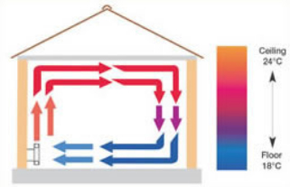

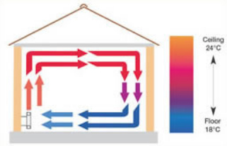

What ever type of heating is used, it is the losses that matter. Three ways to loose heat, convection, conduction and radiation. Well also a forth simply pumping the heat outside. Unless using inferred heaters loss by radiation is unlikely, so first consideration is air changes, we need air changes, but we want to reduce heat loss, so heat recovery units are the way to go so still have air changes but reduce heat loss.
Convection is not so much as a problem today, when we had single glazed windows we wanted to reduce air movement near to windows, I had in the late 70's a house with warm air central heating, cost a fortune to heat as the fans circulated the air past the cold single glazed windows, where when using radiators you get a convected flow. circulation.jpg
So position the radiator 90° from window and the area by the window can remain cold, but the rest of room can be quite warm, we are told to fit thermostat on opposite wall to radiator so in the air flow, but does not get direct heat. I know with mothers living room thermometers placed around the room could measure 18°C to 28°C in the same room at the same time, due to how the thermals circulated the air, and also the way the sun shone through the bay window.
For that room speed was the essence, we needed a fast acting heating system, I used an electronic TRV head to speed up reaction time when the sun came out. For that room UFH was a non starter, however the other rooms did not heat up so fast.
Kitchen in the main has some other form of heating, so again we use some thing fast acting, fan assisted kick space heaters for example.
So the aim is not to over heat any room, but there are more ways than one to skin a cat, and careful timing can reduce losses, so if cooking at 5 pm set heating to stop at 4 pm in kitchen. Some town houses are in shadow all day, they get light but no direct sun light, my last house the semi-detached neighbour was to South, so house got very little heat from sun.
