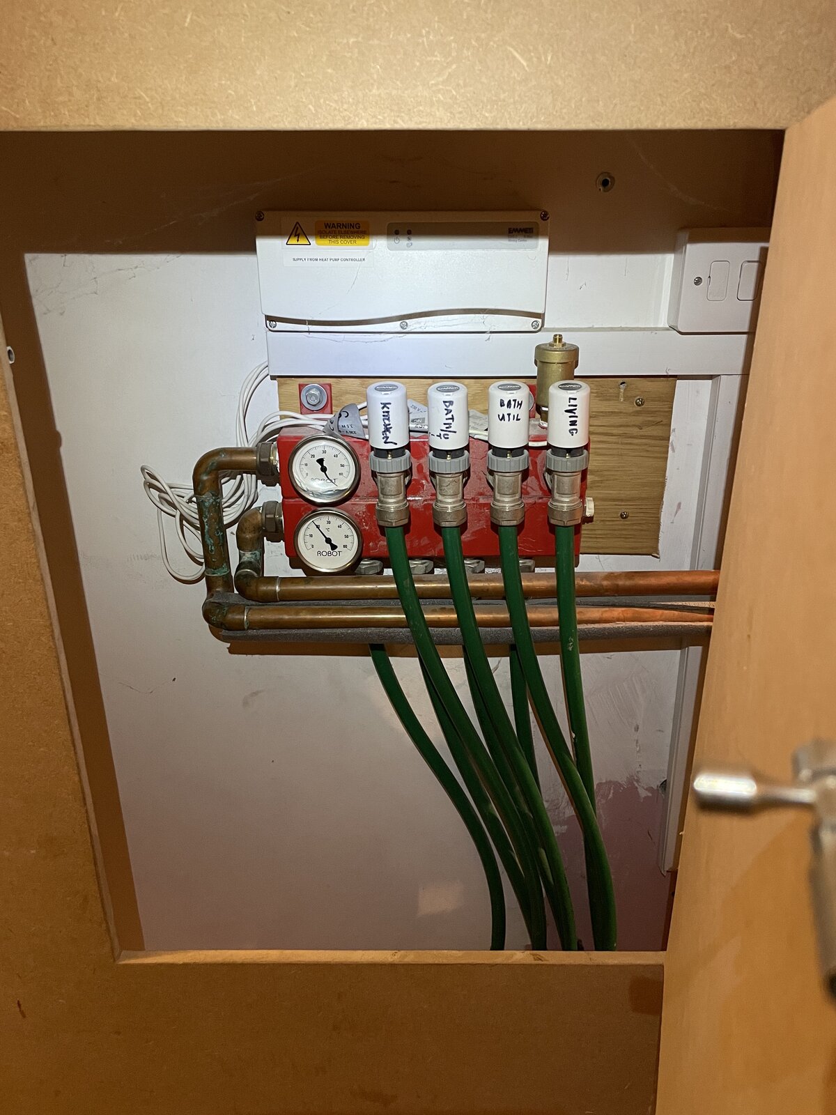

The system is fed from the hot water boiler. There are two manifolds, one for upstairs and one for downstairs. Both manifolds have pump which drives the water into the manifold.
Upstairs, we have no problems with.
Downstairs has three zones, Kitchen, Living Room and Utility/Bathroom.
The Manifold is shown in the Manifold_PreStart.jpg file which is how it looks when no heating is on.

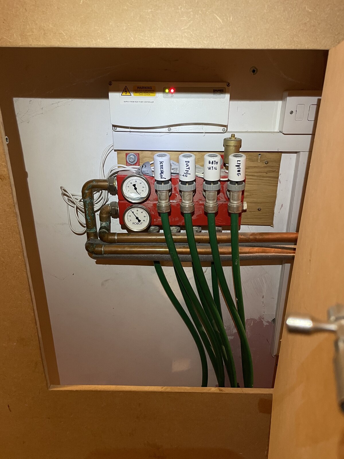

Heating comes on at 6pm and at that point, the pump starts, shown by the red light in the Manifold_PostStart.jpg image.
A few minutes after starting, we get a thumping noise seemingly from the manifold but it is difficult to exactly pin down. I have a video of it which is on YouTube here:
- noise starts about 55s into the video. The thumping lasts a few seconds, probably less than 10 and is kinda juddery in nature, its sort of a duh-duh-dumm, duh-dumm.
The past few days I have been experimenting with different zones demanding heat via thermostats and when a single room (e.g. the kitchen) is the only one demanding heat from the system, then there is no juddering or thumping.
Only when multiple rooms are demanding heat, does the noise occur. For example, today, we had the kitchen and the utility requesting heat and the thumping happened.

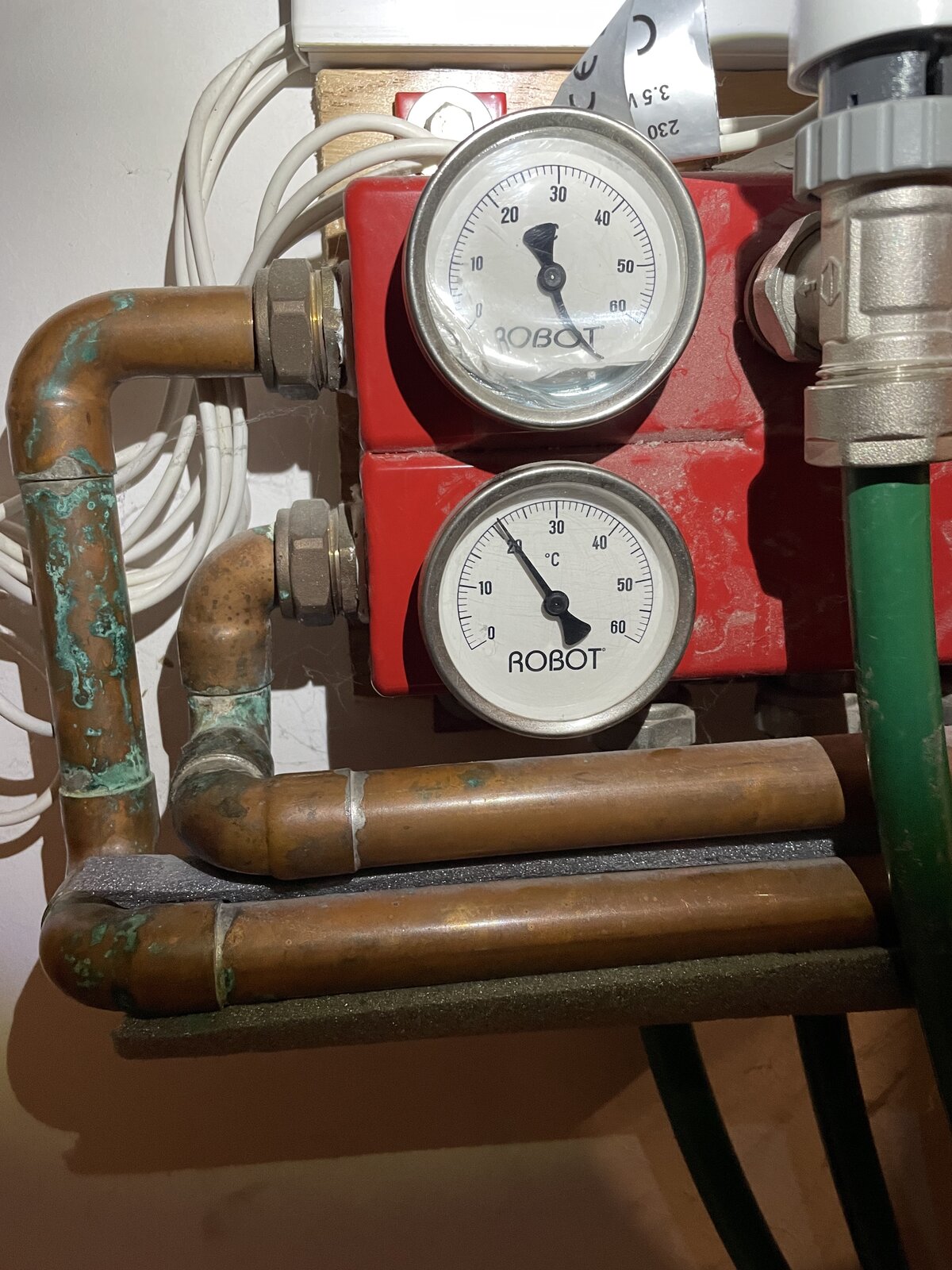

Another thing with this downstairs manifold is that the top "Robot" dial is warped a bit. This dial seemingly measures temperature of the water going into the system. See Warped.jpg. Any idea why this could look like this?
