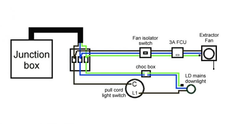

I'm installing a new under stair toilet. Previously from a junction box in the vicinity,
a light with switch was wired up, I've just used the same cable from that box.
The junction box is shown on the left of the picture below.
I've added a second small junction box to run an extractor fan and a new mains LED ceiling light from.
The fan is not timed, just works on a pull cord. The light will have a pull cord for operation as well.
As the fan and LED light only need live and neutral I'll use terminal blocks to terminate the earth cables.
I've read quite a few threads on the forum, but can't convince myself that I've wired it all up correctly,
so advice would be greatly appreciated. Cheers.

If that was a switch drop cable it won't work, as there won't be a neutral present.
I doubt that Building Control will accept that - they'll want one with a timed overrun which is triggered by the light.
Also, although the electrical work per se is non-notifiable, as it's part of work which is, be aware that they might want proof that it complies with Part P.
You can't use a choc-box as shown, as it won't fit into the light switch, and therefore you'll end up with exposed single-insulated wires.
You haven't.

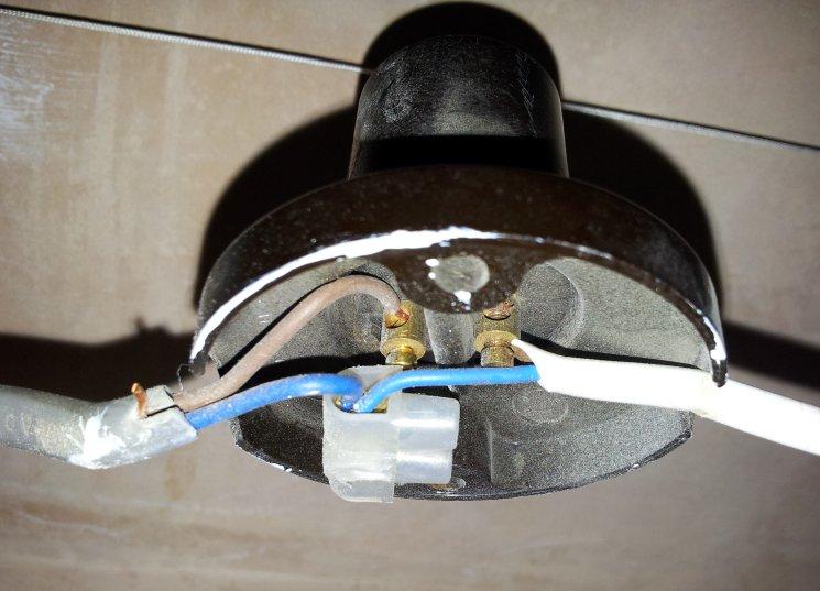

The existing light is still wired in place, I've taking a photo of how it's wired up.
Grey cable coming from junction box, white cable to a small door activated stitch.
Does this have a neutral?
OK - looks like it does, but either the neutral is switched or the wrong colours are being used from the JB.
It also has no earth continuity - you MUST rewire it so that it has.
I will ensure earth continuity.
Is it easy to visually check that the neutral is switched?
or do I need to get my multimeter out and remind myself how to use it?
Not seen a fitting like that before: what does the rest look like OOI?
EDIT: If that terminal in the photo with the blue conductor attached is the return from the switch, then (with power off) put your multimeter (set to continuity) across it and the cpc in the grey cable. If the blue wire is neutral, you should get some indication of continuity.

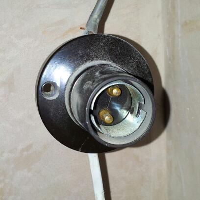

here's the front of it
Seen plenty of old fittings but not one like that before. Thanks for posting the pic.

I turned off the power at the consumer unit.
Opened up the junction box, the earth wire in the grey cable seems to connected to earth in the JB.
I put the multimeter in continuity mode, and located one probe on the blue cable junction,
I located the other probe on the earth cable seen poking out of the grey cable in the first pic. Result, no continuity.
Not sure I'm doing this right :confused:
Almost at the point of calling in a professional.
