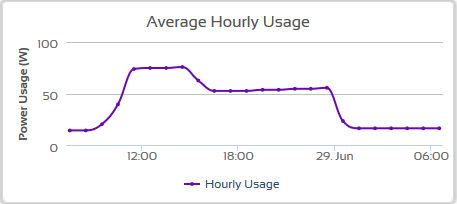

However at 15 watt, and 13p per kWh it will cost 4.68p per day to be sure not to miss a program, I can measure how much power my charger uses to charge my caravan battery Caravan-battery6_28-06-20.jpg but why bother, as it needs charging, so does not matter how much it uses, I have two options, throw it away or charge it, so since I need a battery in the caravan I will charge it, does not matter how much it uses.
