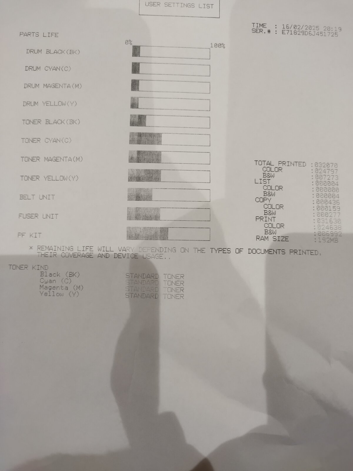

But the print quality is poor. Below is a parts life print out. Something must need replacing, replenishing or servicing, but I'm not sure what. Is anyone savvy with these beasts?

Which way do those charts read for remaining life? Is the grey part the amount remaining or the amount used?

The drums are what transfers the image to the paper, and therefore will be in contact with every single sheet of paper that has passed through the machine.
It claims to have done 32000 pages, most of which were in colour, so if original those drums are well and truly life expired.
I'm not sure about the others, but the toner ones are amounts remaining.

I'm not sure what those linear scales on my paperwork mean, but it's not right at the end, so there must be some life left in it.
I accept that the drums may need cleaning, but having printed off a drum dot check sheet with no coloured dots showing, this suggests the drums do not need cleaning.
