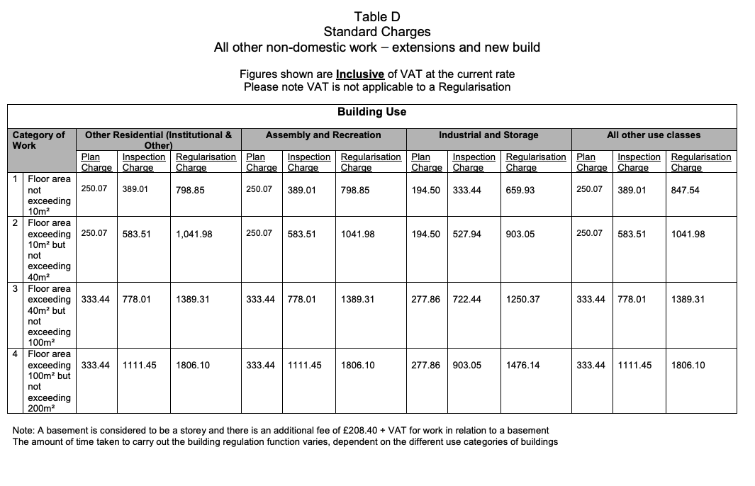

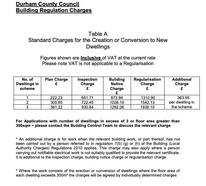

I also had this confusion over the different things/ways you can go about this. An excerpt from my local council's fees list (link above):
Though they do try to explain e.g. Building Notice = Plan + Inspection I'm left a bit in the dark what it all means. I get the impression especially for a new building you can essentially get pre-approval subject to an inspection to do what you said, OR you can just do it and then they have to figure it out afterwards if it's up to spec. Is that what all this is about?
Just trying to figure out what the council will charge is hard enough! Especially because it's not a dwelling per se, but is a separate building. Heated and used during the day but not slept in, etc.
So whether we would be subject to the above table or this one, is one we've been waiting for 3 weeks to find out... we submitted an online request and as yet they haven't told us what they will charge us, let alone how long the process might take!
