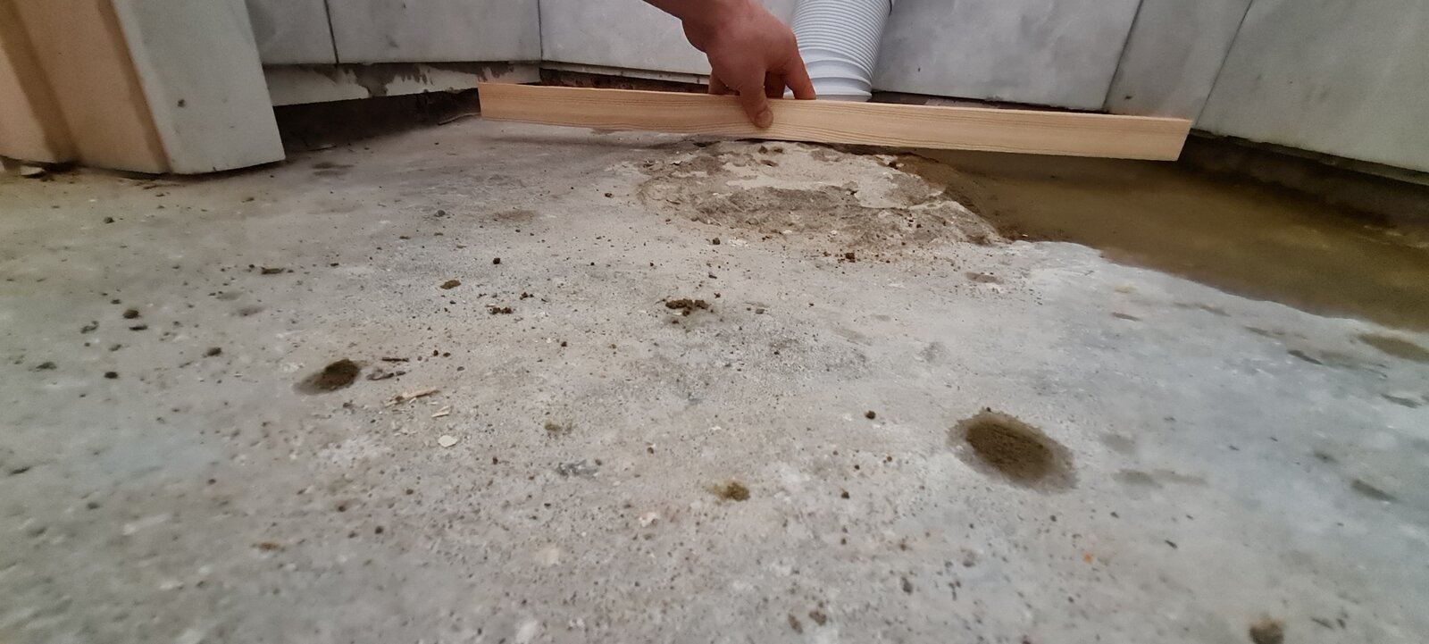

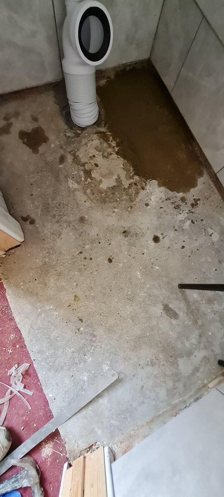

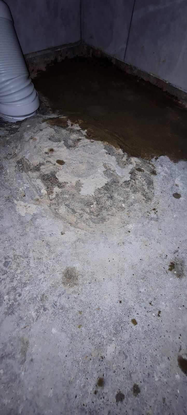

Hello guys, how would you go about this one i wanted to tile the floor but as you can see some idiot wanted to raise the toilet using concrete now i have a concrete shaped toilet on the floor making the whole thing awkward to tile

Run an angle grinder through it making many score lines to it's depth and chip it off.
