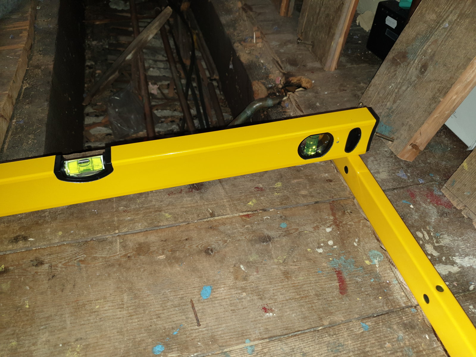

Hi all, I've just stumbled across this forum and am hoping someone will be able to shed light on the issue in my home.
Whilst buying my house, we noticed the floors seemed uneven. I paid for a full structural report via the bank and asked specifically for this to be inspected.
When I called up, I was told the floors were all fine, but they sounded quite clueless when I did ask, almost as if they were blagging.
The issue is the entire house feels as if it's sloped. The other day I ripped out the carpet and pulled up some floorboard in one of the rooms, and I'm now not sure if the joists are causing the slope.
My concern is it's not isolated to a single room, it's basically the entire house, upstairs and downstairs. It also seems as if the directions of the slopes vary, as the kitchen slopes in a different direction to the lounge.
I'll attach some pictures later when I can get back under the floorboards, which may help visualise the issues.

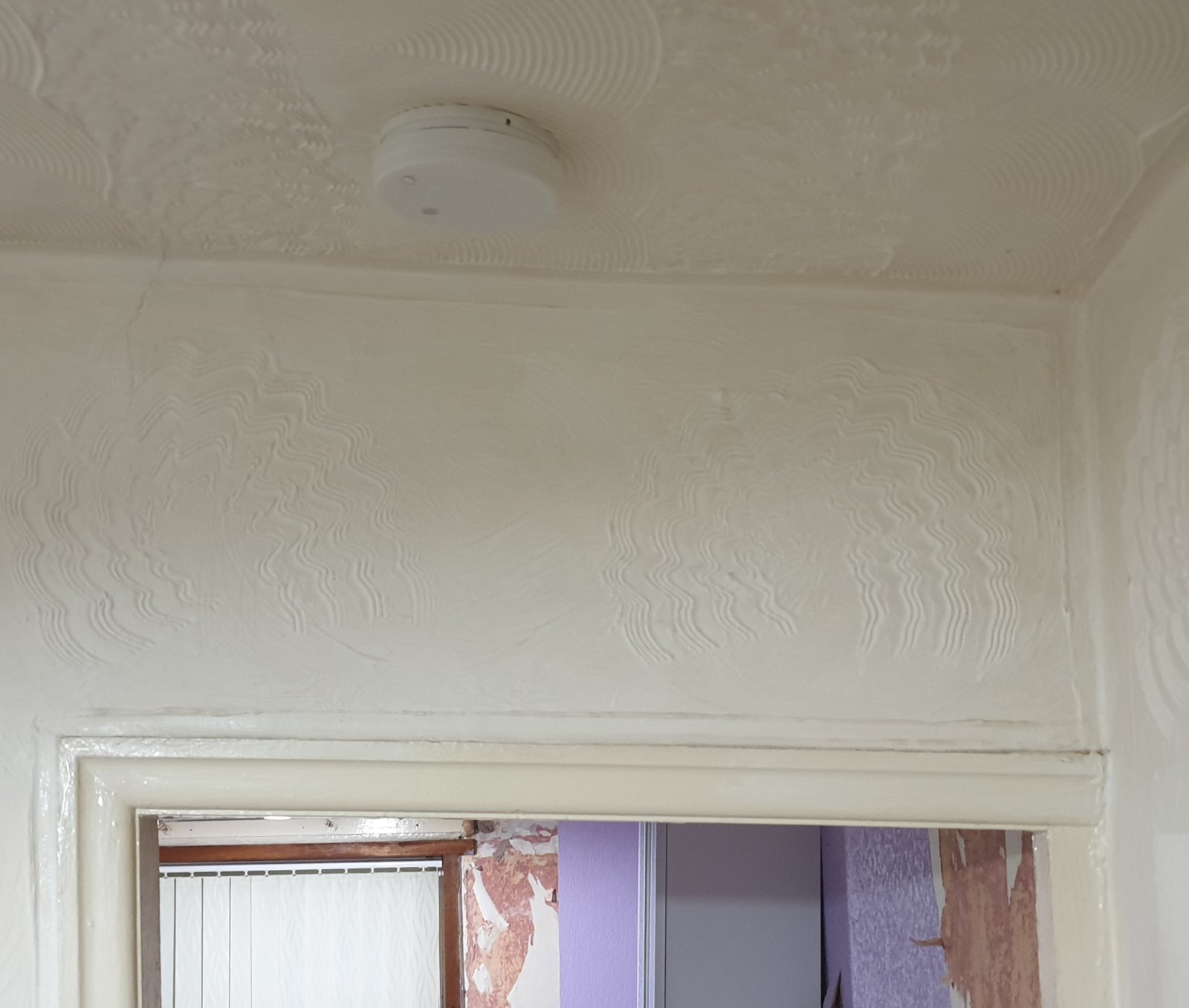

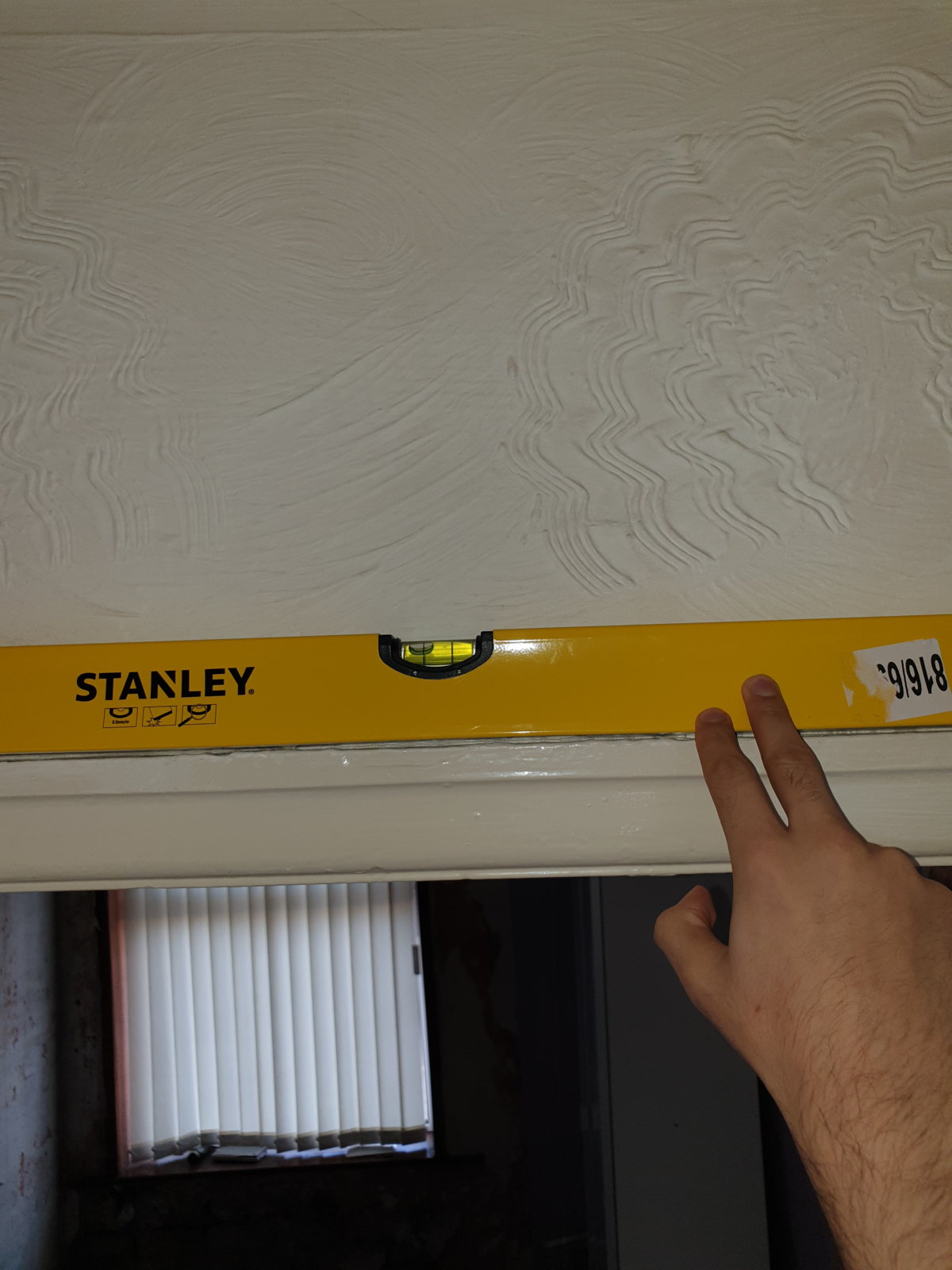

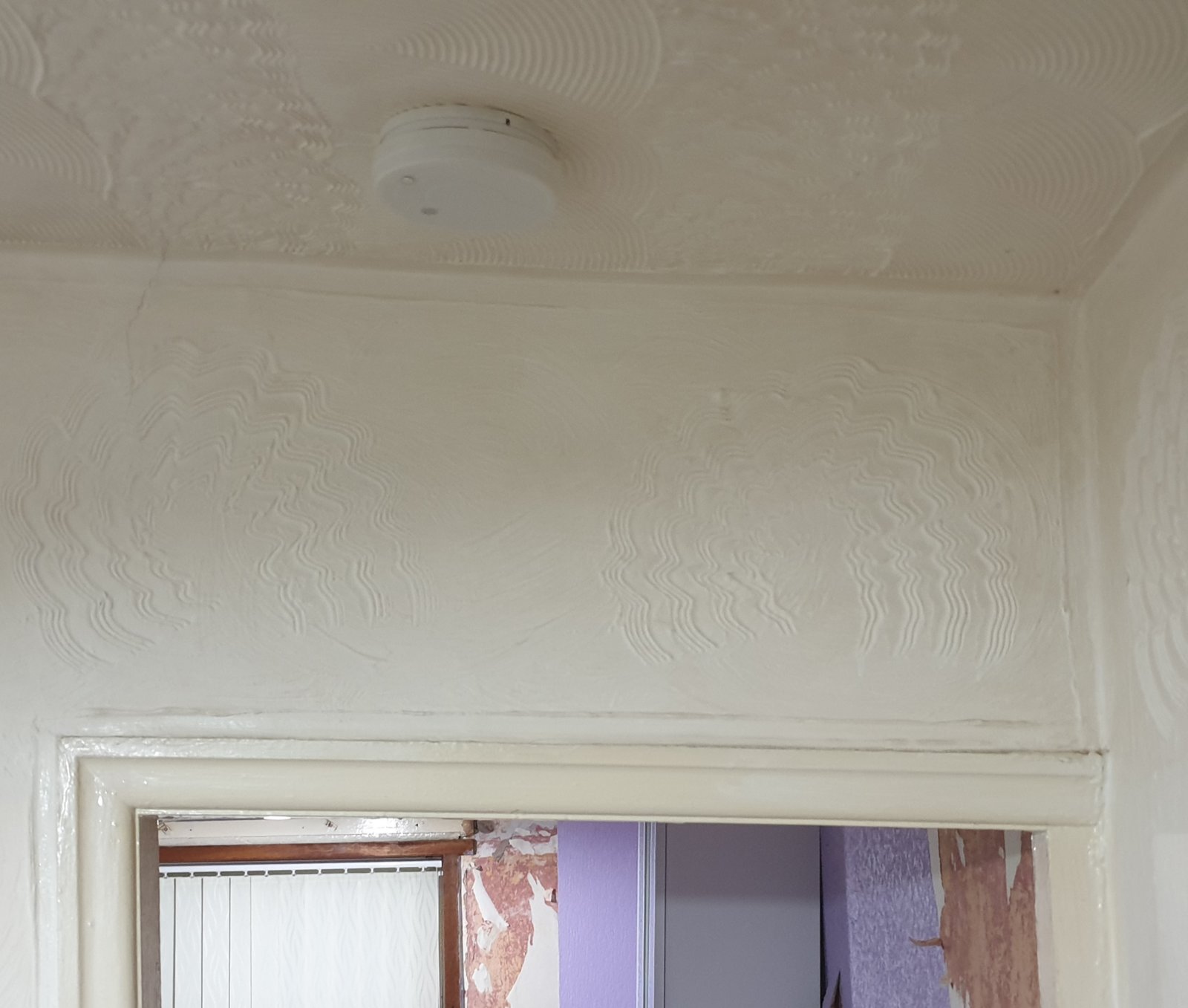

Here you can see, the top of the door frame is very slanted towards the right.

Have you checked the levels with a 6ft spirit level? Are you sure that it's not just sag (which happens in all old houses)?
3 degrees is quite a lot when you stretch it across a room- 50 mm/metre. The suspended timbers may well have gone baggy with age (so dip into the middle of the room), the whole house may have moved a bit over the years & might have had a good nudge from Adolf's bombers. Have you tried a plumb line by doorframes or in the corners (spirit levels aren't that useful for vertical)
For the floors you need a long straight edge, 3m or more, a good piece of floorboard or skirting is favourite. While the house is empty & ideally when there are no carpets down lay it in various places and look for gaps and high spots.
If there aren't any (or not many) then again use your straight edge with the level on top and some shims (plastic ones for fitting double glazing are perfect, they have the thickness stamped on them). Set the straight edge so it is showing the greatest out of level, then shim the low end until the bubble is in the middle. Repeat a few times, record the results
And then decide what, if anything, you want to do about it. Provided the joists are in good nick (no woodworm or rot evidence, check carefully where they enter the walls), sloping floors are an irritant rather than a disaster. Rectifying them can be a pain, since you'll probably wreck the T & G floorboards when you lift them.
I'm with Foxhole. Door frames are zero indication of the state/levelness of the floors. They can indicate movement or settlement, but to verify the floors you need either a long level or a laser level and a block. With either it will take me about 5 to 10 minutes to ascertain how far out the floors in a given room are (but a lot longer to figure out what I want to do.....)

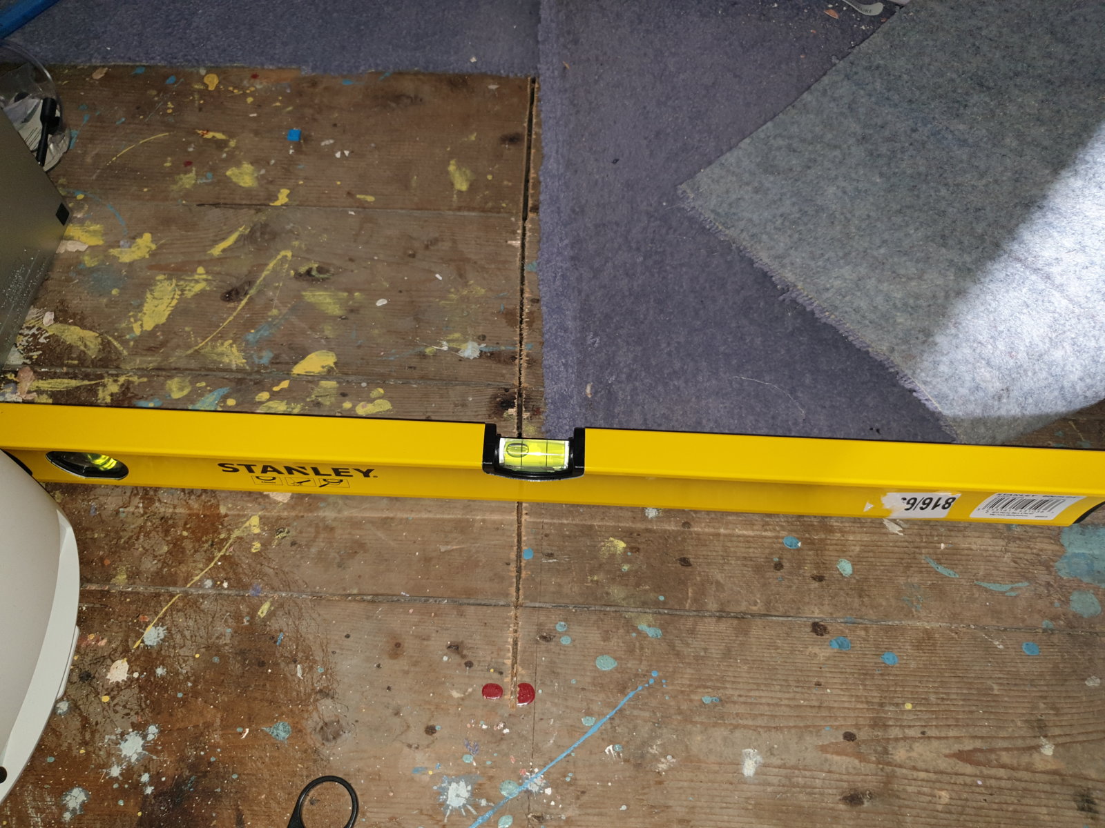

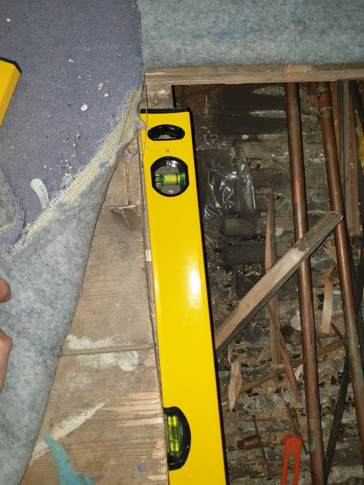

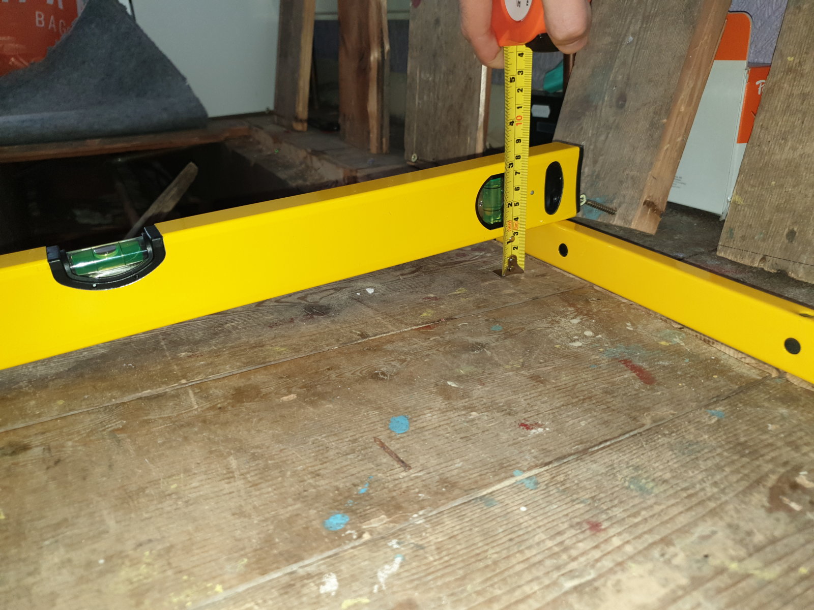

Good afternoon,
I'd like to think it was just an uneven doorframe, much cheaper of a fix!

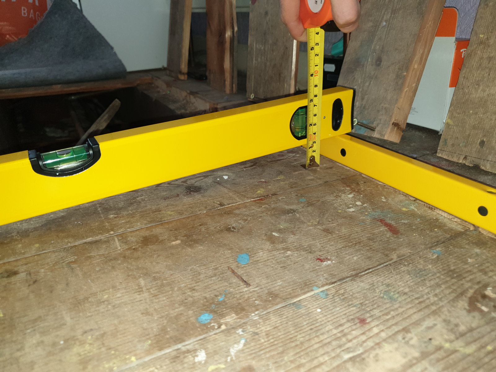

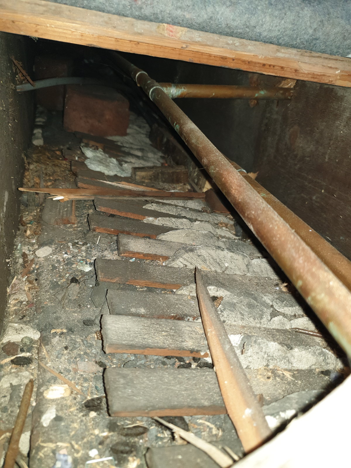

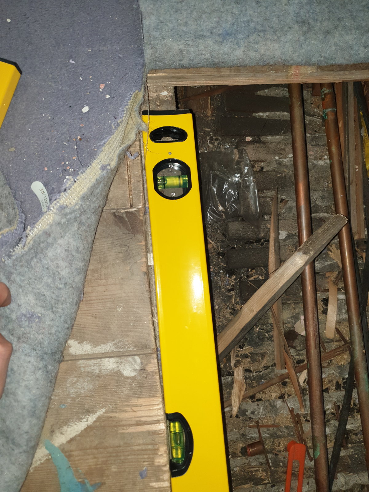

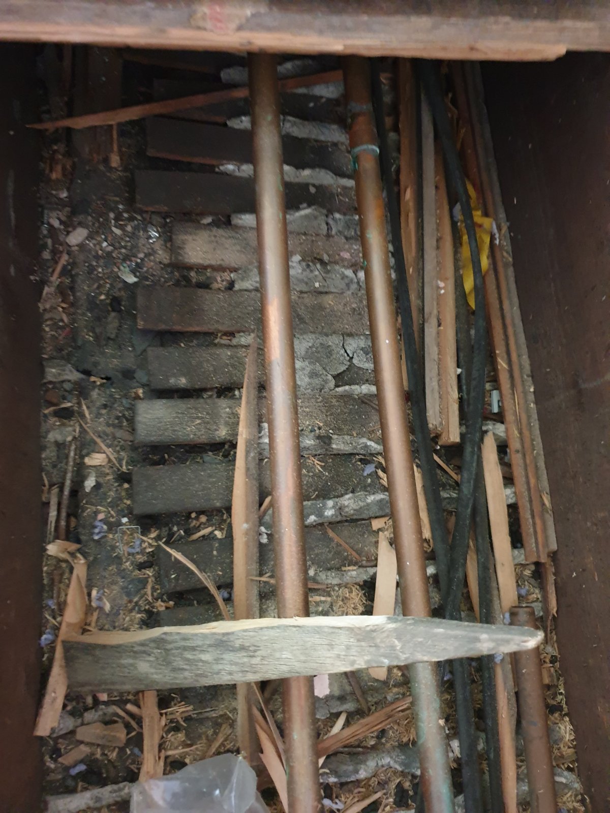

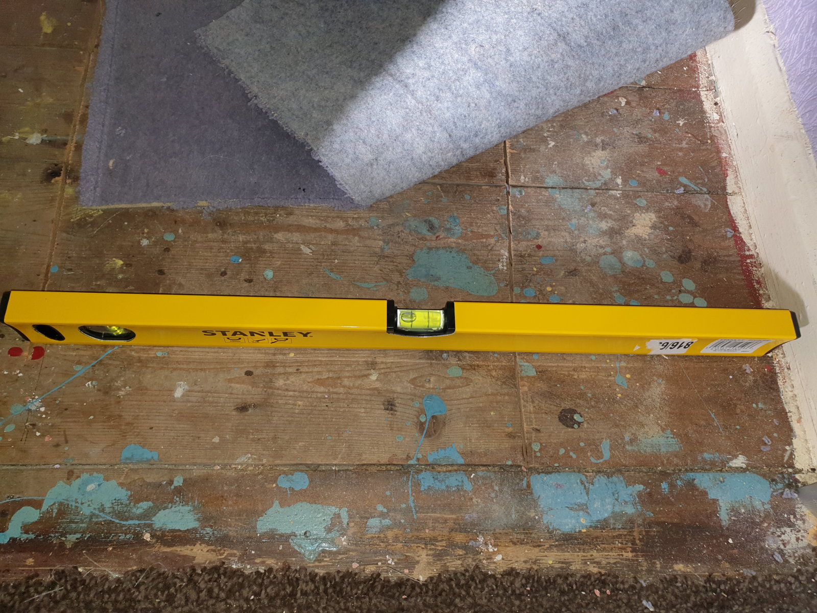

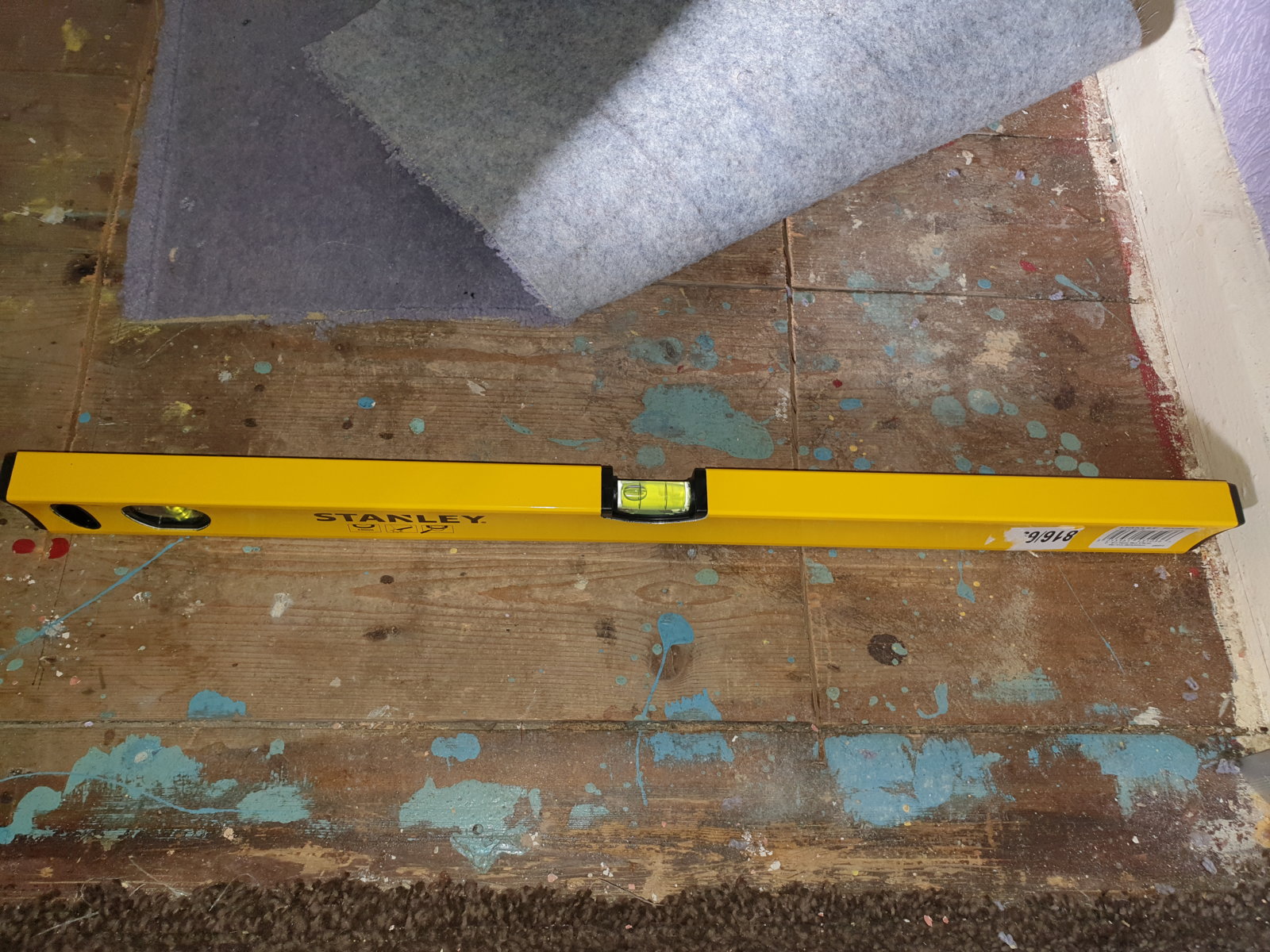

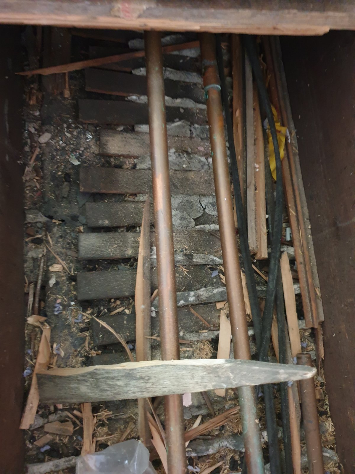

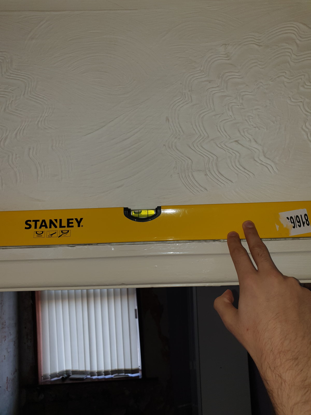

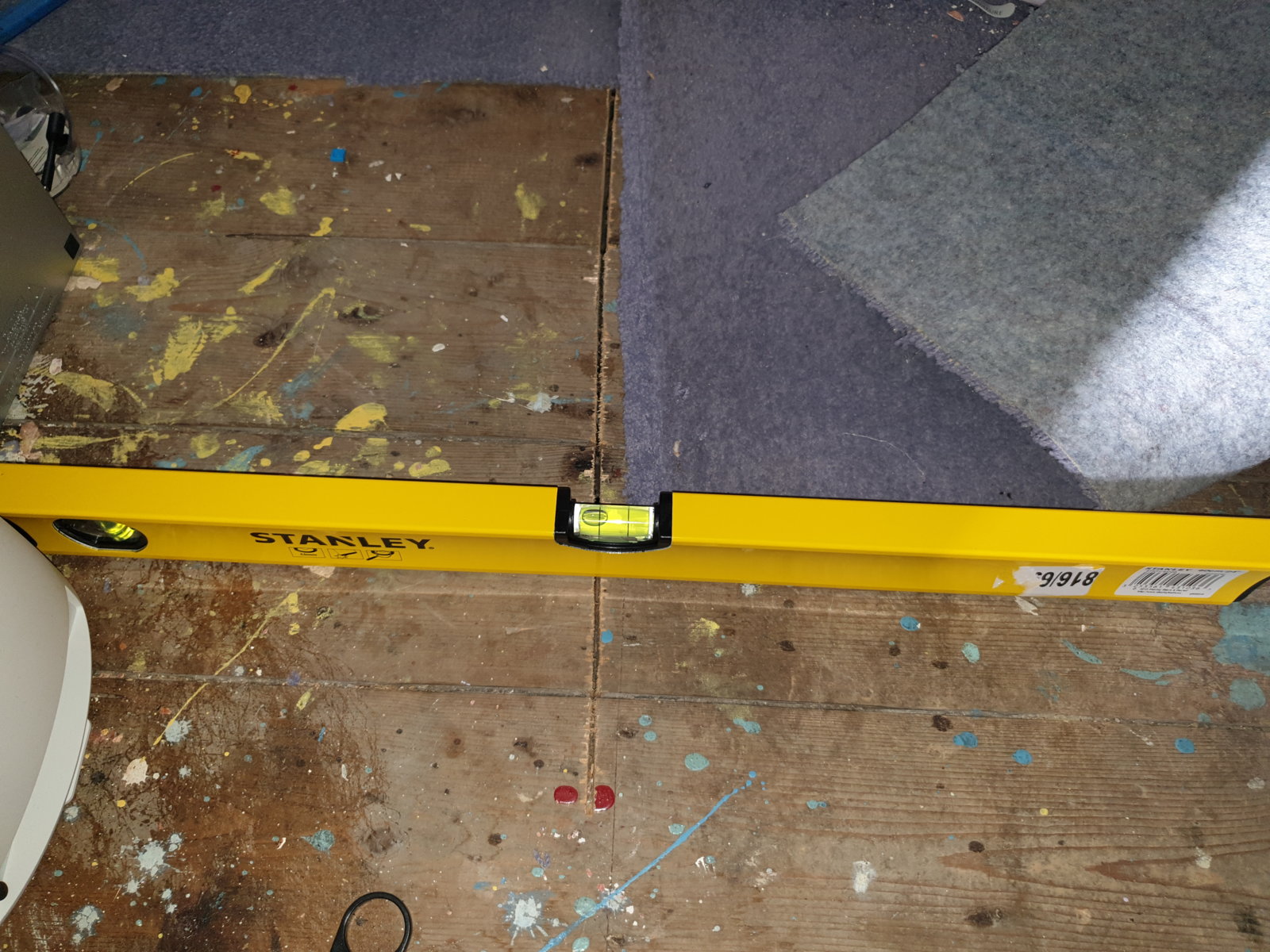

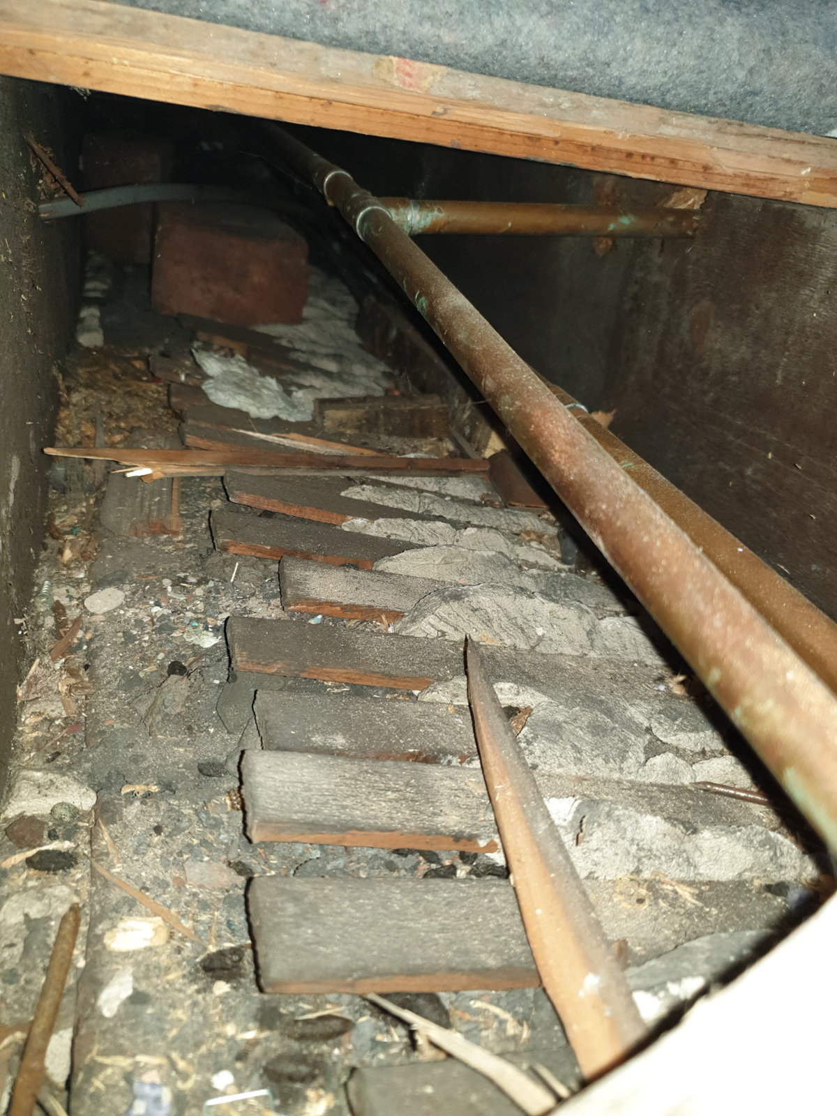

Here are a few photos of the floor (excuse the mess!)
MJ

Well you've def got some out of level issues there. How vertical are the walls?- if they have similar leans then be worried, if not then your house was built by a madman but is likely to be standing long after we're all gone.

Don't worry about stud walls, they're usually not structural. Get your plumb line or level out on the outside walls- inside and out and on any internal brick walls. If they're plastered, drill some test holes top and bottom, see how thick the plaster is.
As for sueing the surveyor, good luck with that. If the brick walls are massively out of vertical then maybe, apart from that uneven floors aren't a structural problem if they're solid and rot free.
Look at the structure - widish floor boards, lath and plaster ceilings, etc That makes the house Victorian or Edwardian in all probability (AFAIK they stopped using lath and plaster on domestics somewhere in the late 1920s/early 1930s), so there could be an amount of settlement in the building. TBH I've never worked on a building of that age where the floors were level or the walls plumb. Just done some work in an old mill office this week - the walls ran out of plumb by about 30mm over 8ft and the floors were equally bad (drooped 25 to 30mm towards the middle of the 6.5 metre wide room - enough to be able to sense it when walking across the room). Built 1860 to 1870 as far as I could ascertain. Unfortunately checking a floor with a 2ft level isn't conclusive proof of anything, I'm afraid, as even a protruding nail head can push your level reading out by a mile as can a low/high spot or a single low joist - it needs to be checked with a 6ft level (or even a 2ft level strapped onto a straight piece of planed 3 x 2in softwood) or better yet a laser level and a marking block as only that will indicate bowing or inclination of the floors properly. I agree it's out, but the question in my mind is whether or not it's just a low/high area and the rest is OK-ish. Victorian floors are rarely level in my experience
