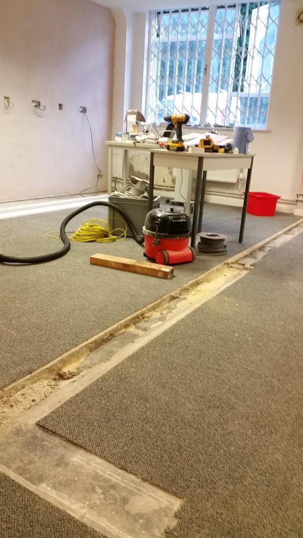

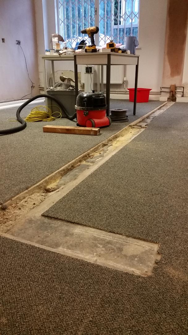

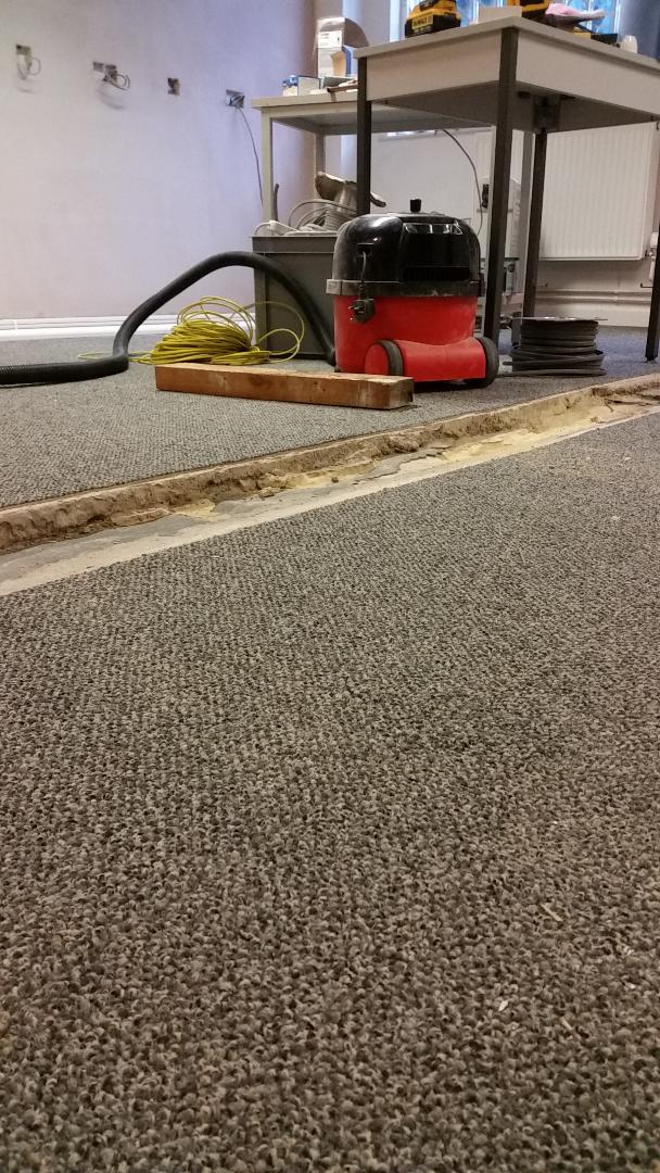

Dear all,
We are currently working in the room of the picture and there use to be a dividing wall where you can see the groove. The ground is higher in one side and quite uneven. The idea is to create a single ground floor as even as possible.
One alternative is self leveling compound but we are not too keen on this idea as it will not level 100% and we will need lots. Anyone can suggest a good alternative?
Many thanks

Thanks, the difference in level is too large to do that. I would say it may be 2 to 3 centimetres in some parts
Do you mean the floor or just the recess?
If the floor, they are no practical options other than self leveller. For the recess, use cement screed.

There is only one door, the room will be used as a classroom with some individual desks and chairs situated parallel to the groove. The lowest area is the one near the door and as you say it may be a problem if using self leveling compound
only thing I can suggest is if the high part is the smaller of the two, somehow remove about 3-4 cm from that. Then use concrete or leveller to bring it back to the level of the lower floor.
It would be pretty messy to do but dust can be controlled with framing and polythene sheeting.
Tool wise, if there isn't a tool for this, something like a cable chaser used horizontally? Then an SDS drill to remove the middle bit.
Then a screed. Play your cards right and you could chase it accurately
Some of the leveling compounds can be bulked out with sharp sand to make them go further.
Sand and cement screed in the trough and then lay some ply of the correct thickness on the lower floor
