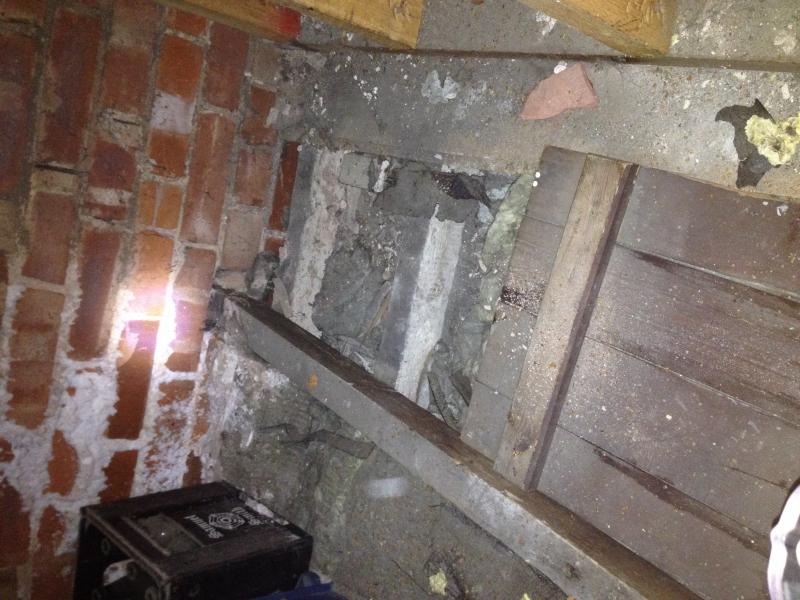

After a bit of advice. Not sure if this is the right section or not
I am building some cupboard starage into a already converted attic room
Everything is fine and sorted but there seems to be an unexplainable 3x2 sat across the roof joists at an angle which will make boarding the floor nearly impossible whiltlst it is still there
Is seems to be going into the brick at one side an just laying across the top of the joists
It isn't fixed to any of the joists apart from being fixed into a pocket in one brick wall
It's a mid terrace house
Any help on what this may be?
It doesn't seem to be doing anything and the angle it is layed across the joists just doesn't make sense

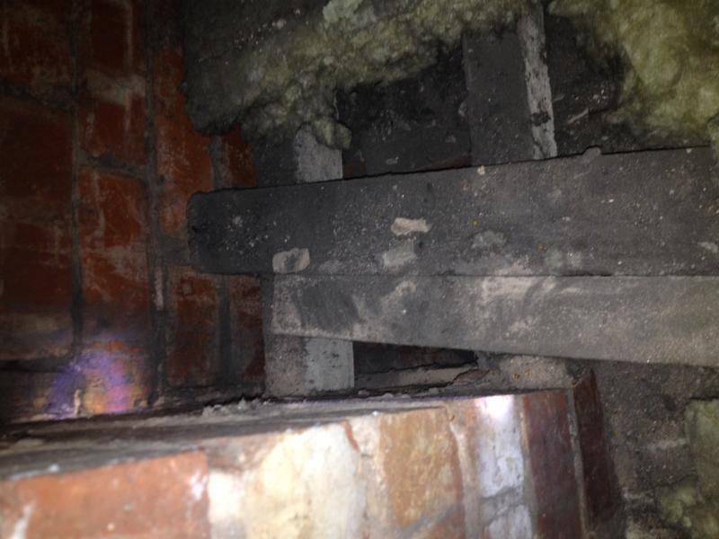

Iv just checked it seems to be nailed to the joists but only secured to the brickwork at one end
Does that mean it can't/shouldn't be removed?

I've managed to get a couple of pics
This is where it's into the brickwork
This one is the other end there is a brick supporting wall to the right also
As mentioned they are nailed to the joists
I cannot see it providing any structural support as it is at the minute
It may not be providing vertical support, but it will be helping to distribute any applied load between the joists. For example, if you tread on one ceiling joist, the 3x2 will help to distribute some of your weight to the joists either side, so reducing the stress and deflection.
If you took it away, all your weight would just be on the one joist.

Would it be feasible to replace what's there with another that sits straight? Thus making it easier to box over?
Also is there any reason logically speaking why there isn't another one at all bearing in mind that's right next to a load bearing wall that the joist sits on?
put your flooring down and when you get to it take it out as your new floor will be doing the same thing.
