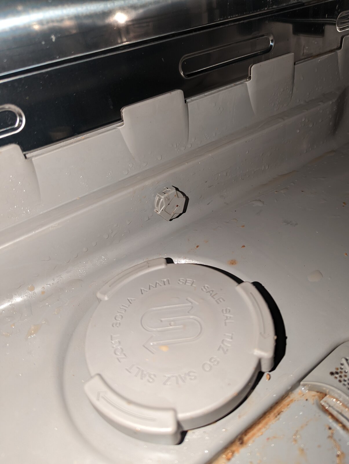

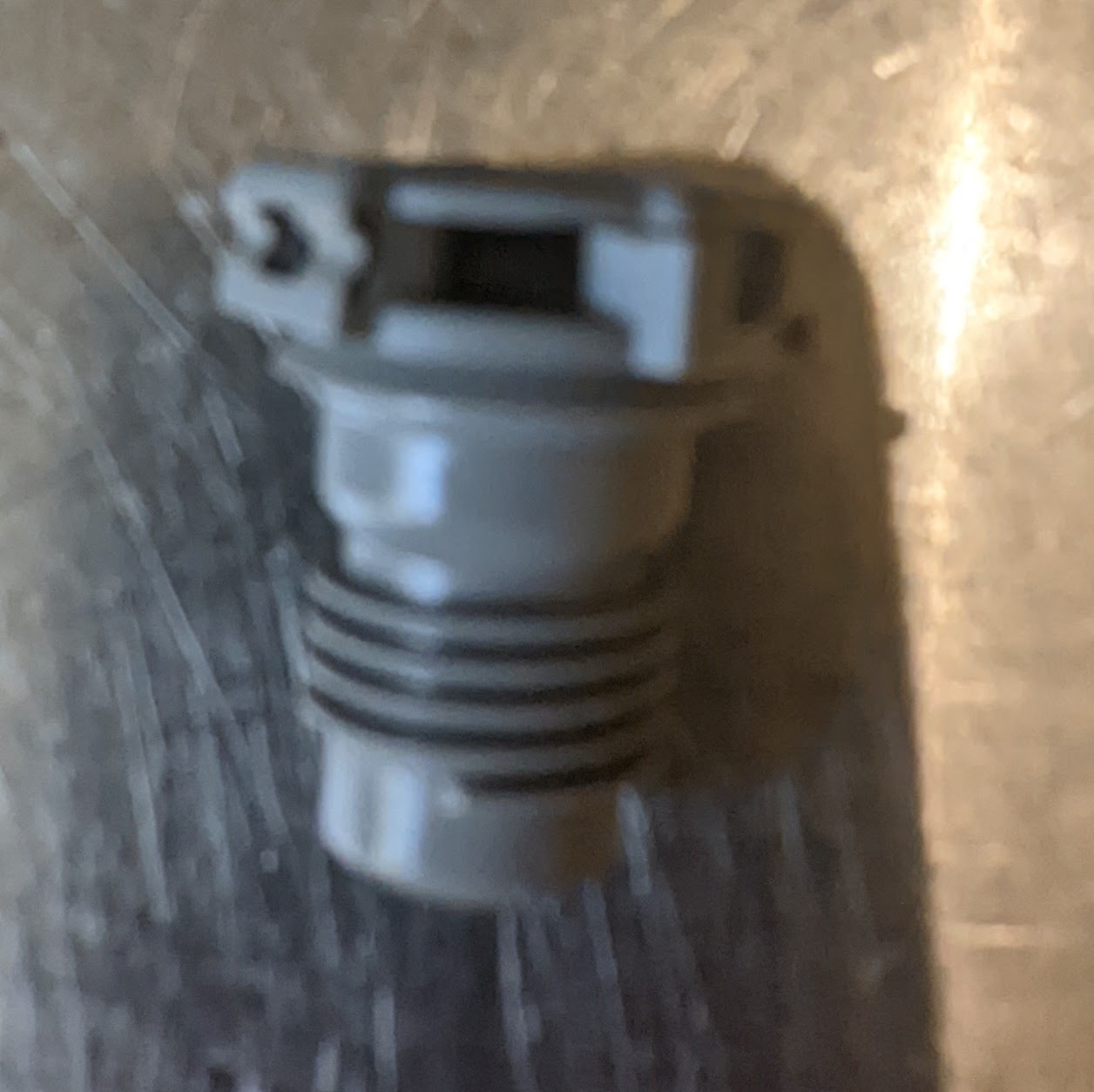

I found this the other day but foolishly ignored it as the dishwasher was still working. Until today. I'm now getting an E15 error so I'm assuming that this is something to do with the water inlet leaking and filling up the water trap. The matching part on the Bosch site says it's called "Thread bolt for free inlet with gasket" but I have no idea where to stick it. Any clean suggestions welcome :)
I found where it went. For the benefit of anyone else googling "Thread bolt for free inlet with gasket", it goes here....
It seems to screw into a hole - any holes inside?
Take the baskets out and look in the back.
