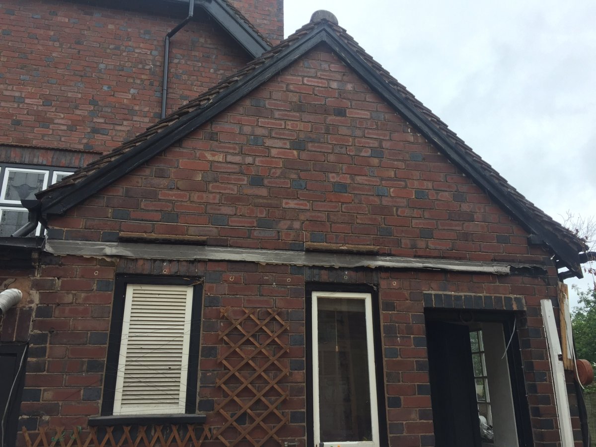

Have had the foundation trenches passed for my side kitchen extension by building control and have poured my concrete thus now considering myself a professional builder! All good. I intend to reuse the bricks from my exterior kitchen wall to build below DPC so they match the rest of the house (75mm imperials) as I am finding it very hard to find something similar. Above is to be rendered block. Anyhow, this means the removal of the kitchen wall and insertion of steel beams.

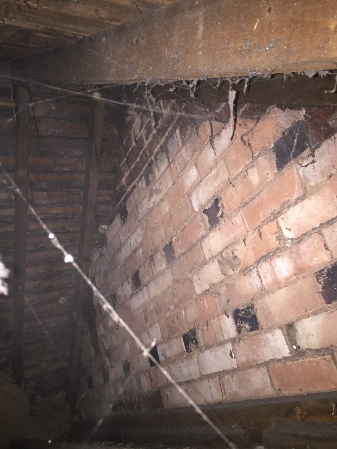

The opening span is 357cm so with a 10cm bearing on either side would require a 377cm beam/s. All they are to hold up is the gable end of the current single story kitchen. The outer skin obviously goes full height, but the inner skin only goes up halfway (pic). The new warm flat roof will cover the outer beam. My BCO officer suggested 2 x 6x4" beams bolted together to support both inner and outer skin of my 9" solid wall, then suggested 7" beams might be better. He agreed SE calcs are unnecessary for this support. Cost for beams is £200 - not bad.

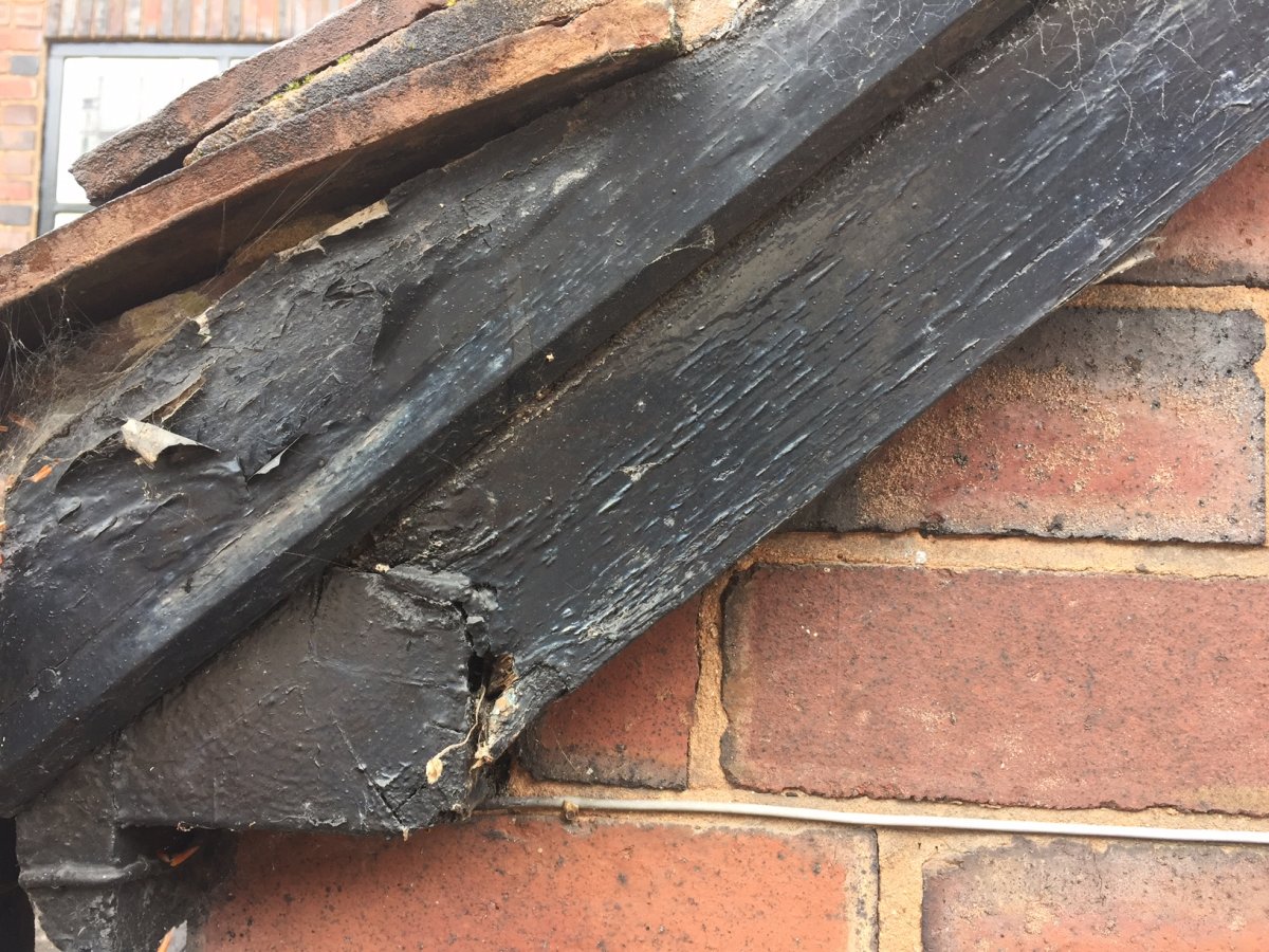

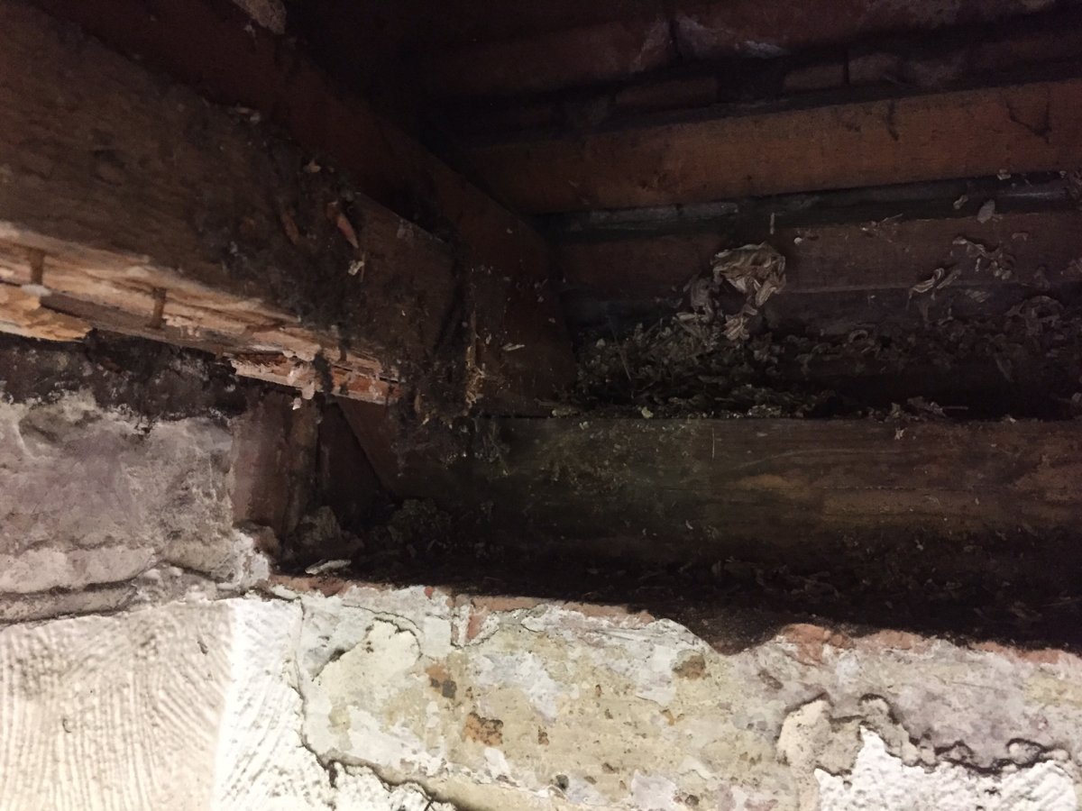

Having bashed an exploratory hole in the old kitchen ceiling, I have come to the conclusion that to maintain the 9' roof height between old kitchen and the soon to be started new part of the kitchen, the steel beams need to sit level with the top of the wall plate on the old kitchen roof to avoid being on display in the ceiling. This presents a problem as even if I were to go for the smaller 6" beams, the top would hit the laths of the old kitchen ceiling.

Some of the top portion of the beam can be cut off or chamfered to coincide with the roof slope. The amount you can remove will be quite specific.

Thanks for the info on being able to chamfer the beams. The other fallback I have is to fit the unchamfered beams as high as they can go leaving approx 3" below the ceiling, then just lower that by battoning the current joists. Just adjust my extension ceiling accordingly. Keen to exhaust the no loss of height options first.

Now this is where I'll probably get flamed, but it's not as though I'm opening up the entire span of a 2 storey property..... The beams will support nothing but the pyramid of bricks above. 2 6x4" beams seems overkill to me anyway.
Gables are more susceptible to down force loading than a full width panel of brickwork.
I can see that - full panels of brick have the "sides" to help hold them up, whereas my gable's sides disappear the higher you go..... What's the worst that could happen?!!!
