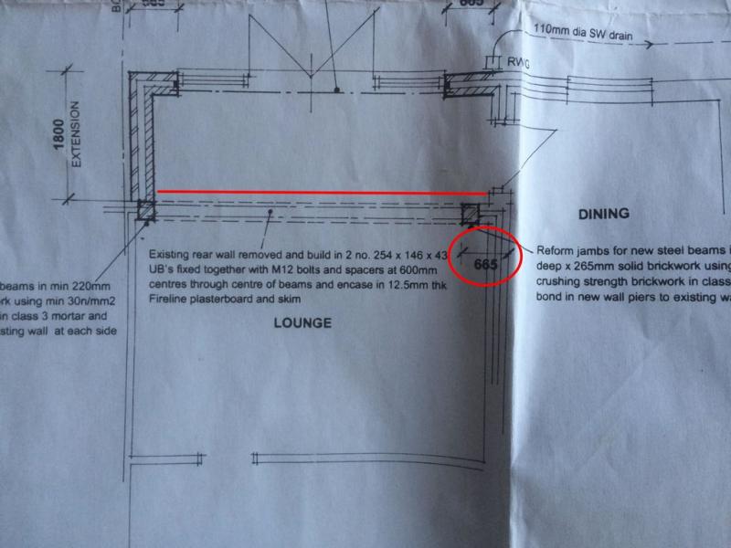

It does say on the plans and in the beam calcs paperwork that the beams must have a minimum 150mm seating onto the padstones at each side.
I've had an extension built at the back of my house which when the original wall is removed will make the living room bigger. The beams are supporting the first floor load and roof above that.
The red line shown on the image above is 4.75m. The pillar on the right side of the opening is stated as 665mm. Does this pillar have to be that big considering the beam only sits on 150mm? There will be a door on the other side of it going into the dining room, I'm not keen on having such a large pillar in the "middle" of the room.
The span is not that great so the beams won't be carrying particularly high loads.
Personally, I would not have built a new pier on the rhs but simply used the existing cavity wall, perhaps with a 225 (ie one brick) projection (assuming the wall is in reasonable condition). The load is soon dissipated down and throughout the wall by the bonding action of the brickwork.
On the lhs, it's slightly more problematic as you've got the return on the new cavity wall to consider.
Now I'm no engineer but having drawn up plenty of these types of extensions my SE consistently seems to require a pier on the external wall and the internal one can be free of a pier, or at least a lessor one than the one the OP's arch has drawn. Odd .......

I do plan on using the existing cavity wall as the support for the UB. The bricks and blocks are in very good condition.
My query is on how wide this actually has to be?
I think the lhs won't be a problem as what the beam sits on will be behind the extension block work. Hopefully that'll make sense.

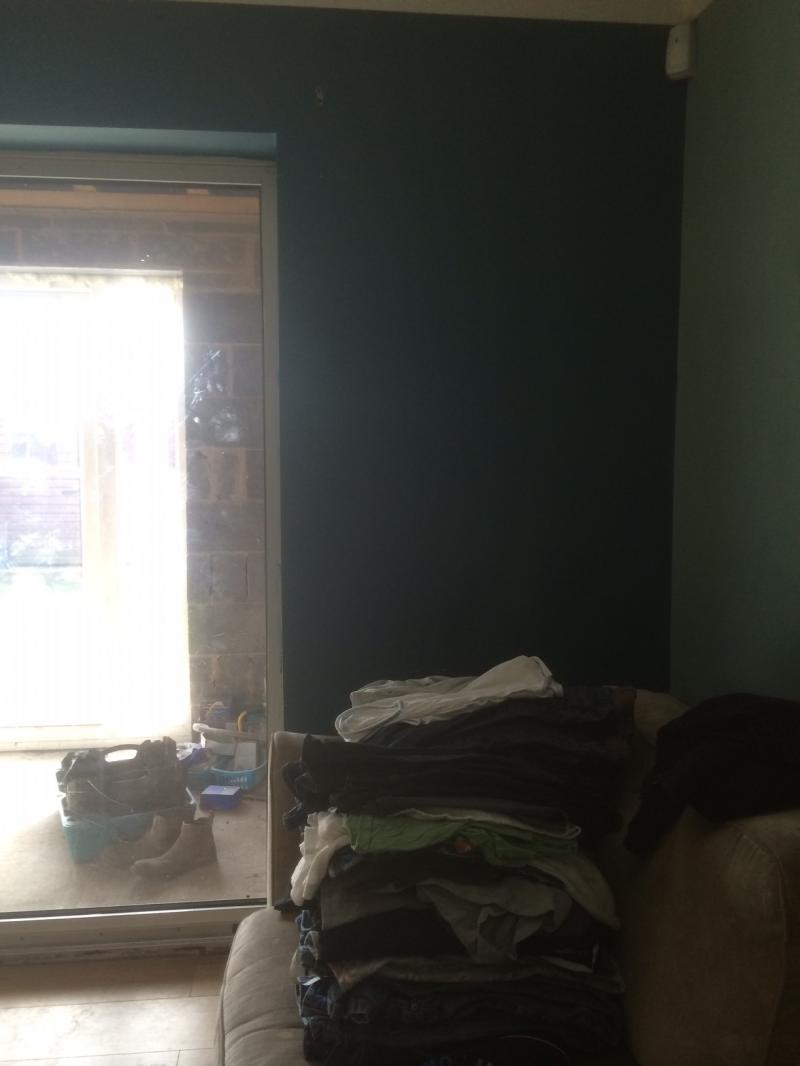

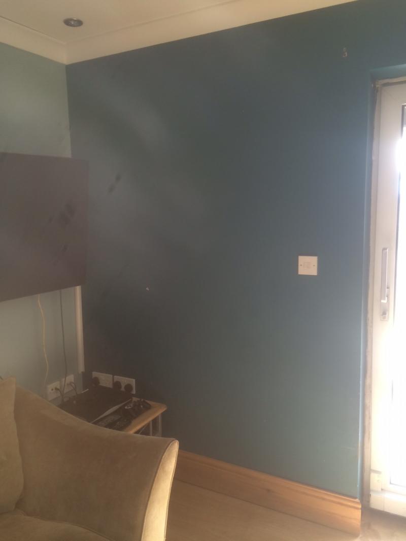

Some more photos showing the wall in question:
Left Hand Side:
Right Hand Side:
