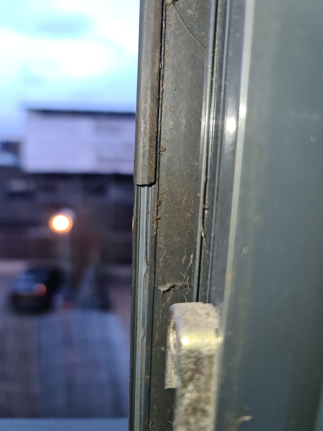

I've been asked to help a neighbour replace their window seals but I'm struggling finding the right gasket to replace the seals on the windows. I'm having 0 luck searching for them and also not really sure how to get them out.
It appears to be a solid piece of plastic that the rubber seal is mounted on and the solid plastic then fits into the groove around the window. They have corroded so much the rubber just peels off the hard plastic and leaves the plastic stuck in the groove. Any one here have any ideas? I've got a photo attached. (the lighter grey bit is the plastic that appears to be sat in the groove around the window, half the seal has disintegrated as you can see in the photo.

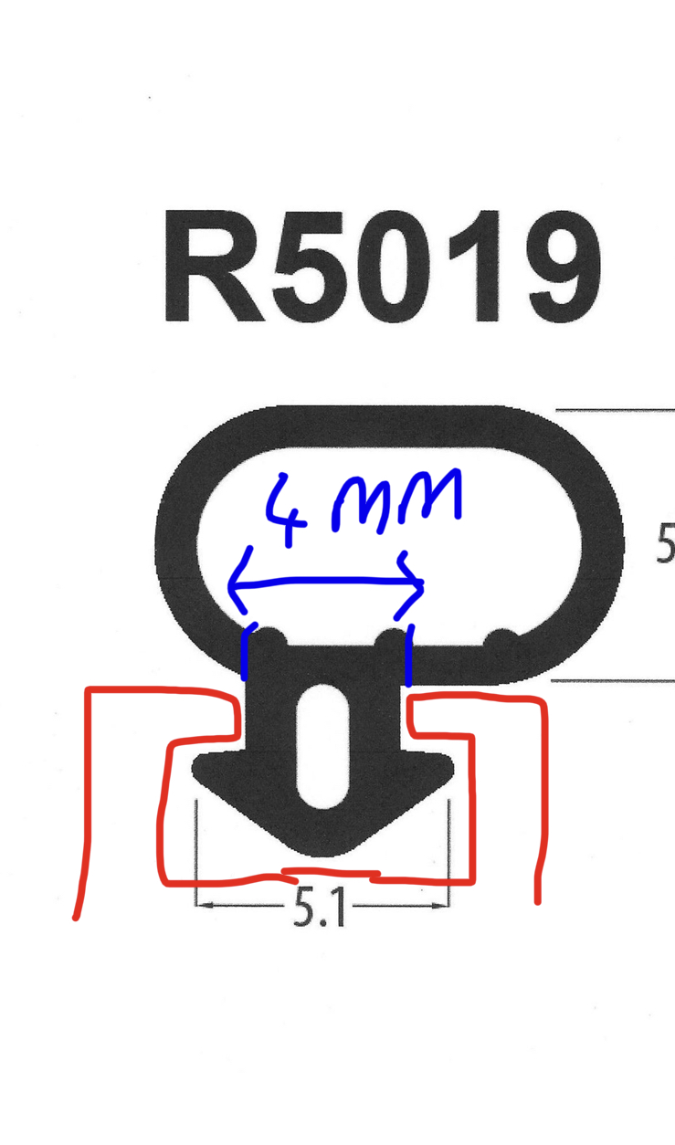

Take a look at the various dimensions on the different profiles of "bubble gasket":
All you need is one that will hold itself in place; you clear the plastic strip out of the groove, and discard any old gasket, then press a new one in (squirting with soapy water can help)
Measure the window up and choose one that will fit the groove. For example if your window has a 3 to 4mm slot that gets a bit wider inside, then an R509 gasket should fit:
Don't get this gasket if the slot in the window is more than 5mm wide because it will fall out.. Pick a wider gasket

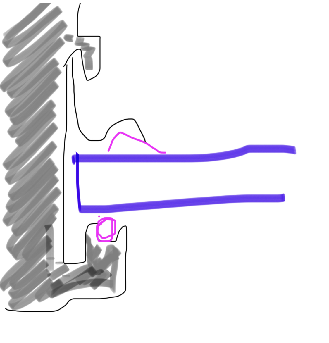

Be prepared to use a bit of engineering ingenuity if you can't get an exact fit. For example I recently had some roof windows that needed new gasket and I couldn't find a suitable one; a 3mm channel carries the window and an L shape with a bump in it pressed it down:
I ended up ripping an R6809X gasket into two strips, separating the L shaped bit from the arrow shaped bottom bit, the L bit being inverted for use under the clamp strip and the the arrow part squeezing into the 3mm channel. It worked well; don't be afraid to modify the gasket to suit your need

Fair play and impressive! - don't suppose you have any tips on how to get the plastic runners out? there's very little space to even get something sharp in?

From what I recall of my roof windows, they slide in so you should find they slide out again if you can get it make a suitable opening; the corners of the frame are probably welded at this seam/groove, trapping the seal in. I'd look to use a chisel and remove a small part of the groove
Another thought; see if you can run a Stanley knife down it using the groove as a guide and cut the plastic strip in two, making it easier to pick sideways and pull out through the groove
Can you take a pic of the corner?

Sorry didn’t come back to you, Stanley knife cutting it up worked but it was a bastard and time consuming, got a rubber seal that worked, however then discovered the windows had been damaged as someone had drilled holes and mounted blinds directly into the aluminium frames and damaged the opening mechanisms too, so in the end she decided to replace the windows!
